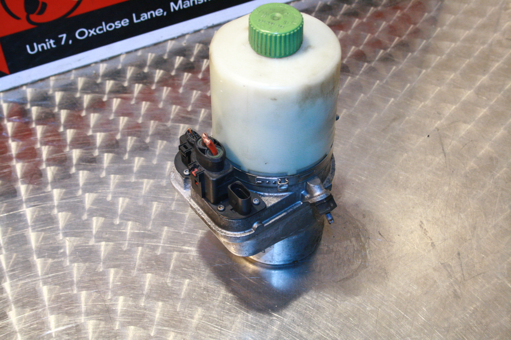

Hi, This morning my car was working completely fine i did 2 trips at around 8-9am. It comes to 2pm and i turn my car on to find that the powersteering light is on, i dont have any power assisted steering and its very heavy. i have cheched the fuse box in the dashboard and all seem to be fine. I have also topped the fluid up as it previously wasnt registering on the dipstick. even after this the light is still on and still no PAS, ive also taken the negative off and left it for 10 mins with no luck. Has anyone ever experienced this or could guide me to the solution?
Thankyou so much for taking the time to read and any advice is appriciated
Power steering pump or battery.
The pump that the reservoir is located on? the one in the pic below?
Also what would the reason for it being the battery?? as my car starts alright ect. could it also possibly be the fuse box ontop of the battery??

The pump is below the reservoir.
Ive seen dozens of pumps failing here on this forum and others (I had two) and never saw that fuse failing, but you could easily do a continuity test to prove its ok.
The one that Ive read about failing is the one that is under the dahboard but only once(that fuse used to tell the pump to start when you start the car). Vut even in that case from what I remember the problem was the pump that was burning them.
The pump is a two in one unit.
Ps: Make sure you put G004000M2 fluid.
Edit: yes its the pic you posted.

Brill, what i might do is get a battery first as it would be the cheaper option and try that, if that dont work then i will get a PAS pump. Are they easy enough to replace or did you not do it yourself?? would you also get a new or used PAS pump?? thanks for all the info mate.

I got a new one and at a garage but if it was today I would buy the trw or second hand and do it myself.
Yes it needs coding if your car has ESP and its a new unit.
If it is second hand it depends on the coding the pump has originally.
Its not difficult but it would not be easy for begginers
I can help with the coding if you have the tool to change it.

If it is a different vehicle it would work if the car has the same ESP system but the strenght of the steering would be different from the original until you put the proper code.
At the delaer expect around 1000€ to 1100€
950€ is for the pump.
This were the prices here in Portugal 3.5 years ago when I had problems with mine.
The code is composed by the strenght od the steering(11/21/31/41/51) and ESP system(
(01/12)
Mine is 10111
