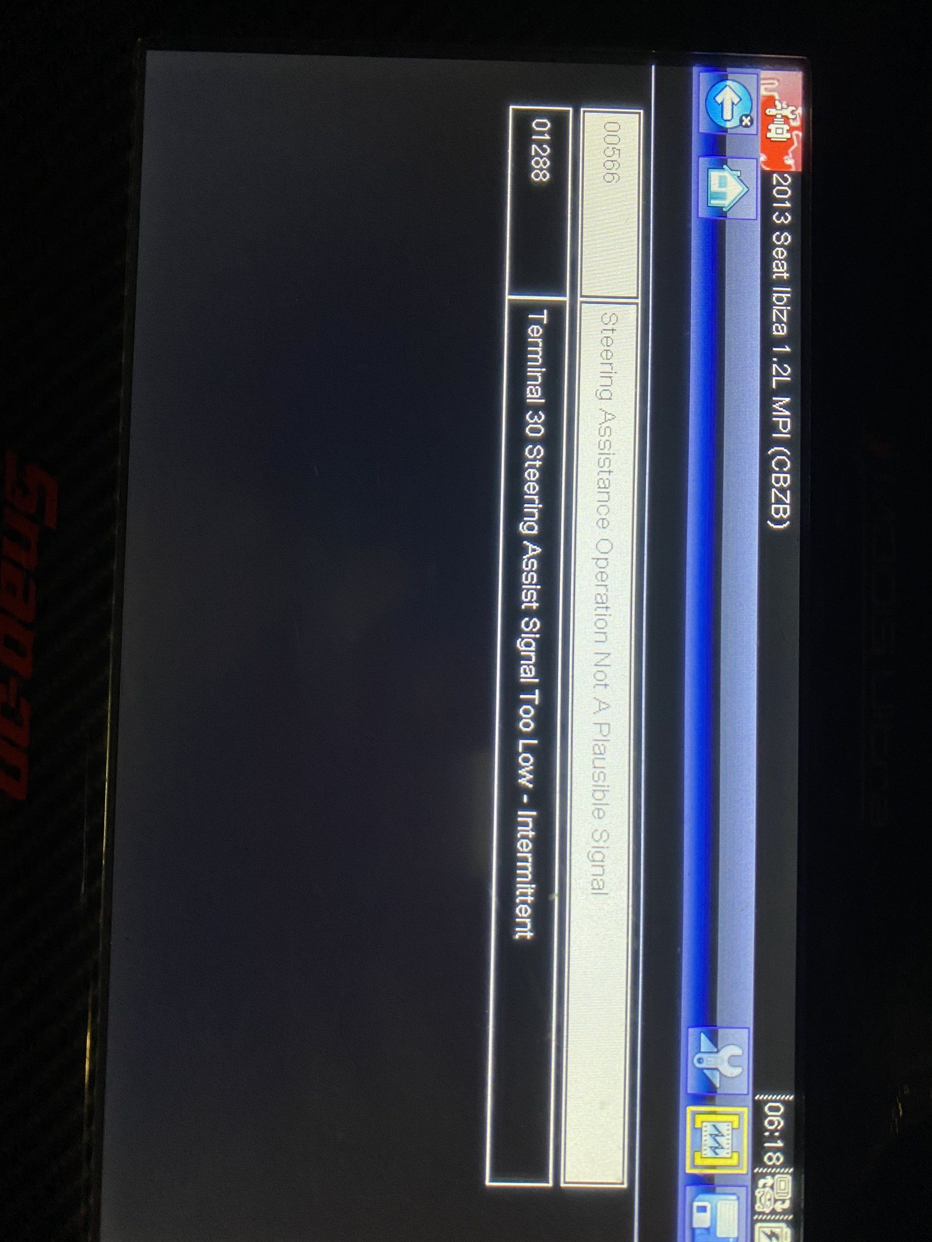

I have a seat Ibiza fr 2013 and have had a power steering problem since January 2020 it is an intermittent problem my power steering will come off and on I have had 4 pumps fitted and the wiring loom replaced still the same problem the codes I get are 00566 and 01288 I need help ASAP

Have you checked the battery and charging system as I seem to remember that terminal 30 is just the +12V - having any issues with the supply and its voltage would certainly stop of cut out the steering power assist to let the car keep running safely on reduced electrical supply.?

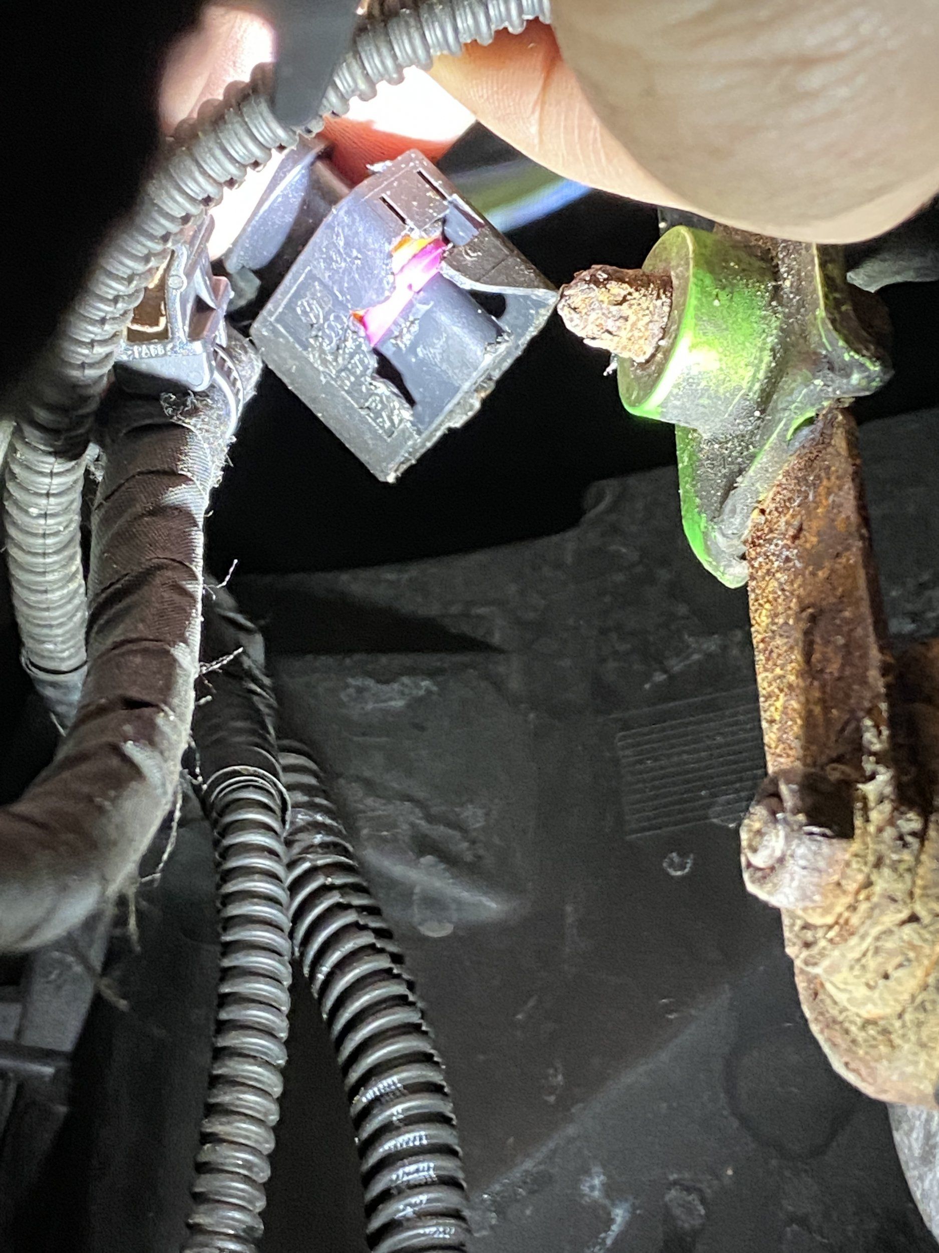

It has been done by a vag workshop but I have some experience with cars so I took it upon my self yesterday to check it out my self and I found this also a scuttle drain had been sat on top of the pump
Has that broken connector back shell meant that that connector is not now staying fully latched onto its connector on the pump assembly, if so water could have got in and be causing a high resistance connection.
I suppose that you could clean the male and female contacts and apply some silicon grease around the seal area and make up a retaining system using lots of cable ties. If you can find out the part number, you could order in a new connector from any VW Group dealership, then swop the contacts across to the new connector.

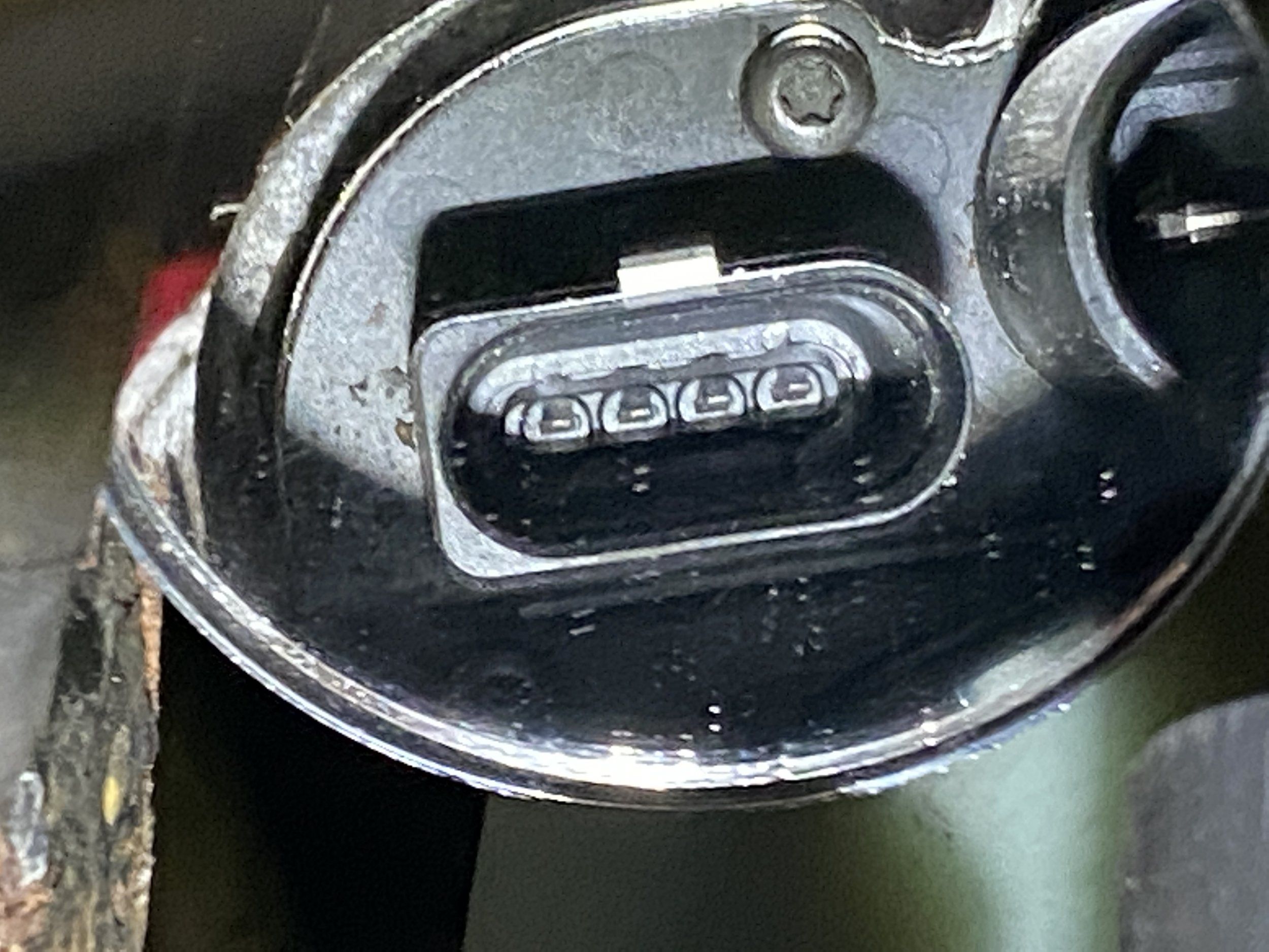

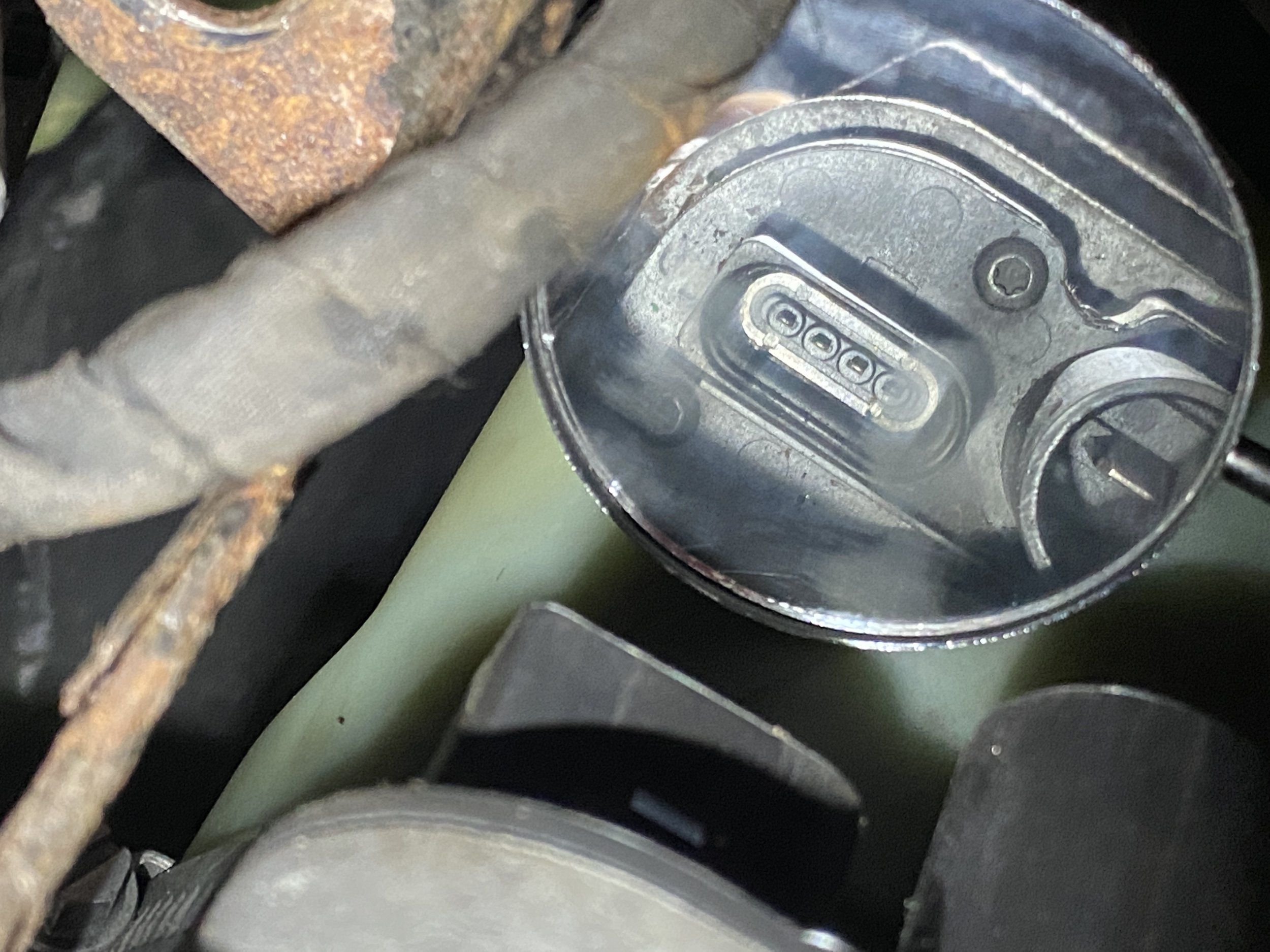

Instead the connections

If you are worried about the contacts being tarnished etc, just spray an electrical cleaner into the socket pins and work the mate plug in>out>in etc a few times then let them dry off and spray with WD40 to try to keep a barrier layer on them, as well as trying to boast the water proofing seal with silicon grease.
I'm guessing that it is the other side of the connector to the latching mechanism that has broken off, and so it is still locking into place okay, if so do as I suggest using some cable tries to hold it down square into its mating connector.
Is the bigger power connector still okay, ie not broken?
The bigger connector is okay but sat on top of the power steering pump was water drain for the scuttle pannel I think the pump maybe getting water damaged I have now moved the drain away from the pump but I think it has already damaged the pump
regarding the error codes, since you already replaced the pump so many times it is possible it is the connector indeed, was the car involved in an accident?
a lot of water gets in that area when you wash the car or it rains, it is better to replace the connector, or it is extremelly likelly it will happen again...
I had an accident years ago, pump burned a year after the accident, fitted a new pump and it lasted 2 months, I replaced the connector after the second time and also did other things, been fine for 5 years now. It was the middle one. although I'm not sure it was because of that, it remais the prime suspect...

As you can see that connector is broken and it is the one on the left of the pump
I think the broken connector may be the answer for all your problems.
be aware that this is not sealed... if water gets there through a broken connector it will flow into the electronics of the pump, which sit right below it
