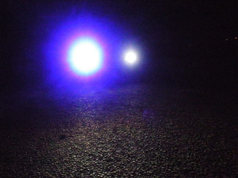

I am amazed at the output. Much more widespread than before.
Here's one on main beam:-
And here's a head on shot of the colour flicker at the top of the cut off:-
