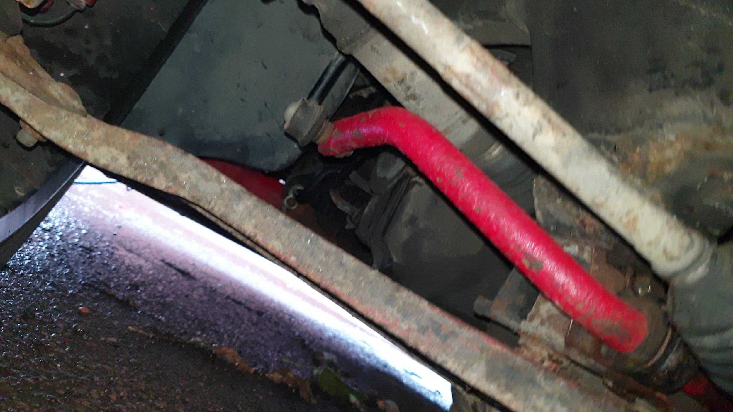

Hello,
Does anyone have any photos of an R32 anti Roll bar on a mk1 LCR? I have fitted one but am unsure if it is the correct way round or if I need longer drop links as it looks very close to the driveshaft? I have checked the raised bit in the center of the bar for where the dogbone mount is and this looks fine, the bar goes over the mount.
Any advice would be great!

looks to be the wrong way up it would have much more clearance fitted the other way. Easy mistake tho. The worst part is redoing the entire job mate. Wait till someone who’s owns a mk1 to confirm tho as I could be wrong.

Thanks for the reply, yeah was thinking the same, was hoping id be lucky and it would be the right way round so I wouldn't have to do it all again:rolleyes:
