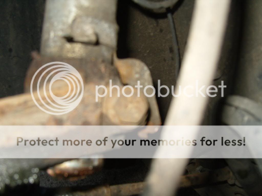

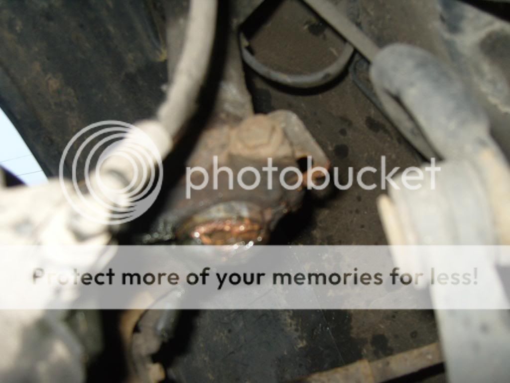

Whilst driving my fiance's car up to combe on sat, after breaking down and the coil having to be replaced... i noticed a grinding/vibration whilst turning, felt awful, went through the whole car. had a quick look underneath, couldnt see anything, other than a split cv boot, which must have been recent as i fitted the coilovers not less than 3 weeks ago.
Jack it up and removed the wheel to be faced with this:
Now this was the problematic strut whilst fitting, but it was done up VERY tight, buzz gun then breaker bar. yet its still been able to slip through, and hit the driveshaft. now this could have been very dangerous had it not been caught so early on.
Just a warning to you all, double check everything is as it should be. I shall be welding a new one on with out the gap at the bottom, so shall be a full circle to prevent this.

Nah the strut was actually pressing down the cv boot! Its split the long shaft too! yeah could have been very nasty, just thought i'd post up here to raise awareness!

It was passed through. I've got loads of experience with the ford and Renault fitment like this, never had a single problem. When i said problematic, I meant the top of the strt, notin to do with that. The tang has actually snapped off. And then slipped down the bolt causing it to bend outward into the position it is now. The tangs are made from thinner material than the STD shocks,which I did question about in my head when fitting. The bolt went through fine when fitting. Sorry for any spelling mistakes, I works faster than the iPhone can
