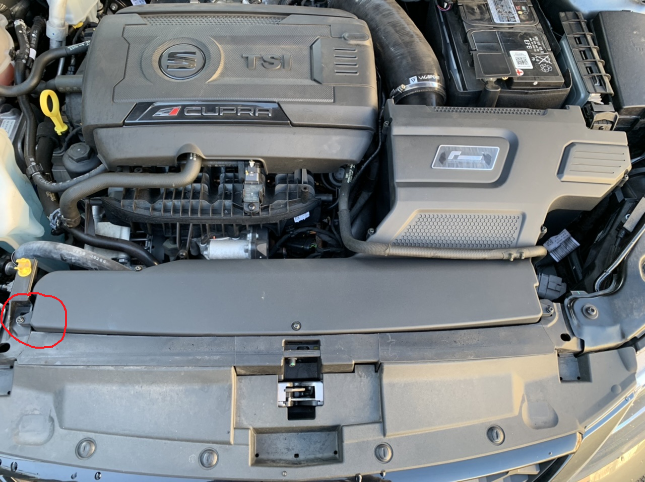

I took a pair of tin snips to mine and the full lip came off, actually looks far tidier than just sawing a little bit away.

Still remember doing the test fit of this down at Volkswagen Racing in 2014, literally took an axe saw to my plastic bits haha.
