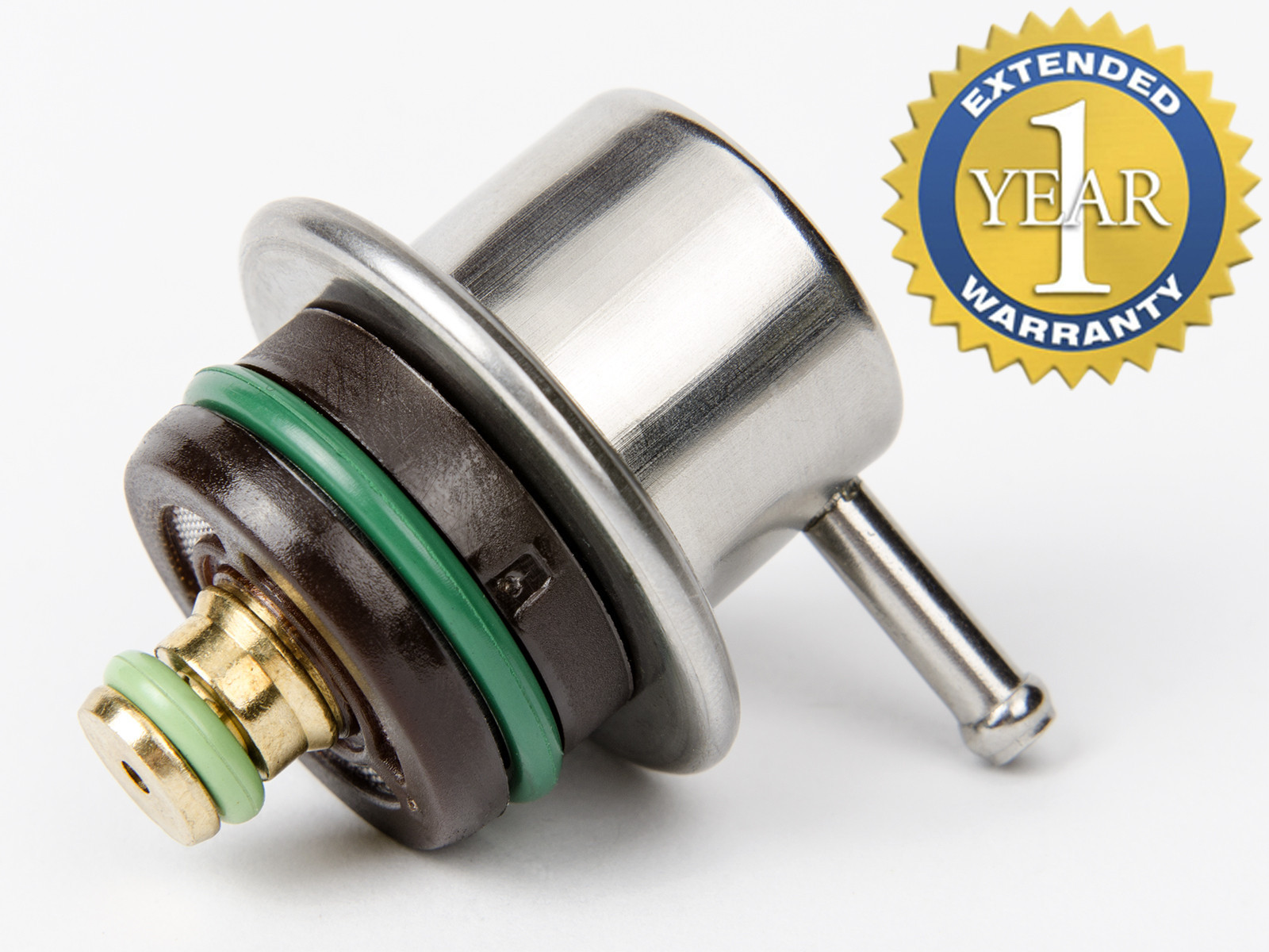

Fuel pressure regulator:

hybrid will want 550cc not 4bar fpr
3" downpipe and exhaust, 80mm TIP/Induction, FMIC, water meth, high flow exhaust manifold
Usual hybrid mods... which on a rodded motor should get you in the 330-350bhp range
Thank you Bill.
Any advice on meths? Necessary?
Where can I find 550cc fpr?
