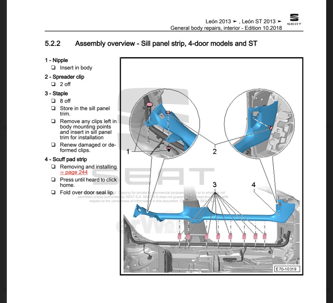

Workshop manuals are here:
Guide now located in the new
resources section of the site https://www.seatcupra.net/forums/
resources/leon-mk3-official-seat-workshop-manuals-link.24/
www.seatcupra.net
Look for one titled: General body repairs, interior. Then chapter 70 for sills, A pillar, B Pillar, C Pillar etc. It will describe the tool to use and location of clips:
