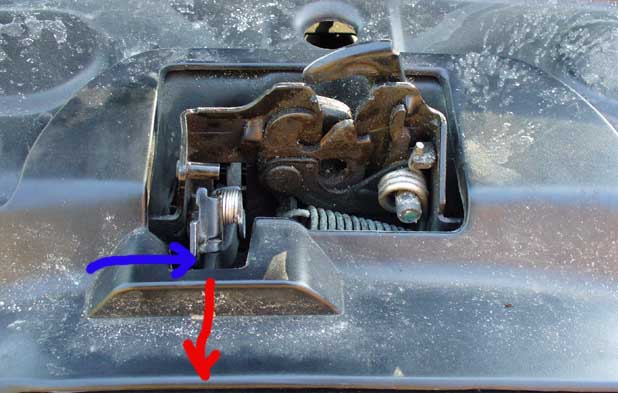

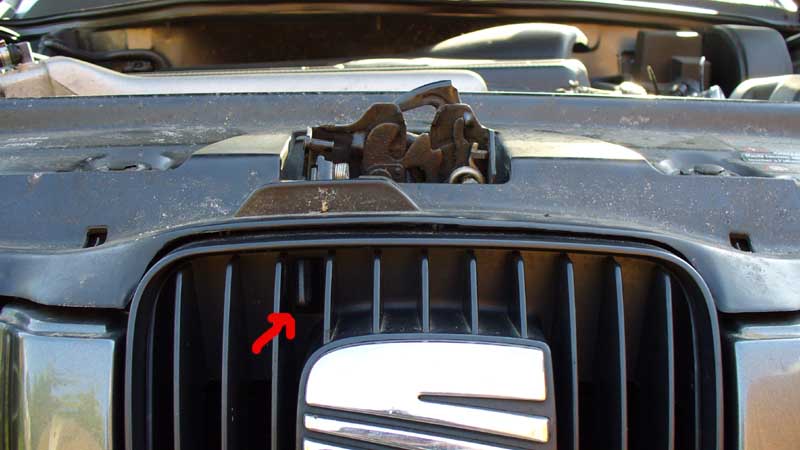

so is the little bit of plastic not protruding from the front grill / space?
you need to find the bit that this would be connected to, (left hand side near top of unit as you look at it from the front) and pull it towards you.

don't suppose you've got a pic have you?
dont pull the bonnet at same time as you pull back the bit indicated. Pull it back then left bonnet.
sounds like a good liberal spray of WD40 or the like may of use, many people reported their catches getting stuck.
pics below are of the rear of the mechanism so may not be much use..
having been out for another go it looks as though the bit you've said i need to move towards me, is stuck behind / below that pin wich is at the bottom left of your pic :(
i'll try and get a pic of what mine looks like, but i think my problem is that the bit which needs to move forward can't, as it's behind that round pin (which looks like it's meant to support the catch when not in use)
also, looking at your new pics, the first bit of the process works, as the large catch (the one at the back) releases
just can't seem to move the smaller one at the front :(
