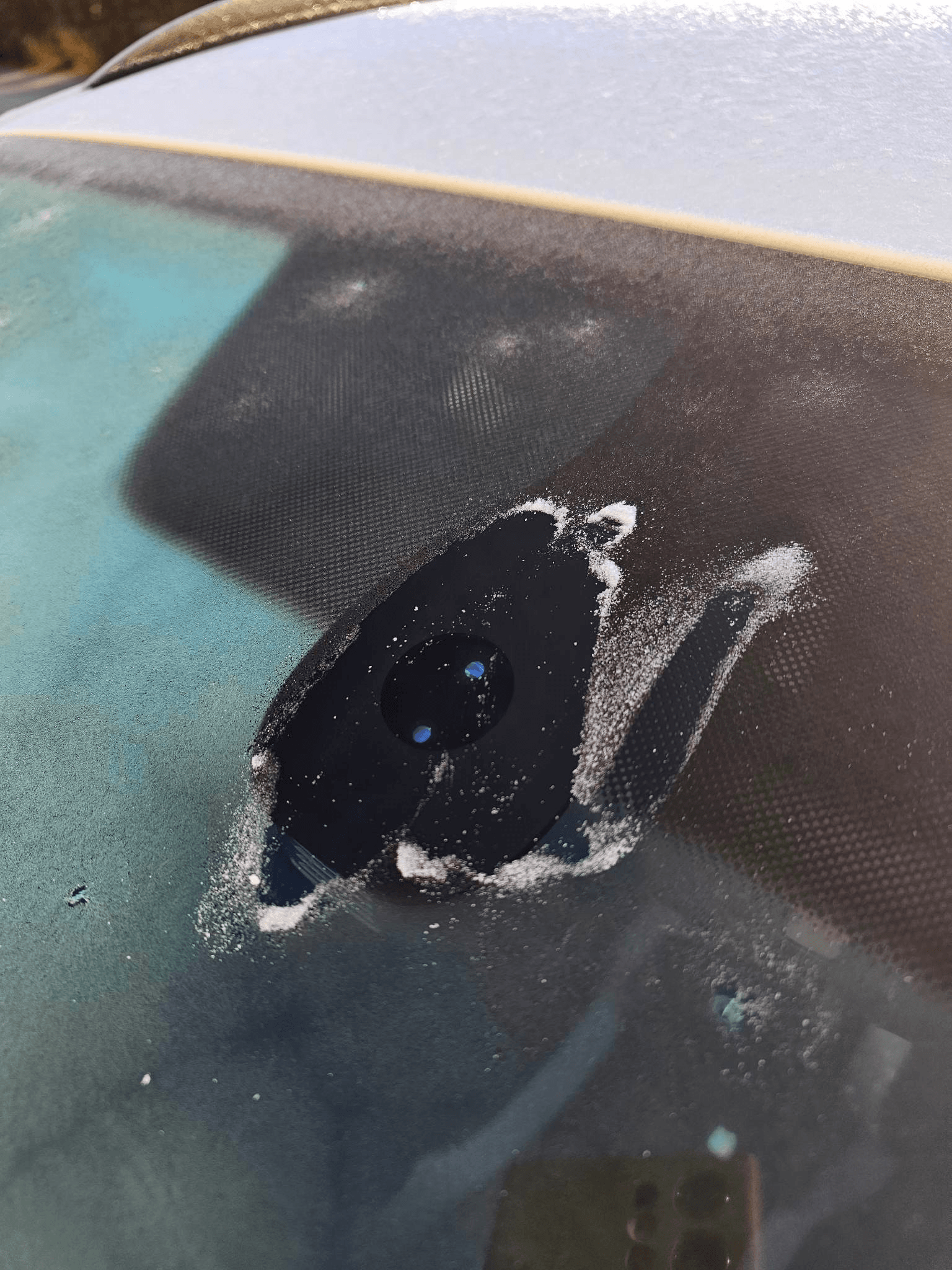

I can't find high-beam assist or lane assist so I don't think I have it. But I do have the radar for ACC and it looks like I have the cameras (see picture) in the rear view mirror. I don't know what they are used for on my car though. Is it possible to retrofit, lane and high-beam assist?

Those are rain & light sensors.
You need to install the camera and replace your windscreen with the one that has the clear upper area for camera.

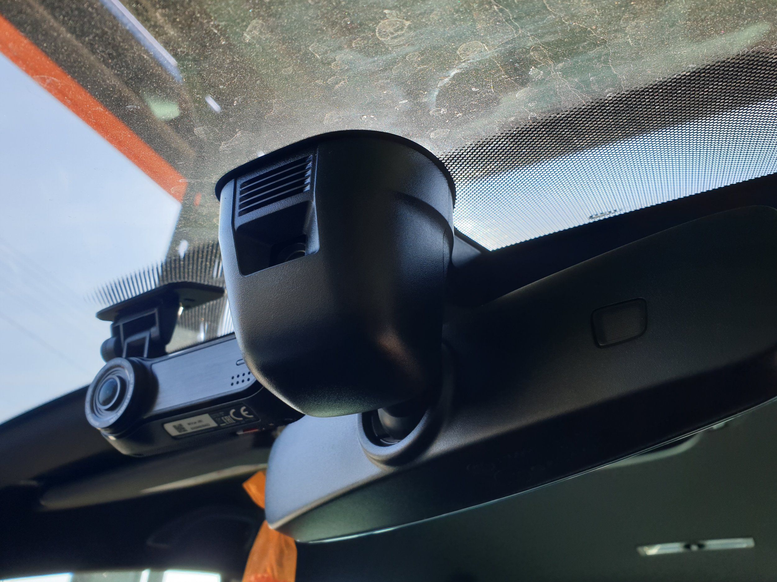

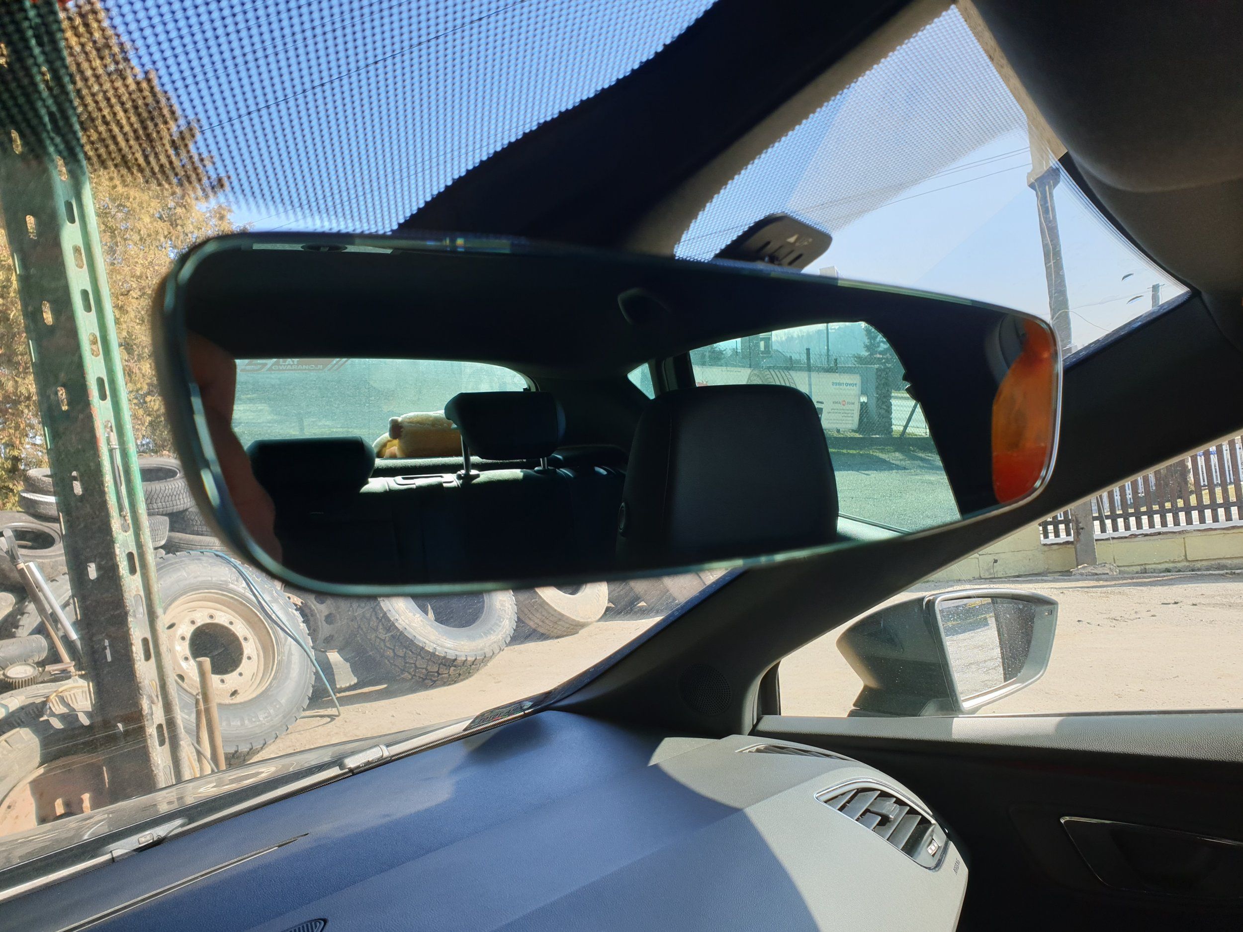

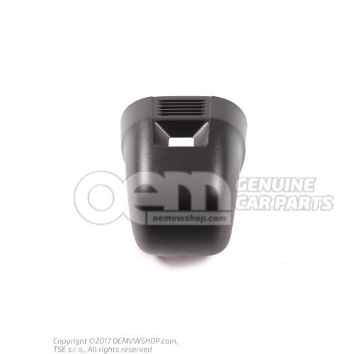

you can also change the mirror to one with a built-in camera of the high beam assistant from Golf VII > 3G0857511AE (frameless with assistant) cover no 3G0858548A
you only make a CAN cable for it, encode and it works
That looks really simple. Do I need new glass, and does it work like OEM?

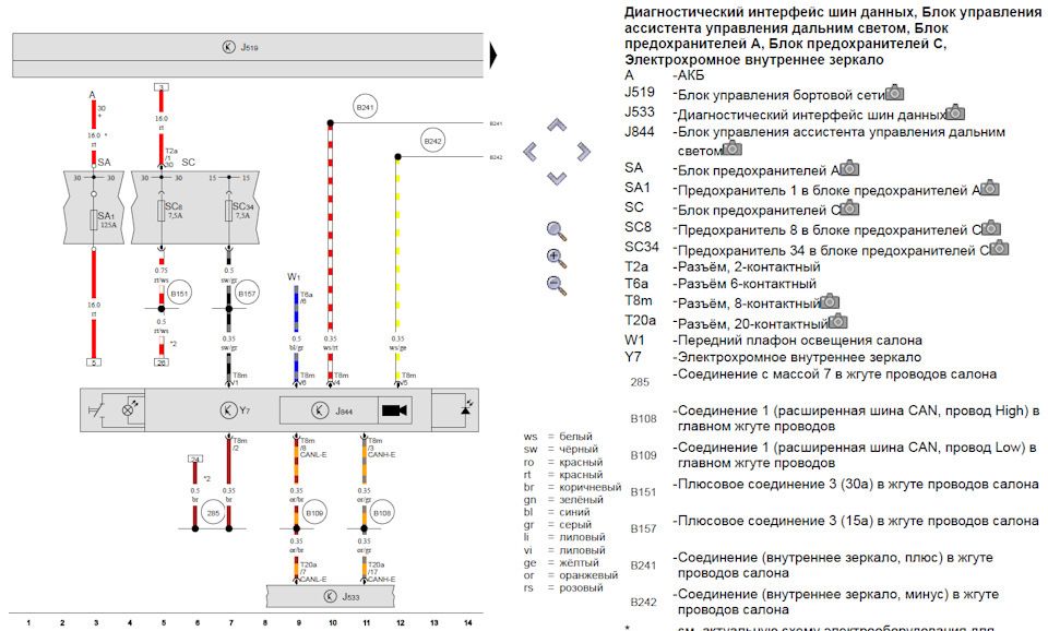

in total, replace the mirror, pull the reverse cable from pin 3 of the mirror and wrap it with insulation or put it in an empty unused place.

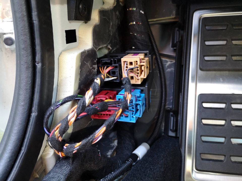

you need to make a cable to connect the mirror with CAN Extended and connect
pin 3 of the mirror to CAN H Ext pin 12 (orange with a gray stripe)
pin 8 of the mirror to CAN L Ext pin 13 (orange with a brown stripe) to the cube in the driver's doorstep (probably a black cube or white - you will find the colors of the CAN cables) and that's it for the cables.
later coding..

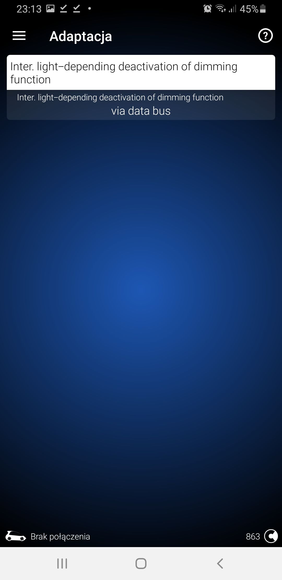

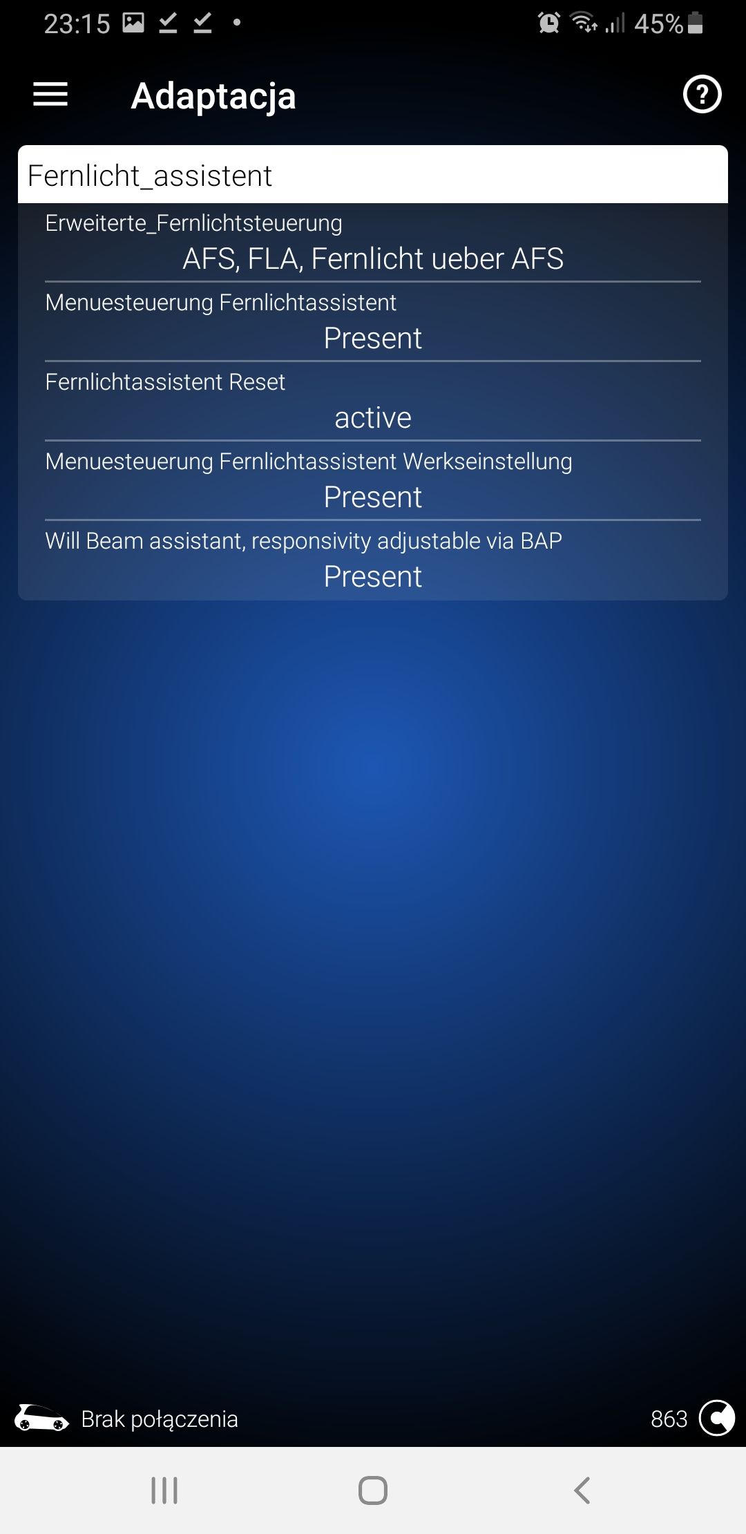

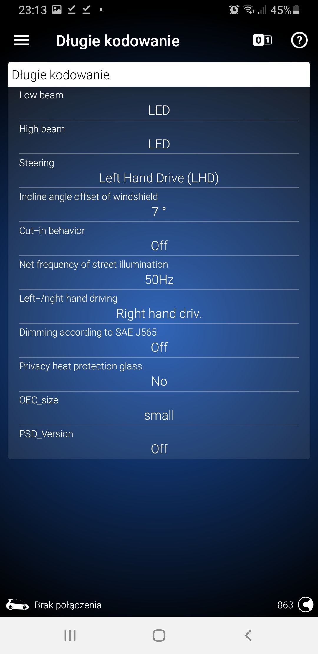

1. add the mirror (20) in the gateway installation list (19)
2. code the mirror controller (20)
3. code central electrics (09)

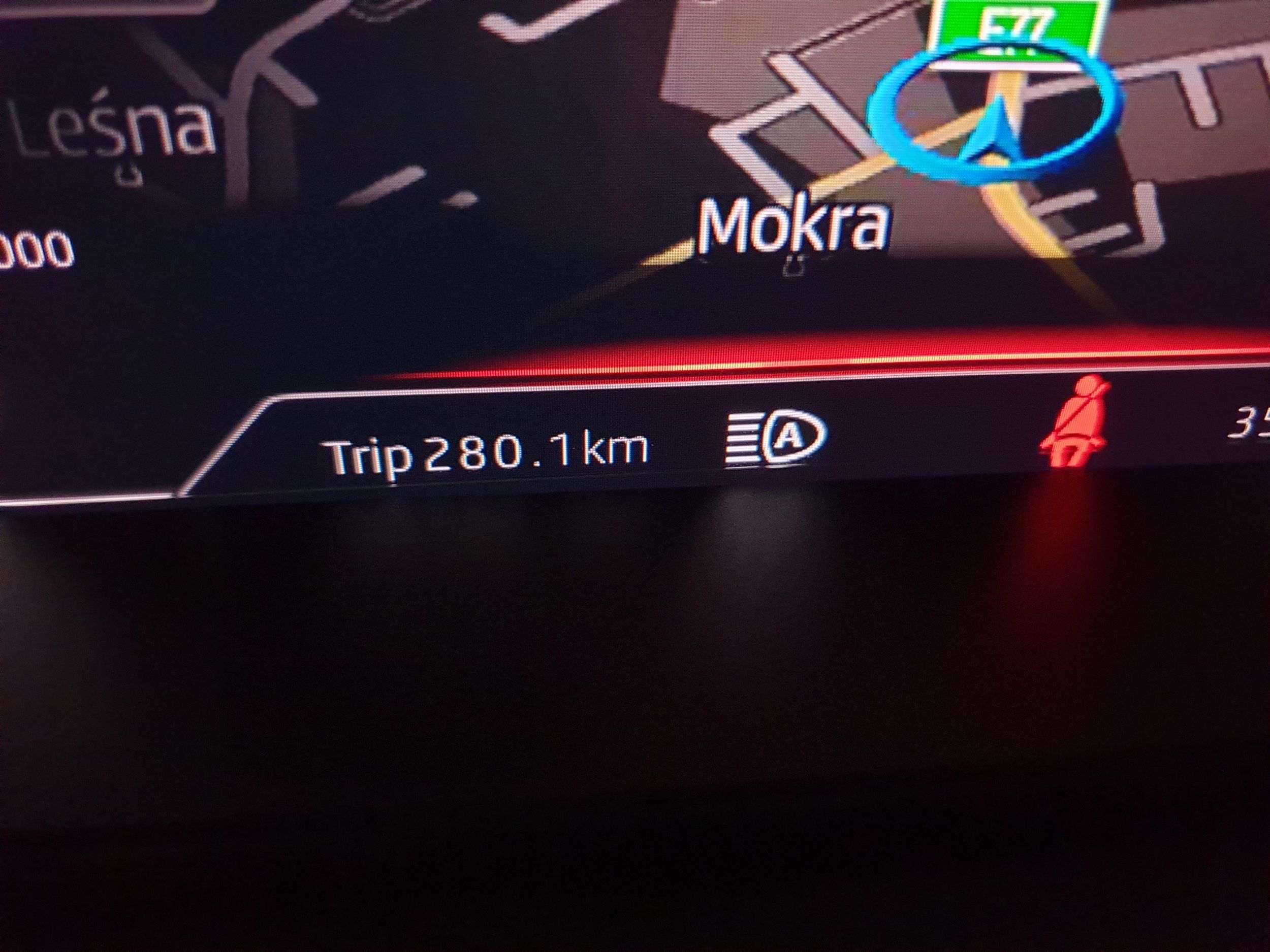

If everything is fine, you must press the indicator switch once as if you would like to turn on high beam and the High Beam icon with the letter "A" will appear

Mirror: 3g0857511ae
Cover: 3g0858548a

In doorstep solder to the CAN cables
