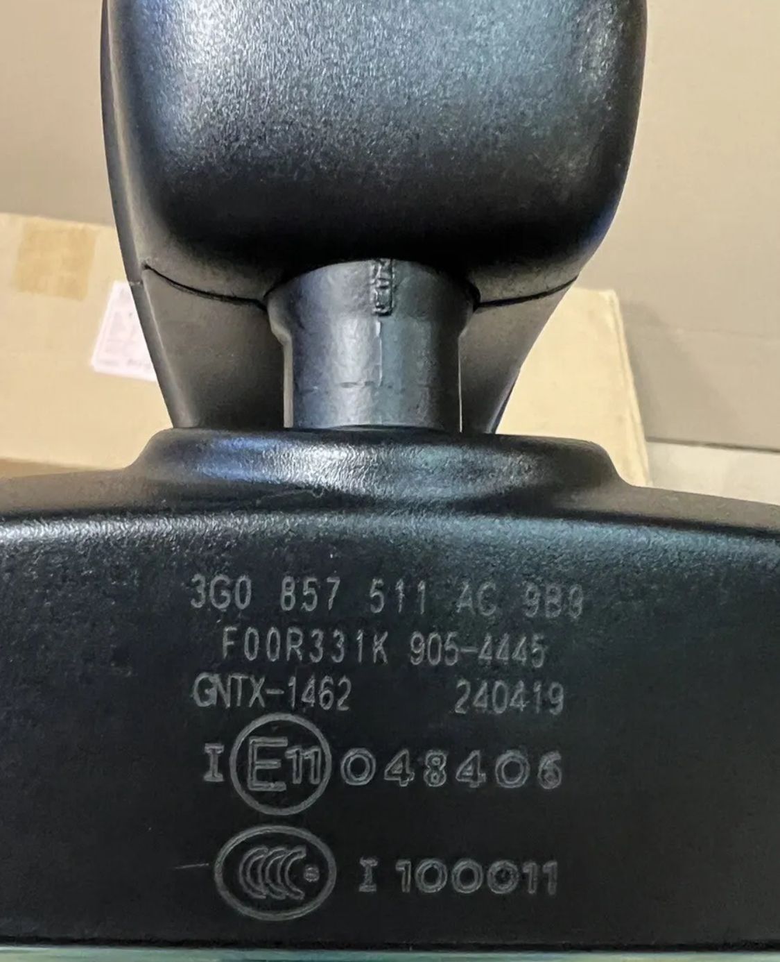

Does anyone know if mirror 3G0857511AC is also compatible with the Leon.
I see in this thread that mirror 3G0857511AE is mentioned.
wonder what is the difference ??
(i can get 3G0857511AC cheaper thats why i ask, but the listing states its a HBA mirror for a T6 van)

the AC mirror does not have a built-in HBA camera. it is simply a frameless mirror and is on the list with HBA because the car can have a camera on the windscreen (hba, lane assist, road sign assist) and an AC mirror mounted simply

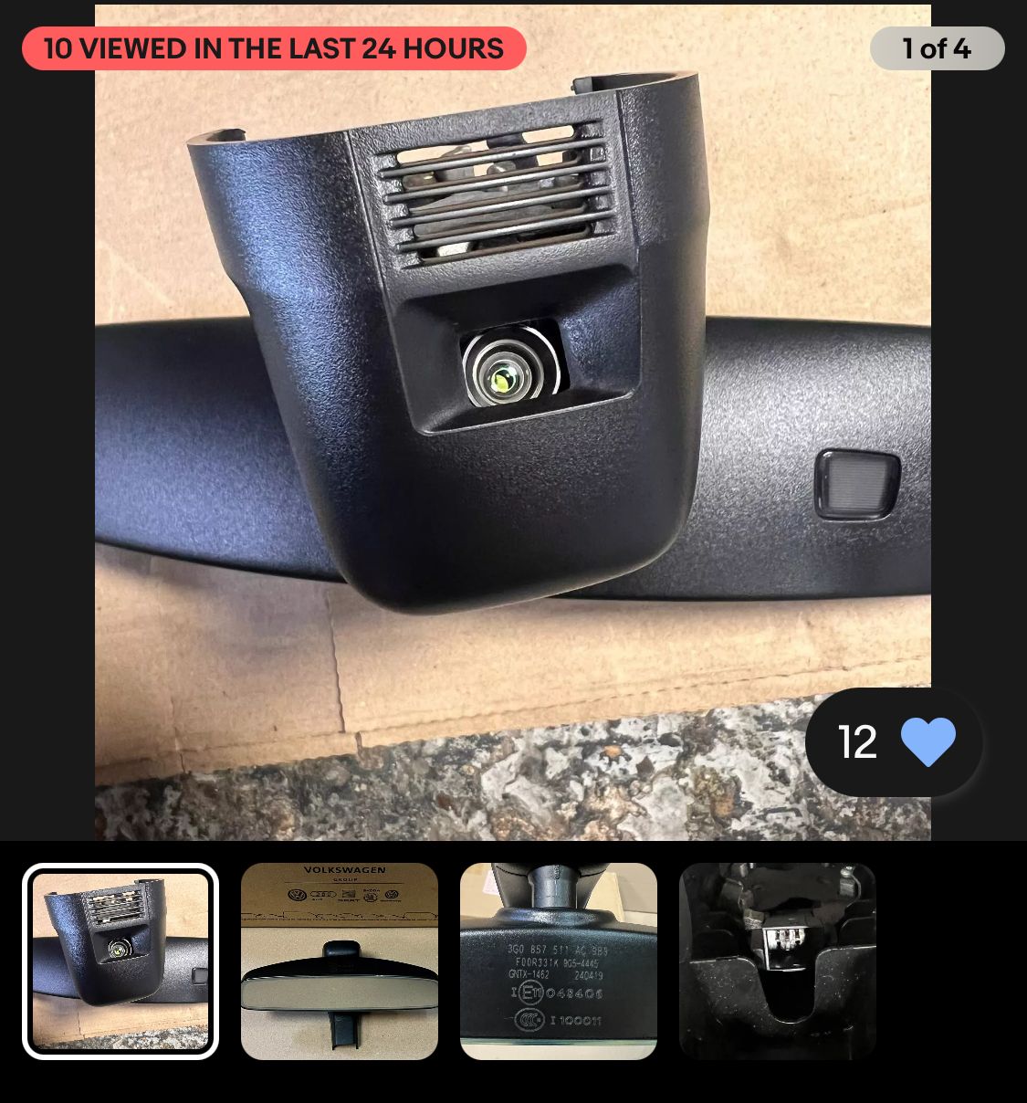

No its got the camera built in ive seen the pictures
There is also camera
3G0857511AK that has camera and is cheaper than AE version
Just want to know if they will work

AK - yes but AC from your post no.
But AK is for another car platform. Basically if you flash this mirror with correct software then it will be compatible with mqb platform

Maybe this is AG - AG is with HBA camera and next model AR also. But like i wrote in previous reply. This is model for another platform and for compatibility with mqb need to flash it with correct firmware
