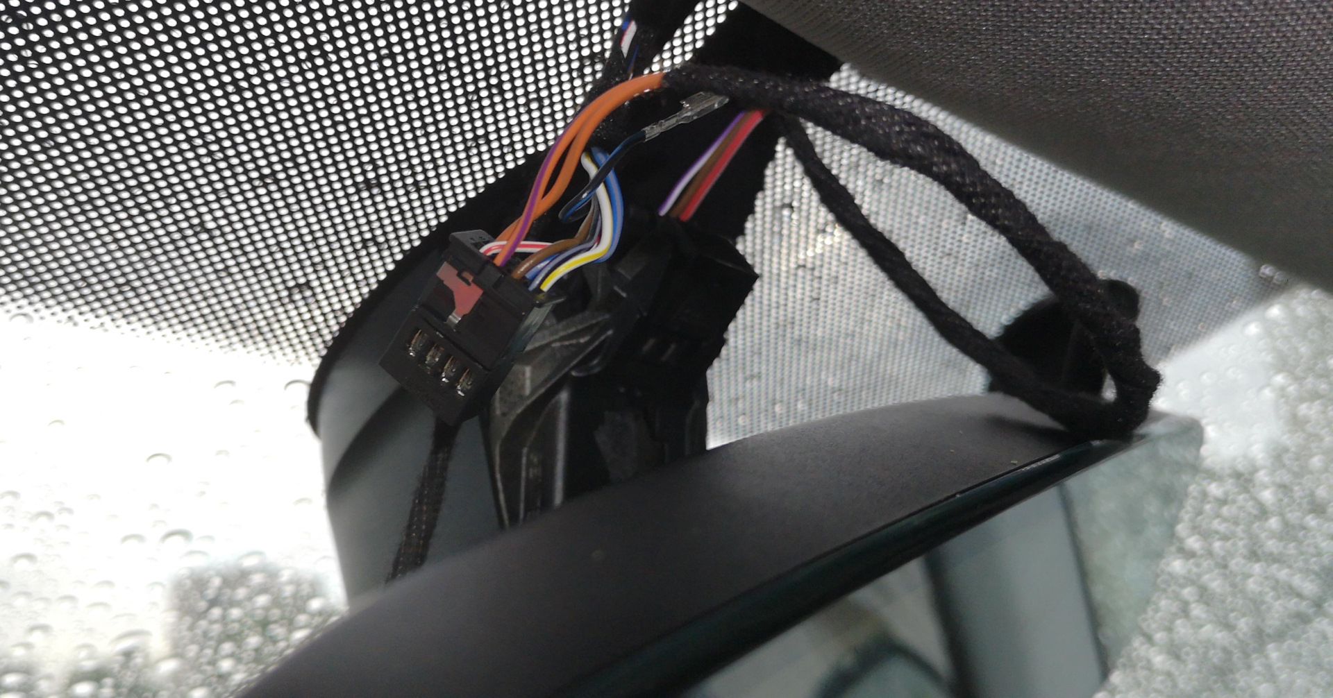

One thing if anyone can help, ive not found it obvious what pins are which in the mirror plug.
CAN H is pin 3, currently reversing wire.
What colour is that wire so i pick correct wire to pull ?
Also which is pin 8 for CAN L ?
Are they labelled up anywhere3 & 8 can l
Are they labelled up anywhere ?
Yes 3 & 8

Any tips for getting these pins out without damaging the connection block ?
edit: below post worked
Why don't they cut off the 2 wires and solder them together with the 2 new wires? First put shrink tubing over the wires. The part number is usually always on the plug.
Unfortunately I've ****** the connection block.
The pins i need to remove are the most difficult and you cant get anyting in to release the catch on the pin, as the purple release mechanism is in the way and the tabs on the pins are hidden facing into the block.
Almost any other pin i can release easy ?
I’ll have to give up.
Only option now is to order a new White block and remove all pins and re pin it all out with a new block
Can anyone help me with the part number for this connection block ?
Check this, looks like it but not sure.
