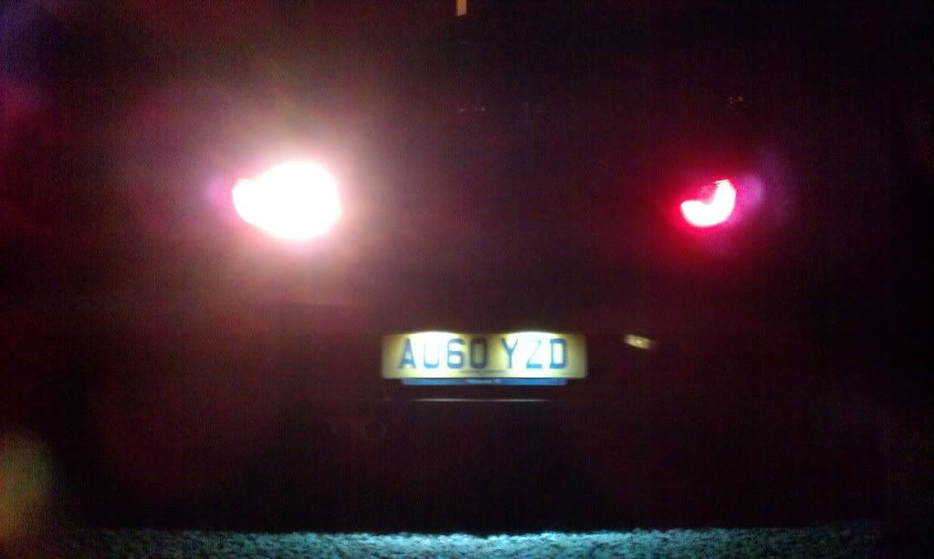

The bulb arrived during the week and I've just had a chance to change the bulbs over.
I'm happy to report a big succes. The new bulb is a great improvement to the crap output of the standard bulb.
Below are some pictures for you to compare, sorry about the quality only had my phone on me.
Standard bulb
Cree led bulb
Standard bulb
Cree led bulb
I hope you all agree with me this is a massive improvement over standard, still would be nice to have 2 reverse bulbs may have to look into that one further but for now I'm happy.

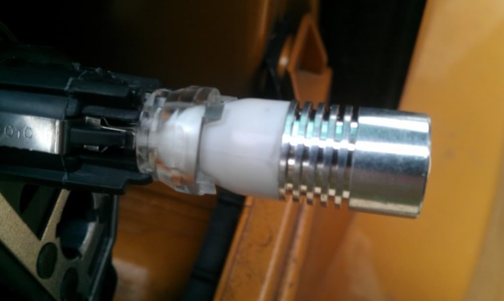

Just a little update for those of you with the 3dr.
This morning I thought I'd take a better look at my work and noticed the bulb wasn't really sitting right in the holder.
Pictures not too clear but the bulb wasn't really pushed back as far as it could go into the contacts. The clear plastic part you can see was not allowing the bulb to go back any further because of the shape of the bulb. So that had to come out.
The offending part is easy to remove there are 2 clips holding this in place just pinch both clips give it a wiggle and a good pull and it comes right out to leave you with the below.
Now the bulb sits right back in the holder with a much better contact and less chance of it falling out hopefully :D
