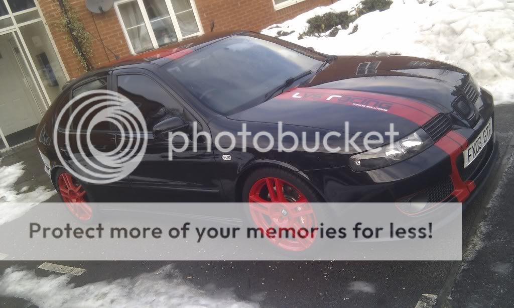

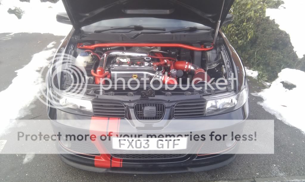

Hi guys,
Been on here a while now and recently had a lot of upgrades done to the car so thought it was about time I showed it off. Hope you like!!
List of Mods

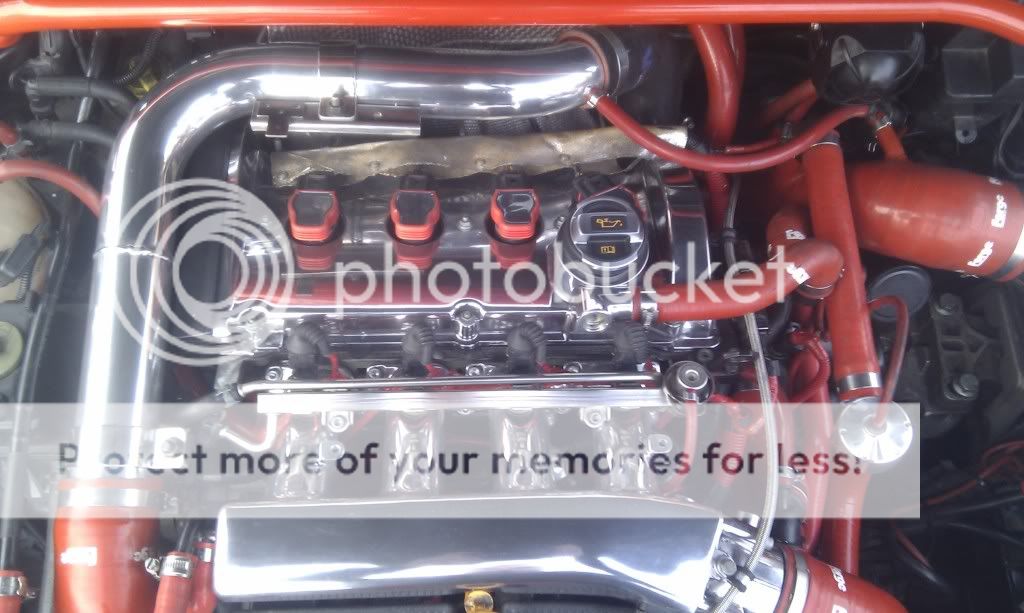

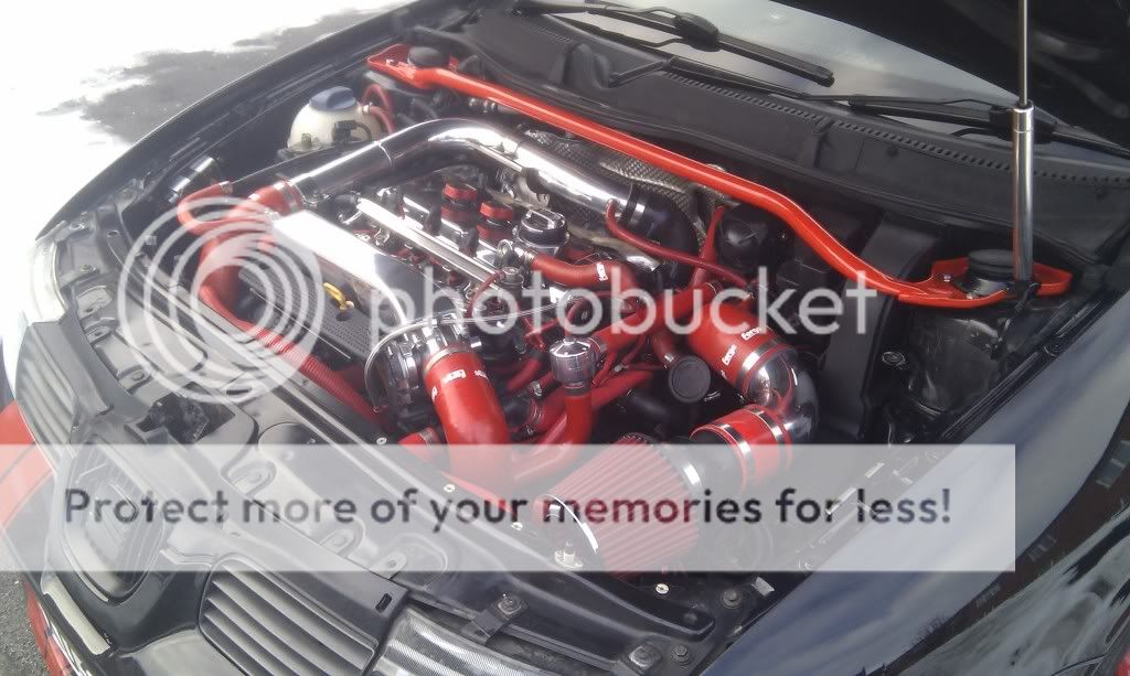

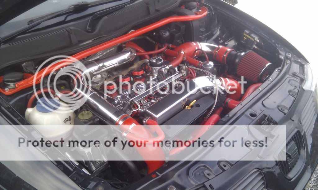

Engine
Revo Stage 3
ATP Eliminator kit with GT2871RS Turbo
High Flow Manifold
Blueflame Turbo Back Exhaust with 100 Cell Catalyst

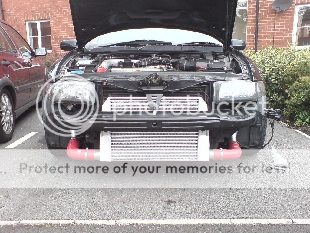

Pro Alloy FMIC
Viper Air Filter
Bailey DV30 Dump Valve
Genesis 550cc Injectors
4bar FPR

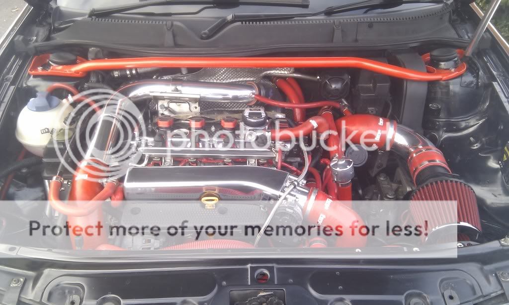

Custom Polished Charge Pipe

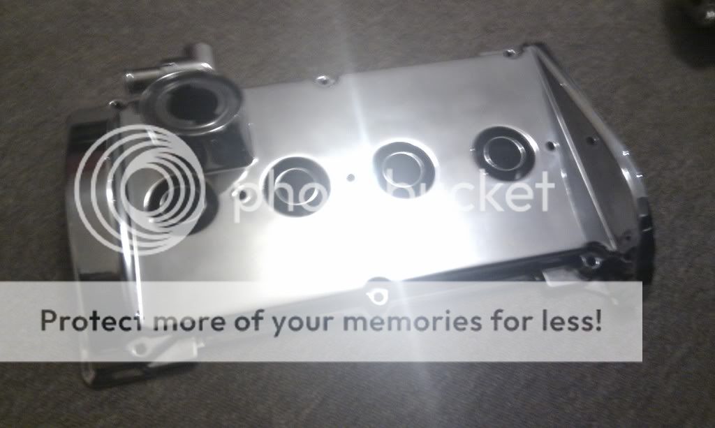

Polished Cam Cover off a European VAG car

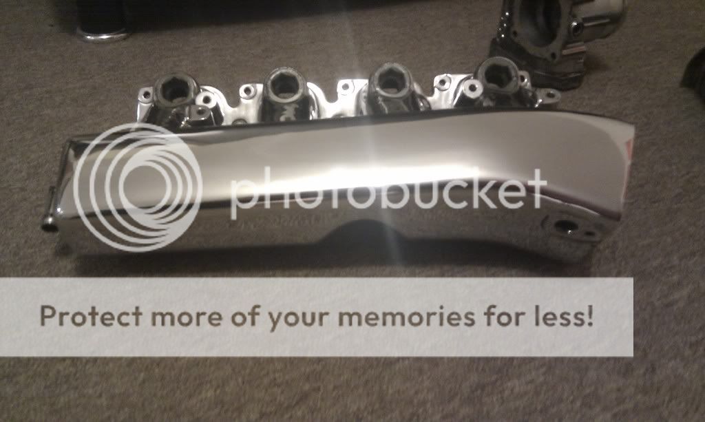

Polished Inlet Manifold
Forge Red Boost Hoses, TIP, Cold Side Relocation Kit
SFS Coolant Hoses and Brake Servo Hoses
Handling and Brakes
S3 Strut Brace

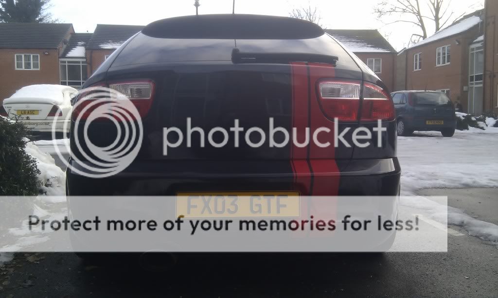

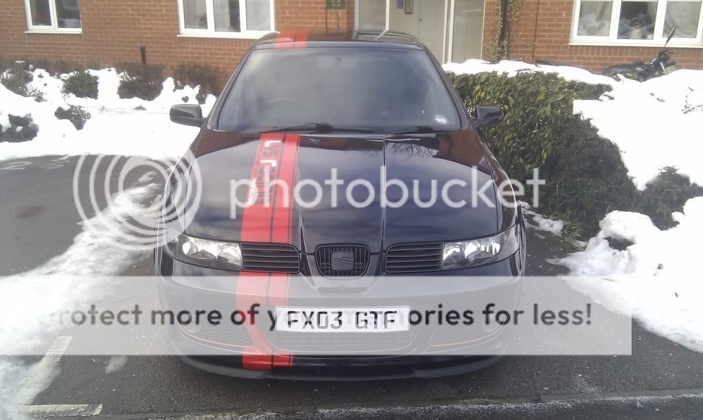

Styling and Miscellaneous Parts
Tinted Windows
Debadged including the S on the Boot

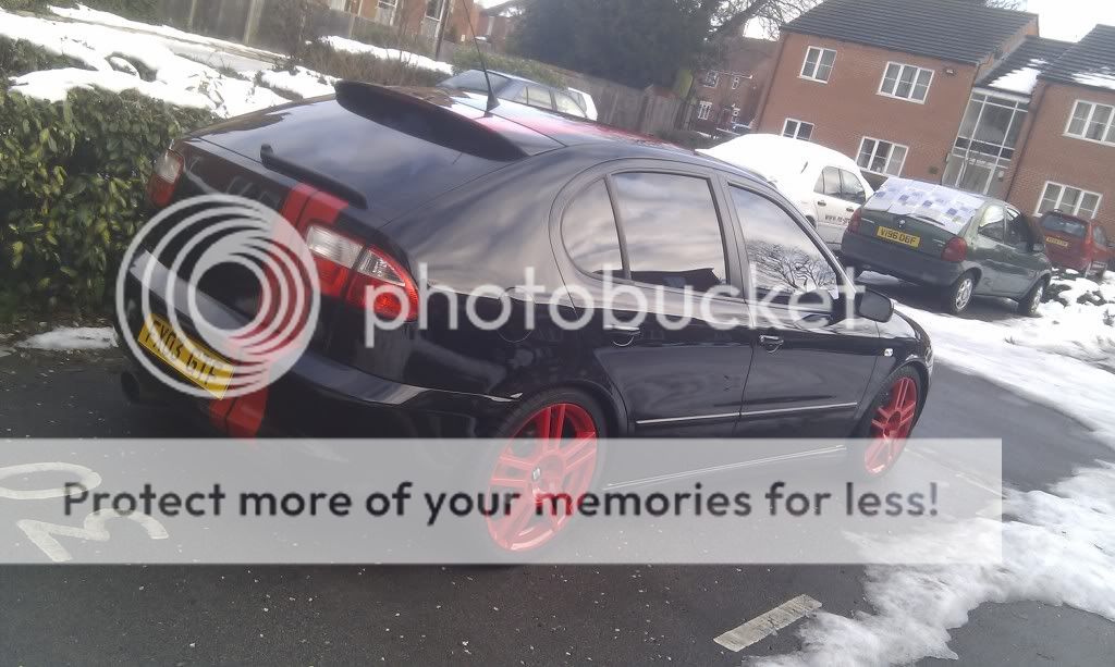

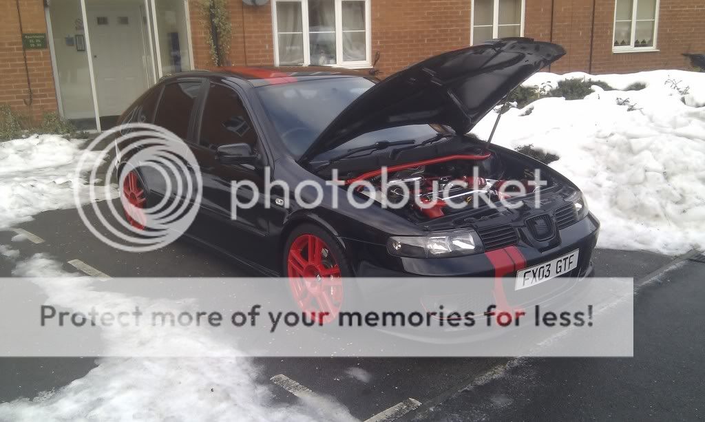

Red Wheels

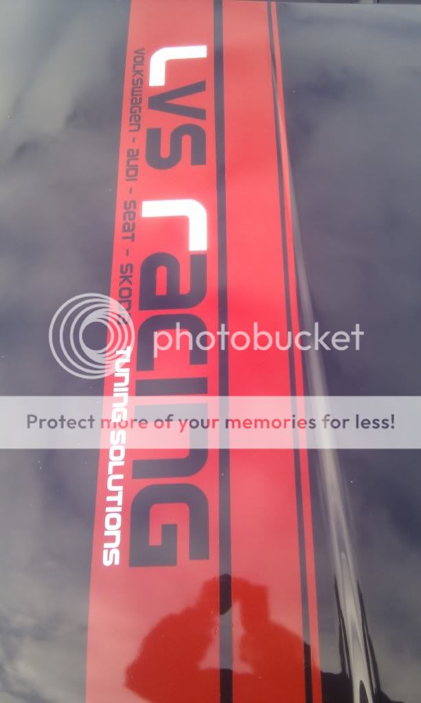

Red Vinyl Strips with LVS Logo

Red Conduit in Engine Bay

I like the stripes much better than just 2 equal stripes
wheels look smart too
also the red strip around the fog vents all ties in nicely
great car Rick :).
Have a read of Bill's thread on 3 inch custom tip's for the LCR. It will make a huge difference to your power delivery and peak bhp levels, its a must for your motor. Your gt28rs is getting starved by the standard uprated tip, all BT gt28rs installs use the 3 inch intake for good reasons.;)
Good lists of mods there mate, what sort of power is it producing. oh and that intercooler is bloody massive!
Cheers for your comments guys. Really chuffed with the way it turned out. Shame I've got it back at the wrong time so can't really push it but I suppose it'll give me time to bed everything in.
The red wheels and stripes won't be to everyone's taste but I love how it all blends in with the engine bay and how it stands out from everything else. Played around with a few ideas on Forza 3 and its come out exactly how I wanted it and hope it doesn't look too "chavy" :p
looking good mate and about time :)
i like the red wheels :)
Yeah its definately something I will do in the future but as I'm still running on standard internals its probably a good idea to limit certain areas. Once I know the internals can handle more then I'll sort out the areas which are restrictive.
