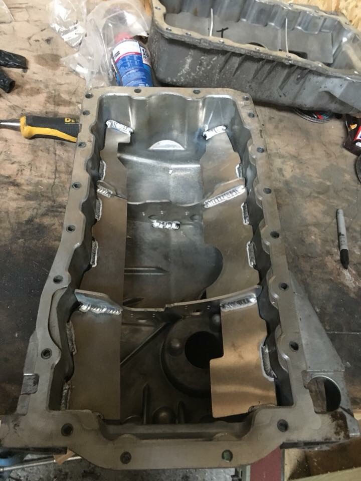

As above i also highly recommend a baffled oil sump... I'll quote @Sparkie on this one.
"Baffled sump is a no brainier.
For the minimal outlay you save your engine from going bang.
Only need to starve oil for a second and Pop!
Hard braking or long corners with G force loading will push all the oil strait up the front or side of the block with out a baffle.
There is a guy on here who sells made up kits to weld in or ready welded versions in old sumps.
Names Oliver Beaumont.
Or find him on Facebook too.
I paid around £130-150"

No idea if I will ever truly be using it but good to know engine will have some protection as well as a good excuse to change the pickup and oil
Sent from my SM-G986B using Tapatalk
Very nice!!!! Where did you get it from?
Link if you have one please :)

Hi the guy was Olly Beaumont doing the sumps but I believe he has stopped for some reason. He might have one knocking about or still have a set of the inserts knocking about.
