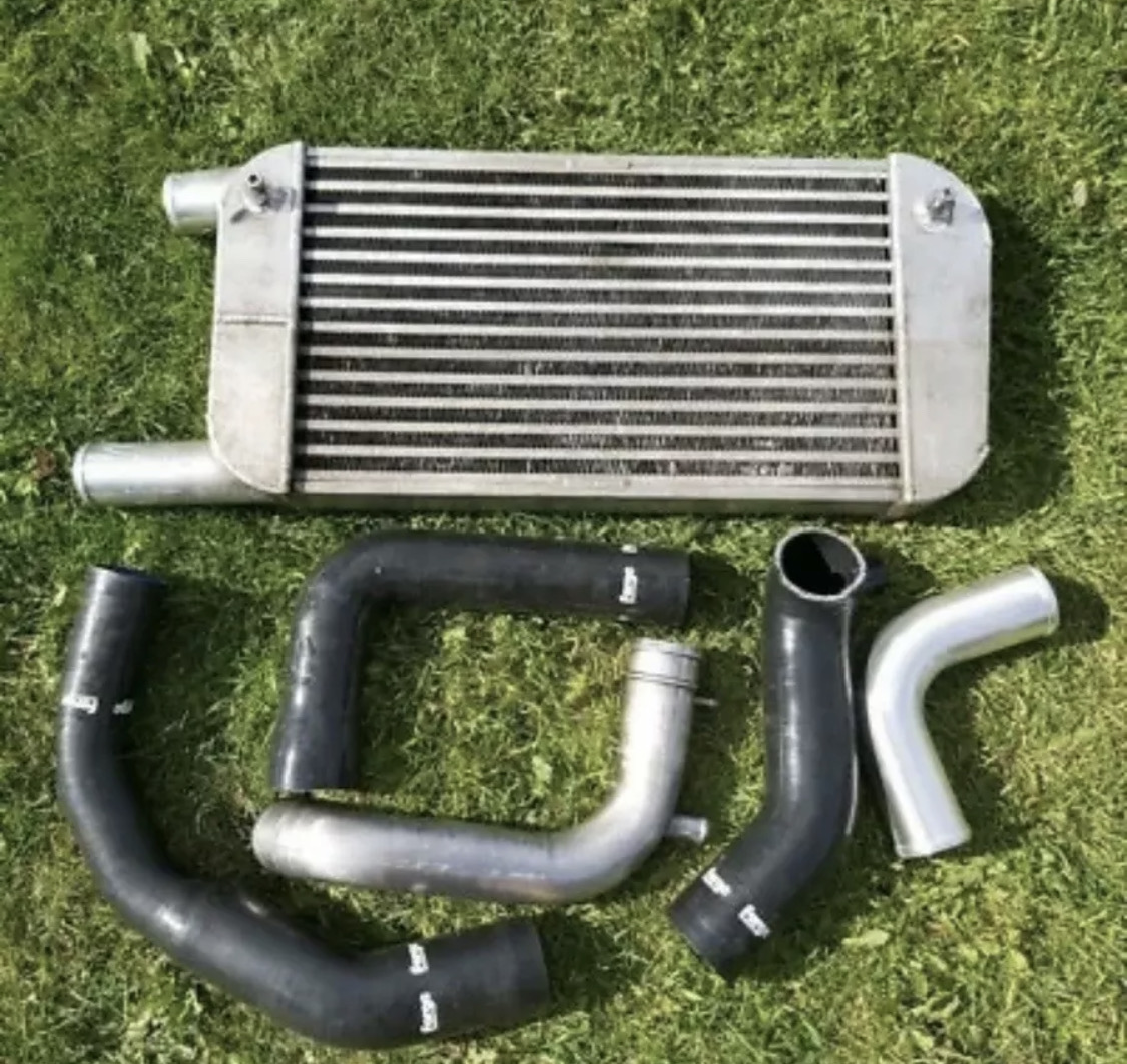

Ok wicked thanks guys, can you still get hold of the Adjusted crash bar? if not how much work is involved in cutting the OEM one?
Also price wise im not to sure atm hopfully £150/£200? i felt like that was a good price but it all depends on how much wokr there is or how much the replacement crash bar is haha
Replacement crash bar I feel like will be near impossible to find. I don't know from experience how much you have to cut up the old one. Stupid that it doesn't come with the bar. Look around on google for lcr forge mic fitment maybe you'll find the thread where they show pics of the old one cut up

I dont think this one that im looking at is going to fit, correct me if im wrong but the one im looking at (pic attached) has two exits both of the left side where as the LCR one have one on the bottom left and one on the bottom right,
thoughts?

looking like im an idiot haha
thoughts?
That's for a regular 180 cupra platform or gti etc

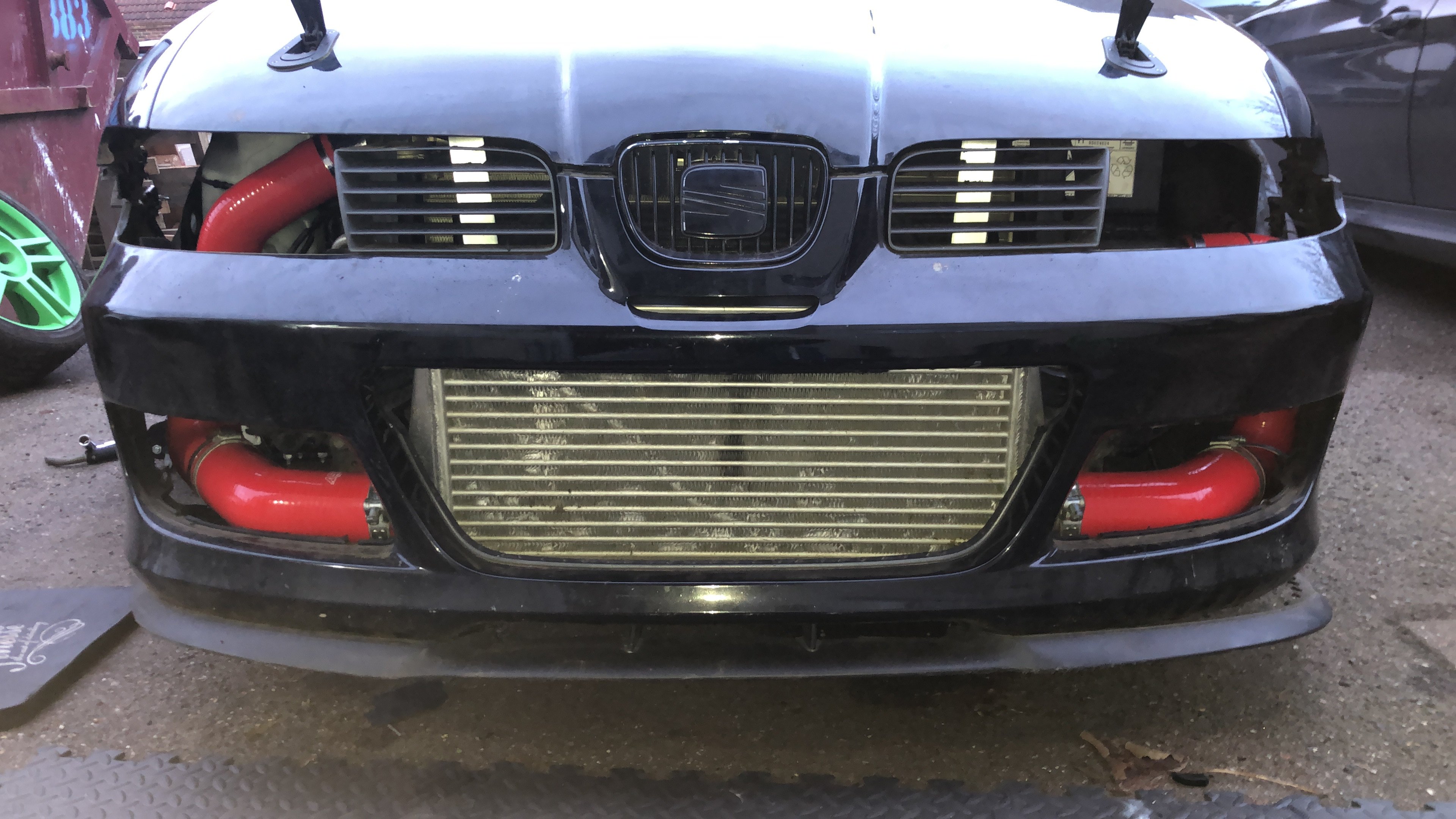

Hi all, been painfully busy at work of late hence the lack of updates and delays in the build.
Ended up getting a 2nd hand fmic got it for a real good price and it’s oversized. Had to modify the bumper a fair bit to fit it in etc but happy with the end product :)
Going to be upgrading my fuel rail and injectors this weekend aswell.

Nice Job there, did you get the pipes / hoses with it or just worked out what you needed and brought the hoses individually?
As for coil packs, many on the forums / social's say the standard ones are fine, just get new ones but personally i've been running the 'R8' red ones for 4 years and the cars not missed a beat. Got mine from Awesome GTi.
Thanks :) unfortunately not didn’t come with anything so had to design the piping and connectors etc myself, got all the piping etc from Auto Silicone Hoses (http://www.autosiliconehoses.com/)
They were great, really helpful especially on the phone.
