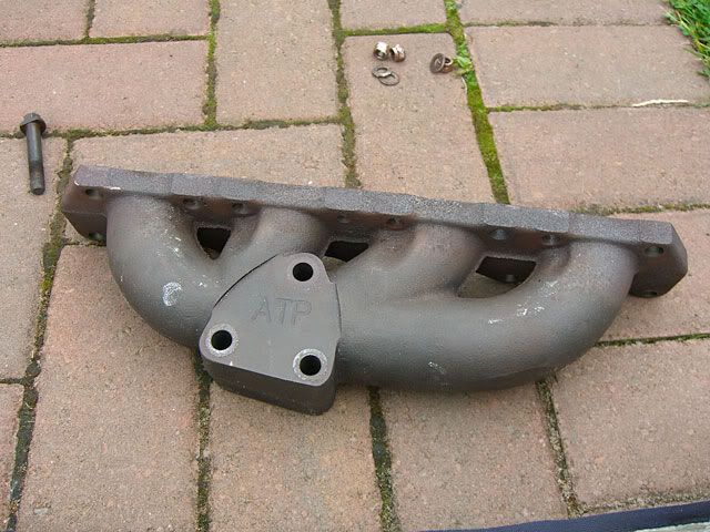

WELL ......................... the ATP manifold is OFF!!!!!!!!!!!!!!
After ALOT of farting around I finally managed to loosen off the nuts, enough to get a spanner in and get them off. I ground down the small 1/4" drive 12mm socket and hammered it onto the nuts, gave enough grip to crack the seal.

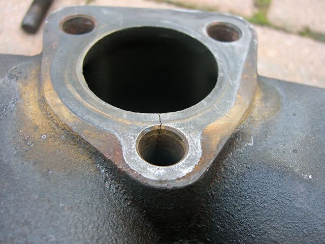

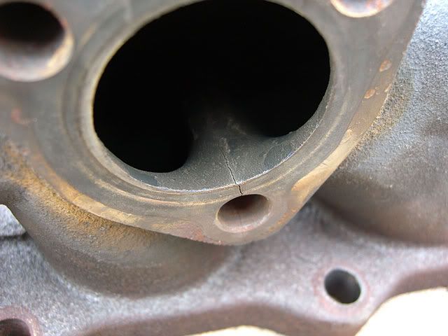

First thing I noticed about the manifold once removed is that it is CRACKED!!!

Was it cracked btw, Rob? (Or can't you stand to look closely at it?)

you manni cracked in the same place as my old one which was replaced, and same as DPJ's, must be a weak point of the ATP Manni, mine is coming off day after tomorrow and i know for fact - no manni atp make will come near my car again ! touch wood this second one hasnt cracked on mine but we shall soon see

do ATP still churn out these manifolds? if so have they been revised or do they still crack
and if they do fail all the time, surely ATP will be in trouble soon with a decrease in manifold orders....:blink:
my first one cracked, i got it repaired, then it cracked again, played hell with ATP and they swapped it for another one, im yet to take this newer one off, but i am this weekend so all will be revealed then, they did say though when they were on the phone they have "altered" the design of the manifold, although when my new one came through the post it was literally identicle :blink:
