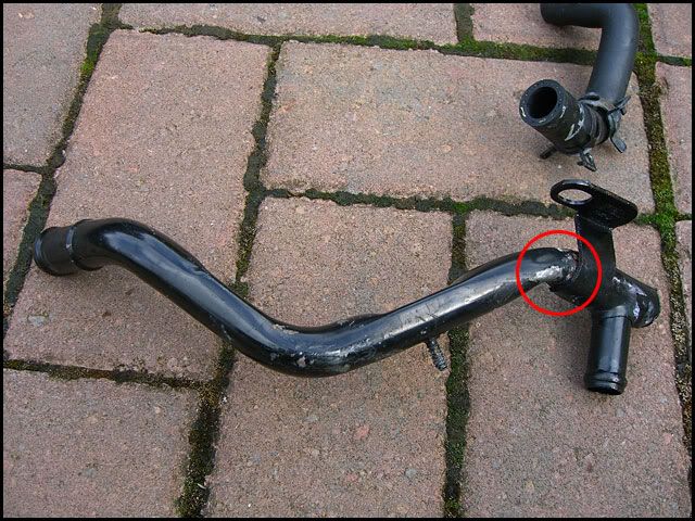

Today, while I'm waiting on the new manifold, I thought I'd tackle a couple of jobs needing done. The hard water pipe that passes in front of the turbo inlet had been bent back by Star when fitting the GT2X. As a result of this, the pipe had a bad kink in it, which must have been affecting the coolant flow. So today I drained off the coolant and cut the pipe off.

Badly kinked right here:
http://i312.photobucket.com/albums/ll330/SonicBlueLeon/pipe2.jpg
I've removed all the old rubber hoses so after I've used some JB Weld to create a bead around the cut pipe, I'll fit new 19mm silicone hoses with a couple of 90 bends to aim the hoses around and away from the turbo inlet - job done right!

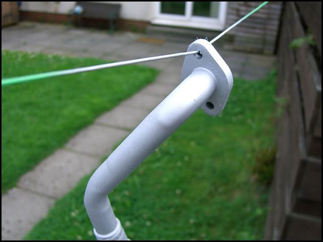

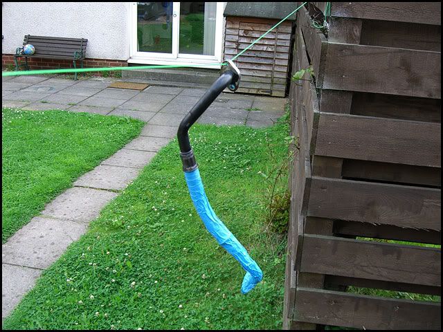

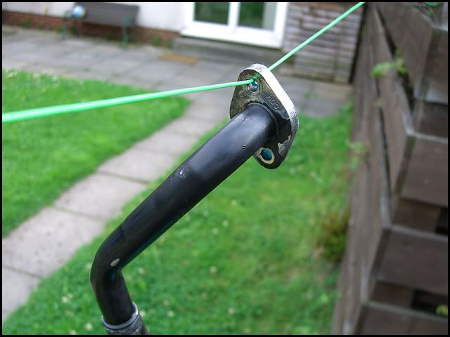

The oil return pipe was looking quite tatty as well, so I rubbed it down and gave it a couple of coats of VHT silver paint that I had in my shed, didn't have any black but it's down the back of the engine anyway so doesn't matter what colour it is!

Rob, are you telling me that they actually bent this pipe to fit??? jesus H christ!!!
Junior, yes mate, that is just pure shocking!!
Yep, bent it out the way to get the turbo inlet in, causing a huge kink in it! I'll get Craig (csd_19) to show you how Star got a 3" inlet to fit on his car when fitting a GTRS Elim!
I'm spending alot of time fixing faults from shoddy workmanship, at least I know it will all be done right once the car is back on the road.

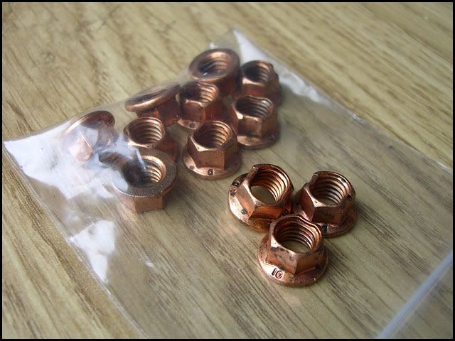

2 bags of 12 copper K-nuts arrived this morning, beauty of these is a 10mm head rather than 12mm, easier to get spanners and sockets into them. Nord-lock washers on order too.

Small update - got the metal epoxy today so made a nice bead around the end of the cut water pipe, ordered some silicone hoses from Forge to re-connect the engine to the bulkhead.
Decided in order to keep the costs down, not going to spend £260 on Zircotec coating, so instead spent £20 on 2 tins of matt black VHT ceramic paint. Going to paint the 3" alloy inlet pipe with this too.
