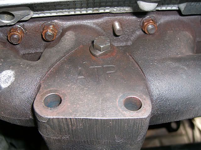

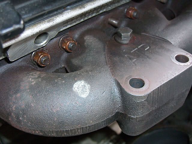

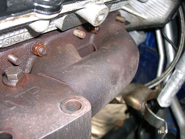

OK, here's pics of the nuts that have no access for sockets or spanners, 4 of them:

Looks simple enough eh? Nope, normal or small sockets and spanners will not go in there, even if you can get s spanner onto the nut, you can't turn it because something is in the way! I can get a small socket on the left one, but then you can't get the ratchet head onto the socket, even with a flexible joint!
Other thought I had was to dremel a slot into the head of the nut and stud, then use a flathead bit with a spanner on it to get it off? Mind you, be as well to cut the stud and nut in half if I do that!
You can't get a ring spanner head round the nut, no clearance on one side of every nut, has to be open-ended. A straight spanner is no use either.
I was just looking at that Rob, obviously not enough clearance one side, so it looks like a straight spanner would work, but you say it doesn't, how come?:blink:

get a flank drive spanner (halfords professional ones if you have'nt got another tool shop near you)
fiddly, more so when you cant see it as easily as the pictures make it look
JS one is even less clearance
one of the "special" spanners we had to make to fit JS mani, was a cranked ring spanner which we ground down very thin so it would go over the nut.
just a thought
I think I managed to get at those with a v small socket set, with a UJ on it - same as jonah's ATP that was.
nice bodge by star cutting a section off that bolt...
