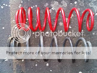

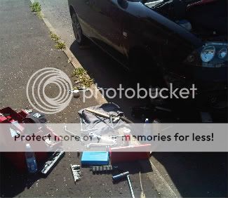

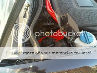

Well had the Wknd off and the weather was good so decided on fitting my new lowering springs...
FK-Automotive 60/40mm Lowering springs and shortened drop links (Ford Puma Drop links).

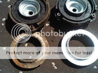

Also decided to fit new Top mounts and Bearings (Sere motors NI).

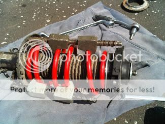

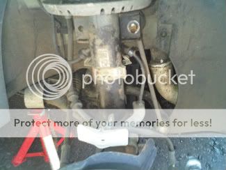

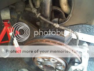

Front Strut Removal>
Front Standard Springs compared with FK ones>
Old Top Mounts and Bearings and New ones>

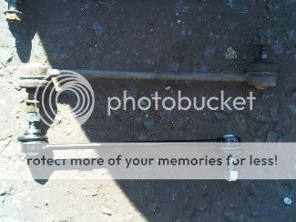

Standard Drop Links compared to Shortened ones (Ford Puma Drop links)
New Spring compressed with New Top mount and Bearing on>

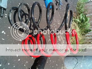

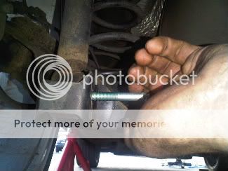

Rear Spring Removal>
Rear Standard Spring compared with FK ones>

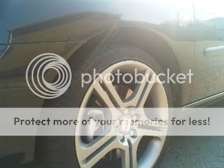

Before and After
Standard ride height>
After fitting FK-Automotive 60/40mm Lowering springs>
New springs have still to settle, pic was taken straight after fitting...
Will take another pic later in the week once truly settled

good man....yeh it will come down yet, you happy with the drop?
Fronts came doon a fair bit overnight bud, Rear not so much maybes it cause ave a empty boot lol
Am fairly happy with results. Fronts no far off what a was hoping for but the rear is miles off and may need to be chopped

What did you think of the puma drop links? I'm needing a new set, but so far none of mine have lasted more than a year
There spot on so far, no contact with other components, no knocking or rattling etc. However its has been just over 48 hours since ave fitted them bud.
If you go on Awesome GTI they are selling the (ford puma drop links) as Ibiza,Fabia,Polo shortened drop links>http://www.awesome-gti.co.uk/product.php?xProd=15224&xSec=344
Awesome GTI £29.99 plus postage
Mine cost £13.92 delivered :D
