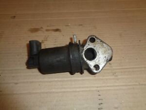

Does the egr valve look something like this?
