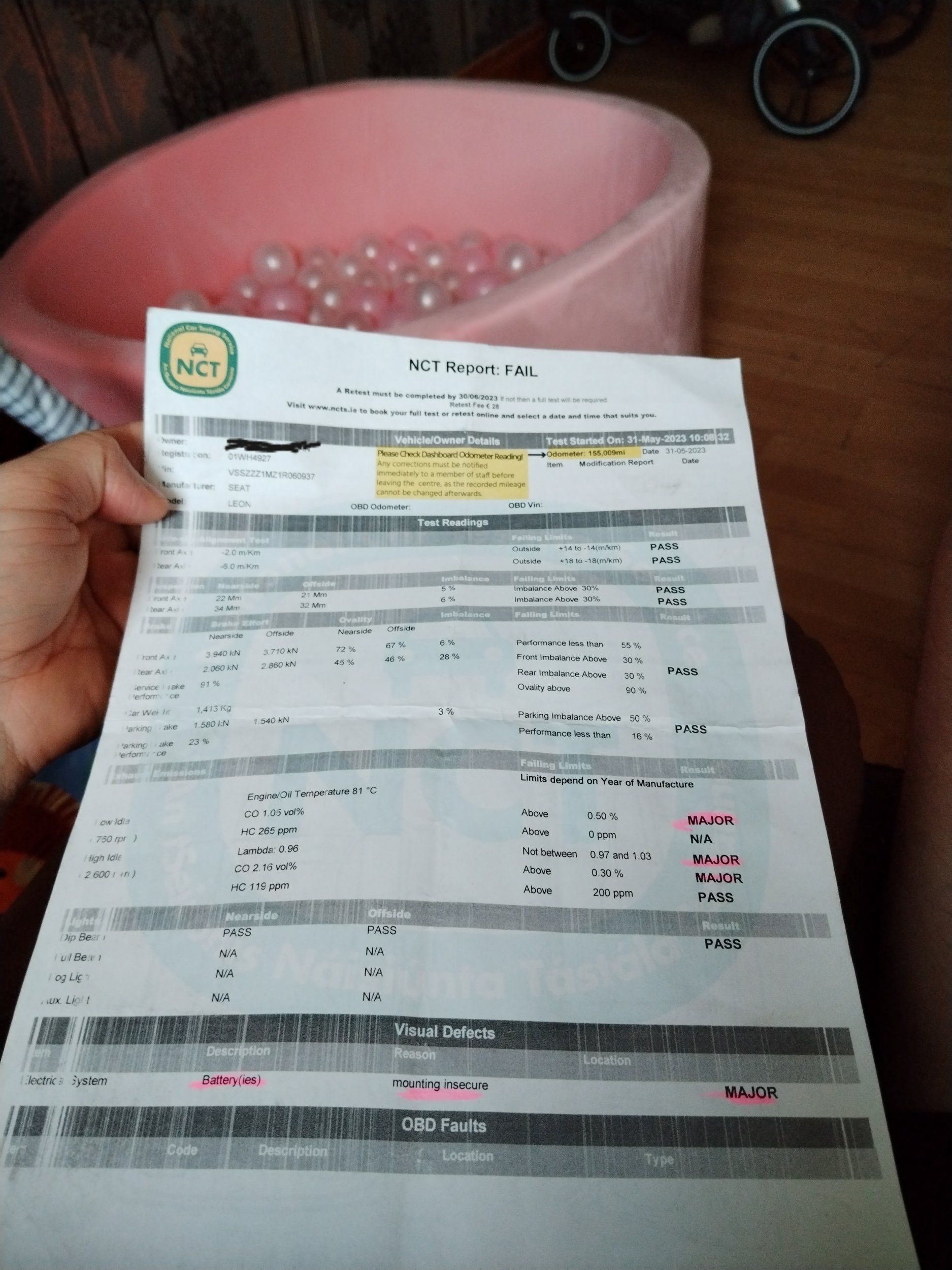

Mk1 Cupra Leon, 1.8T AUQ 180BHP mapped to 210, failed the NCT (Irish MOT) on emissions (couldn't be tested due to excessive smoke). Then some Wally decided to add an extra catalytic converter (obviously to try and mask the issue without addressing it) and put it through again. It failed again (but not due to excessive smoke this time, emissions were tested this time but the co was through the roof) (I will post a picture of fail sheet).

That's the fail sheet of the second attempt. Bearing in mind that is with the standard catalytic converter in and another universal one in the exhaust system as well.

Must add when that test was done the thermostat was dodgy. Would get upto temperature with the heat switched off. Turn on the heat it dropped. Thermostat is fixed now. But still doesn't solve the running rich issue
