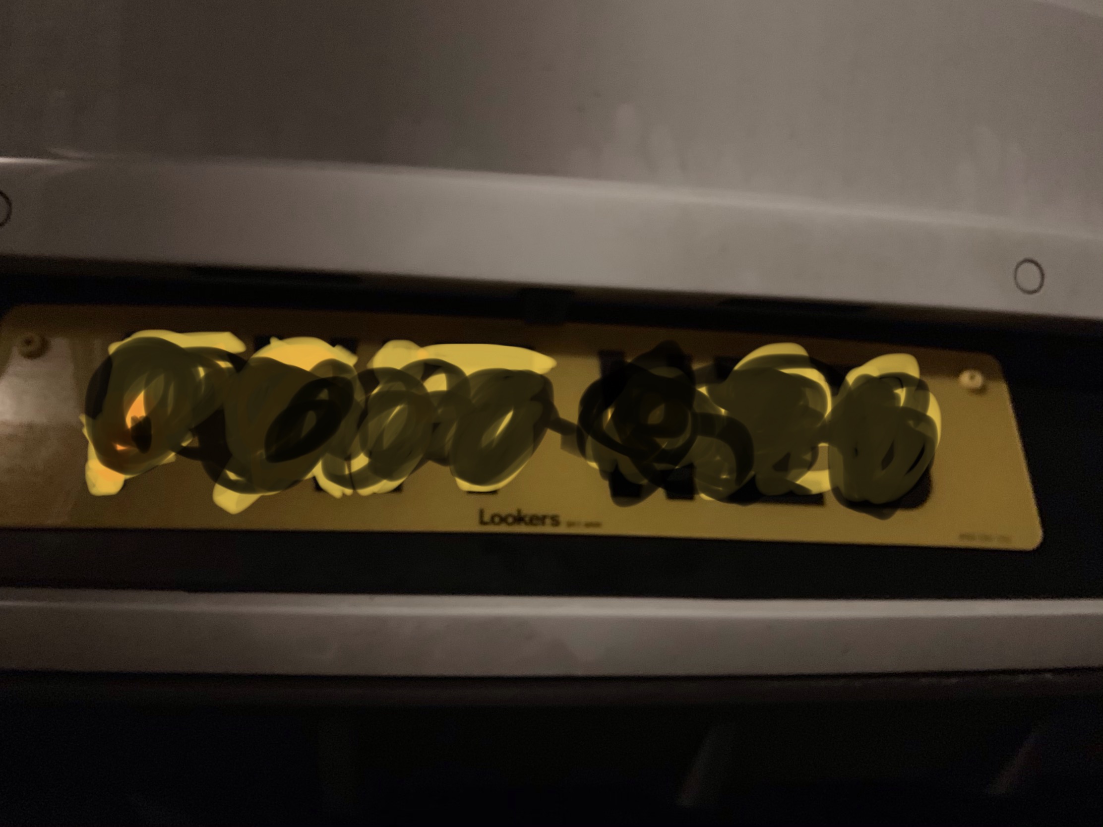

Done n dusted took him an hour cracking lad no mess no fuss very pleased with it for £225 it’s a Sony lens guaranteed for 2 years

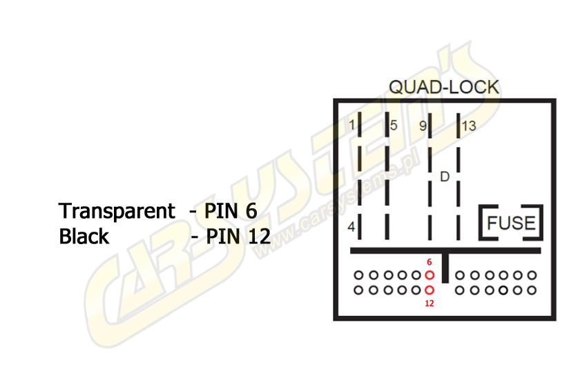

Did you order from Carsystems? I ordered from them (RVC high) and here's what they sent me:
Hi
I send you coding information and scheme how connect this set
ADD 6C TO 19
5F ADAPTATION:
CAR FUNCION LIST BAP GEN2-VPS-----ACTIVE
CAR FUNCION LIST GEN2 - VPS msg bus -------TERMINAL 15
Calibration you will have to do yourself if you need it
Best regards
Carsystems Team
Very poor instruction info but I believe I will make it with some help from ELSAwin. What did you use for the coding? VCDS or something else? The above instructions are for VCDS.
