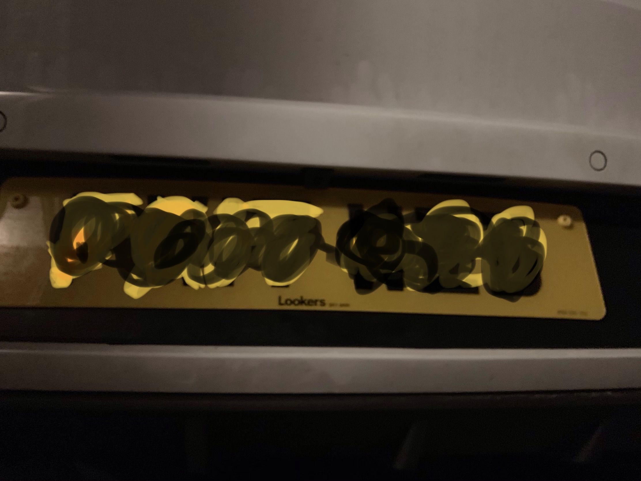

Number plate light, is just unplug the OEM, and plug this.

Number plate light doesn't have a plug. It's two wires with bare ends.
As for the reverse light I didn't really want to use one of those but never mind

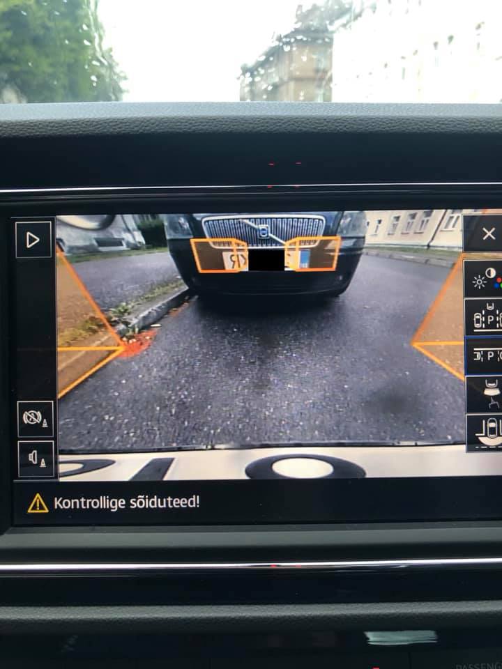

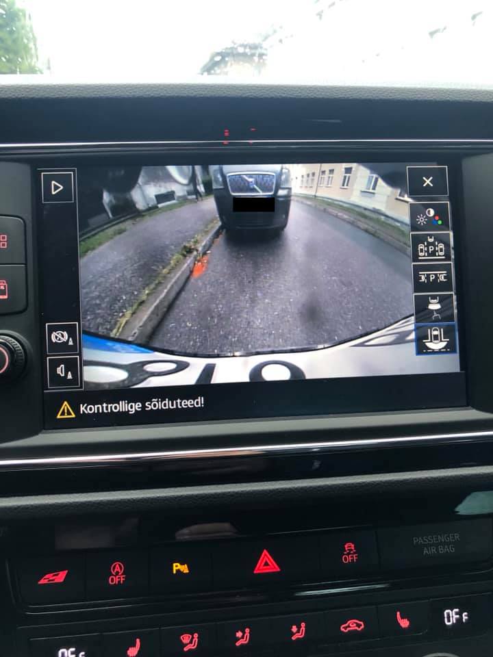

I saw your tag saying you do OBD11 programming. I have a question if you see this post. I have recently installed an aftermarket reverse camera on my Seat Ibiza FR Sport (2019). I have done the coding which brings up the reverse camera on screen when in reverse gear. Though the trouble is, when I come out of reverse screen the camera stays on the screen for around an extra 5 seconds. I believe this is because my car does not have the OPS installed and cars that come with the optical parking sensors would show the sensors on screen for a few extra seconds. Is there a way around this so the camera screen turns off straight away? Also some times I get a message saying park pilot is not available .
Hope what I've said makes sense.
Kind Regards,
Jack

Are you sure it does not have to do with speed? The camera should turn off when you reach 7-10mph or something, not when you disengage reverse.
The park pilot message is a matter of coding but I can't help you that. I do not use OBD11.

I see, my understanding is when you disengage reverse gear it automatically turns off the screen and goes back to what was previously on the screen straight away i.e the radio.
But as said, sometimes once it does go off it will display the park pilot not available message, which I believe is because of my car does not have any sensors or OPS, as I did not want to wait over three months extra haha...
But thanks for your reply

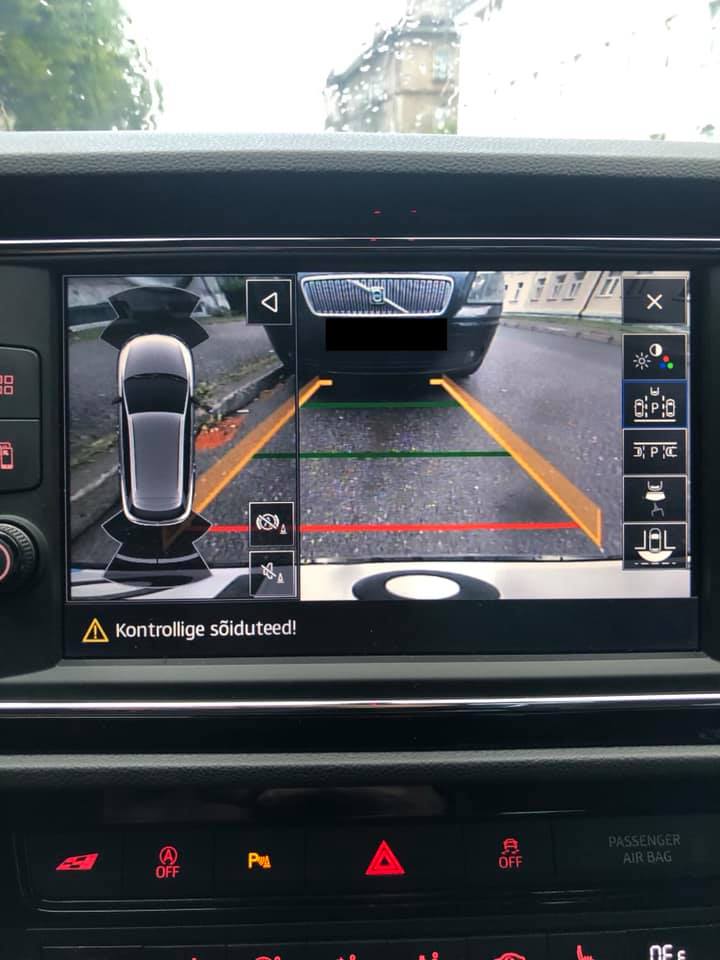

I do believe that it could be just the speed switch off. I have ops activated and it says on that screen for a few seconds afterwards. You could always activate ops so the car pops up but I don't see it'll do much of a difference
I may have a question for you...
i have two 5F, one with Mib1, and one with Mib2. I made a RVC in Mib1 car, (Mib2 was factory default) and if you took in Reverse Gear, there is a Black Rectangle around the little car view... and this will hide out, / transparent about 2 seconds... Can this transparent time reduce? because in Mib2 there is no waste, it will be transparent immediately... Thanks for your help!
