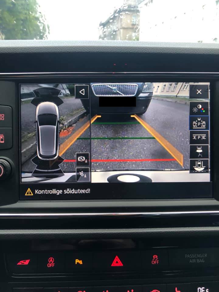

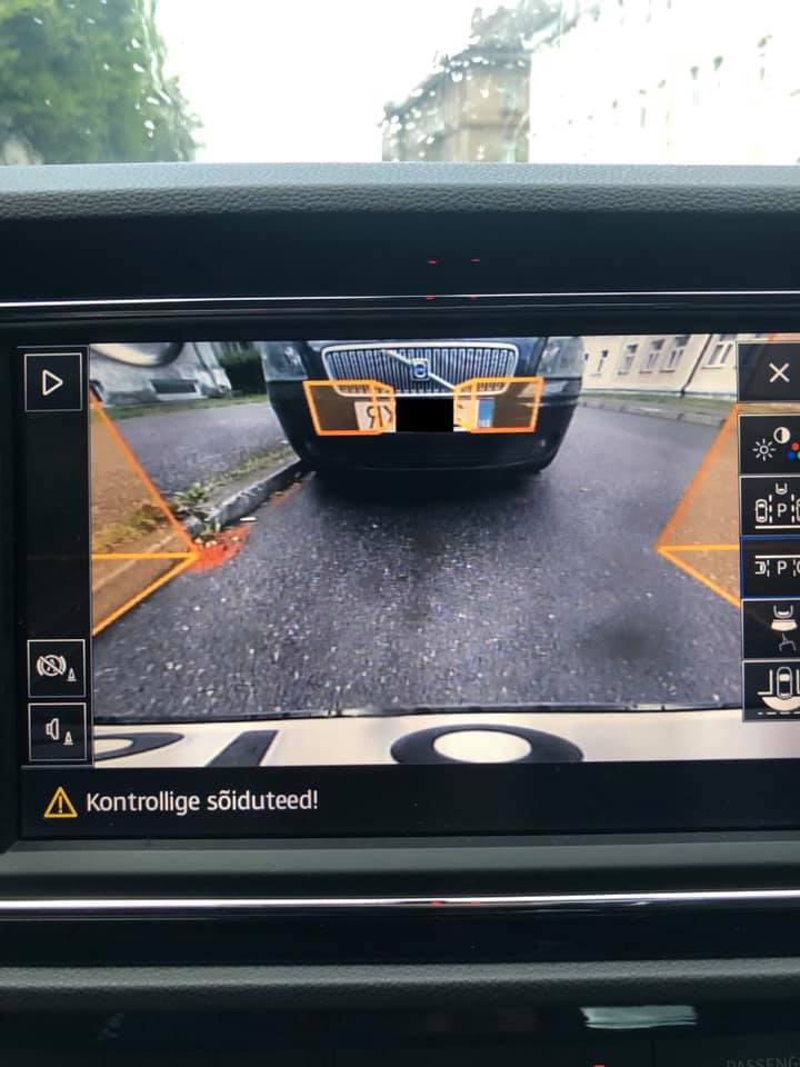

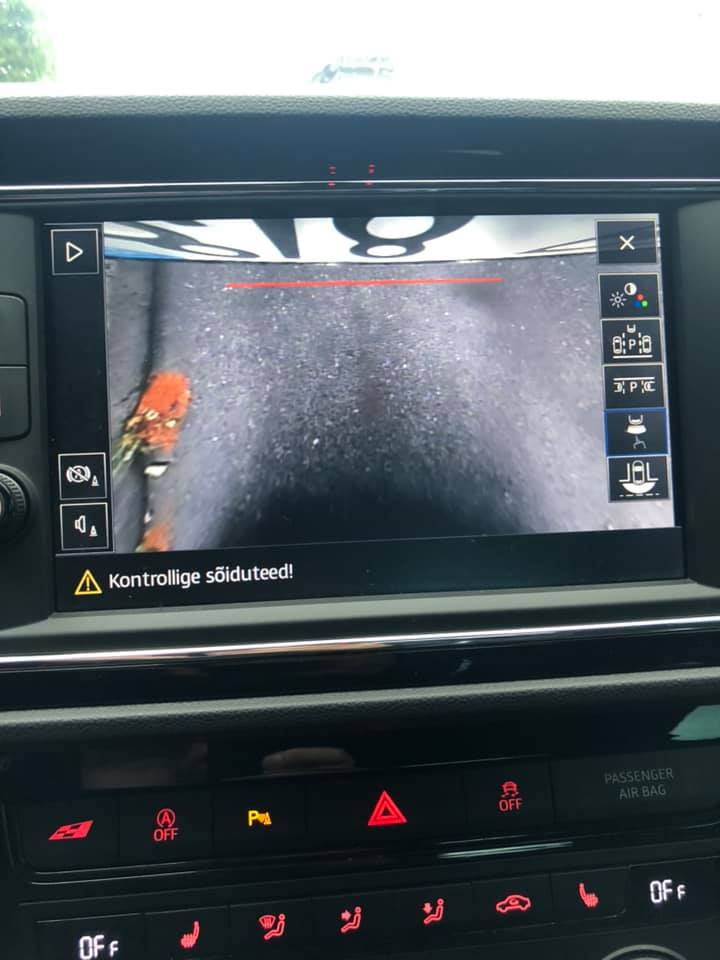

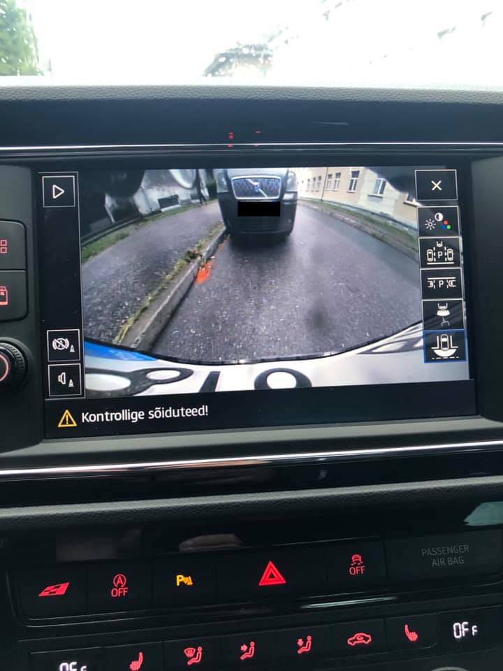

For FR I used 5Q0980568A and for Cupra 5Q0980556B. Both ordered from vwModule. If I remember correctly price was about 150 - 180 euros (cables included). Coding manual was included but camera parametrization has to be made for VW not for Škoda :)

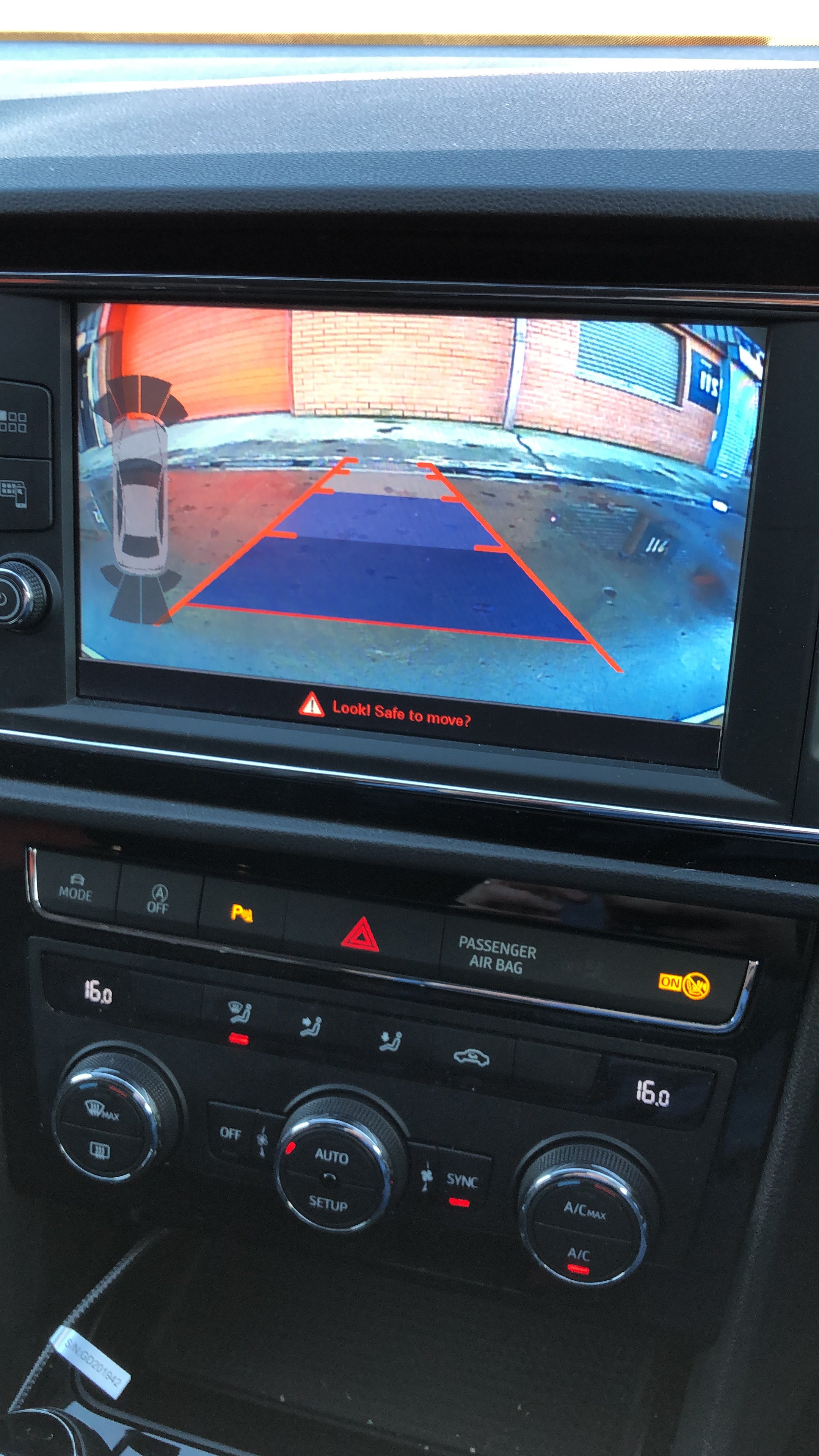

Got my camera installed at the weekend. £400 fitted (could have bought the parts for £270 if I was confident of fitting myself). Included a wedge style camera fitted inbetween the 2 reg plate lights. Looks very good and working well - activates with the reverse gear like the factory fitted version.
Looks good. The screen display is slightly different to factory fitted cameras but I prefer yours. The image area of the vehicle outline with the sensor proximity lines is more opaque so you can see more of the camera image.
Yeah that always annoyed me with the factory fitted ones (had it in my old VW Polo and my current T-Roc). Really cannot complain at the quality vs the price. Reverse camera was something I felt the FR trim should have had as standard...
This must be the way the fitter has coded it within the car?
