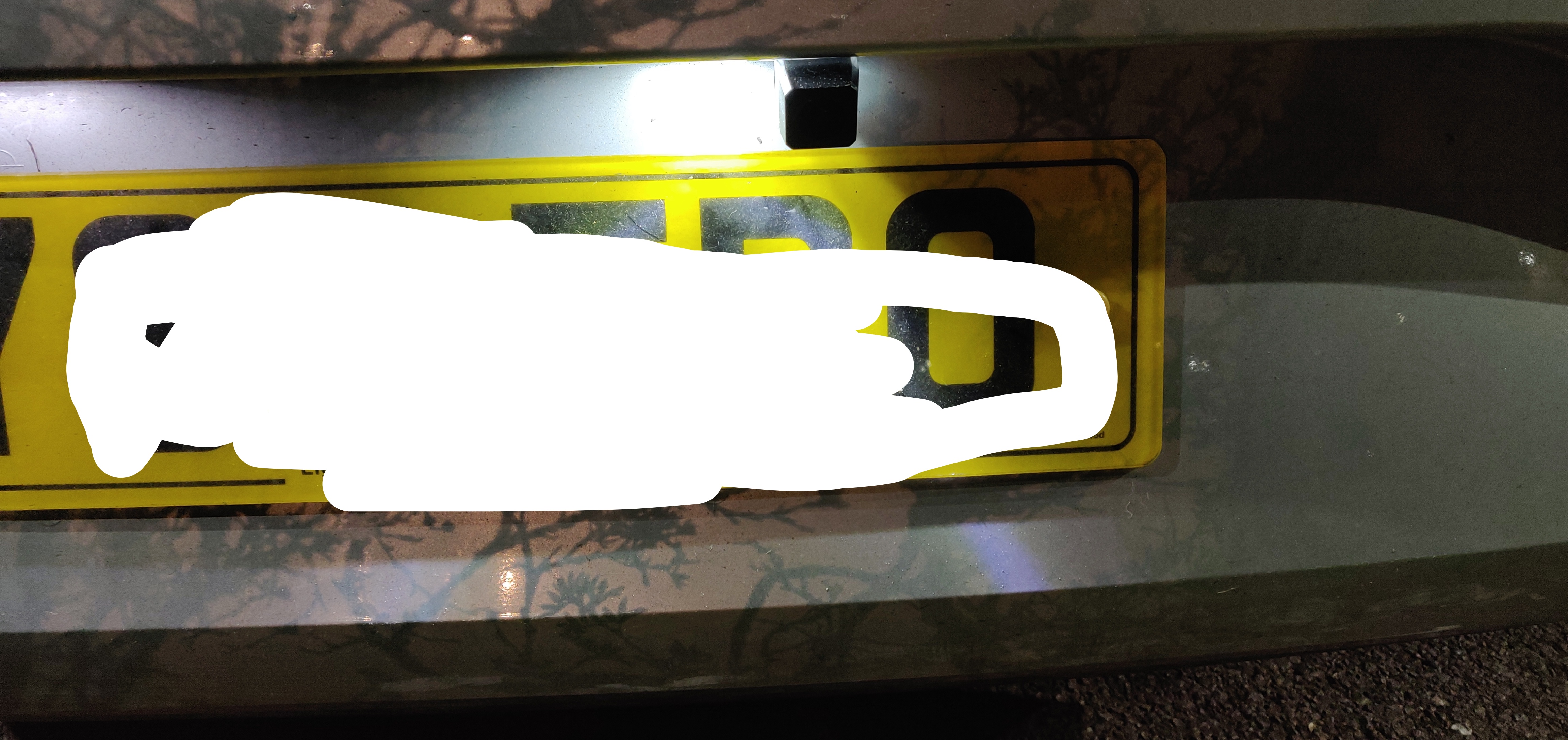

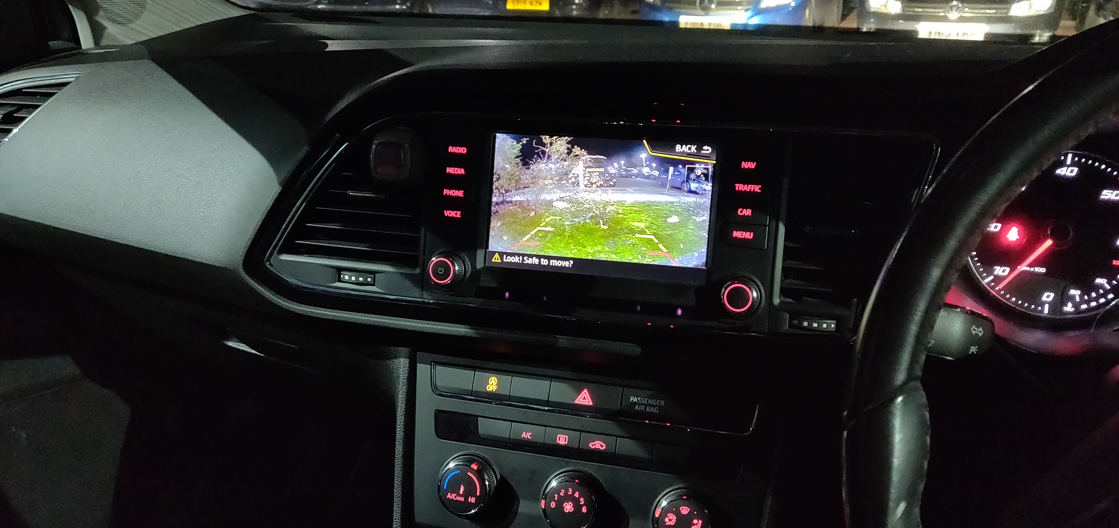

Finally got around to wiring a camera to my ST, I used an Ampire KC802-NTSC camera and powered it using the relay method. Havnt actually mounted the camera yet, but mocked it up and tested with engine on and off and it works great
Finally got around to wiring a camera to my ST, I used an Ampire KC802-NTSC camera and powered it using the relay method. Havnt actually mounted the camera yet, but mocked it up and tested with engine on and off and it works great View attachment 10799
I was planning on just using a cheap Chinese camera but that picture quality is so much better. Might have to get an Ampire one now.

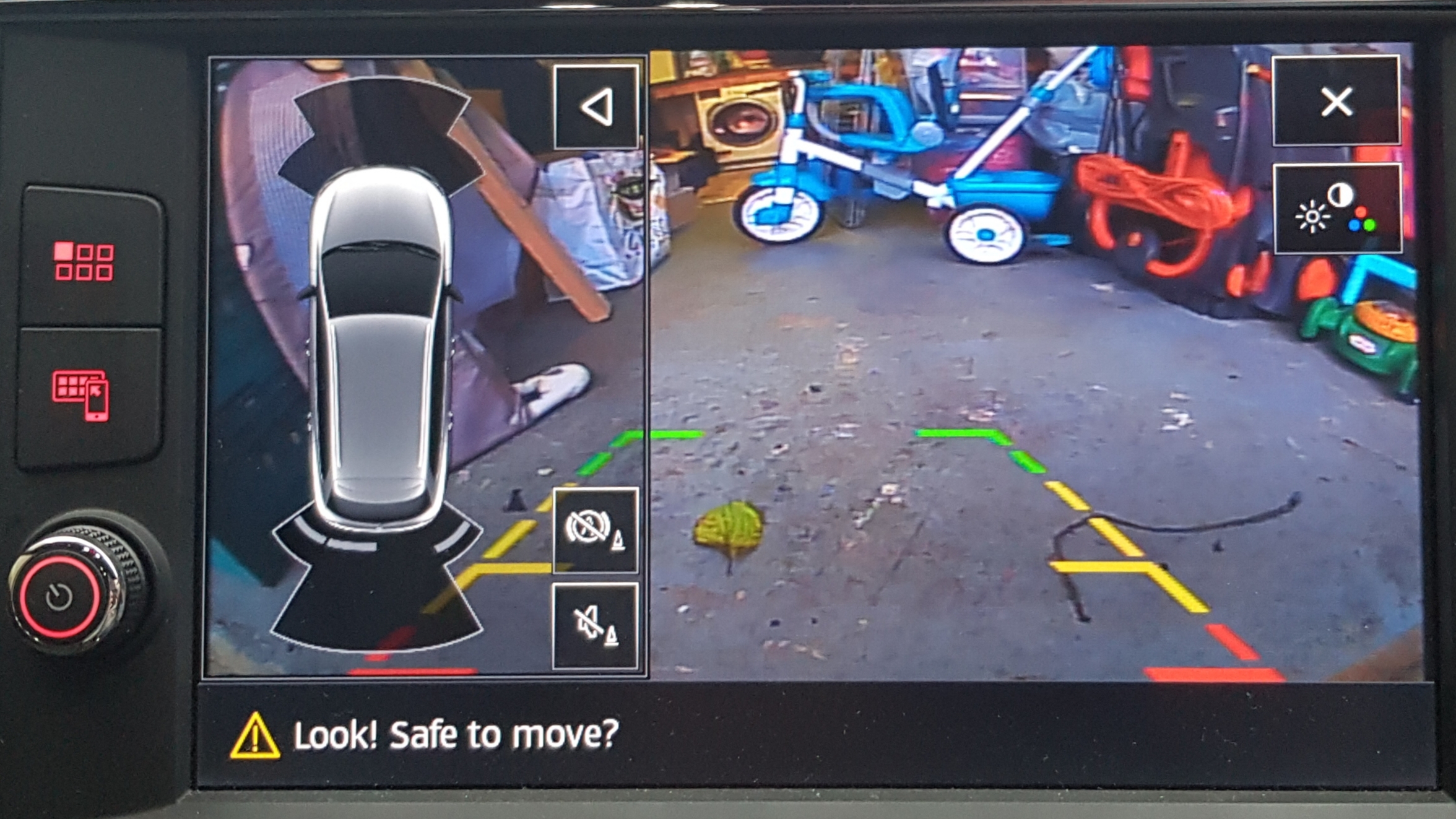

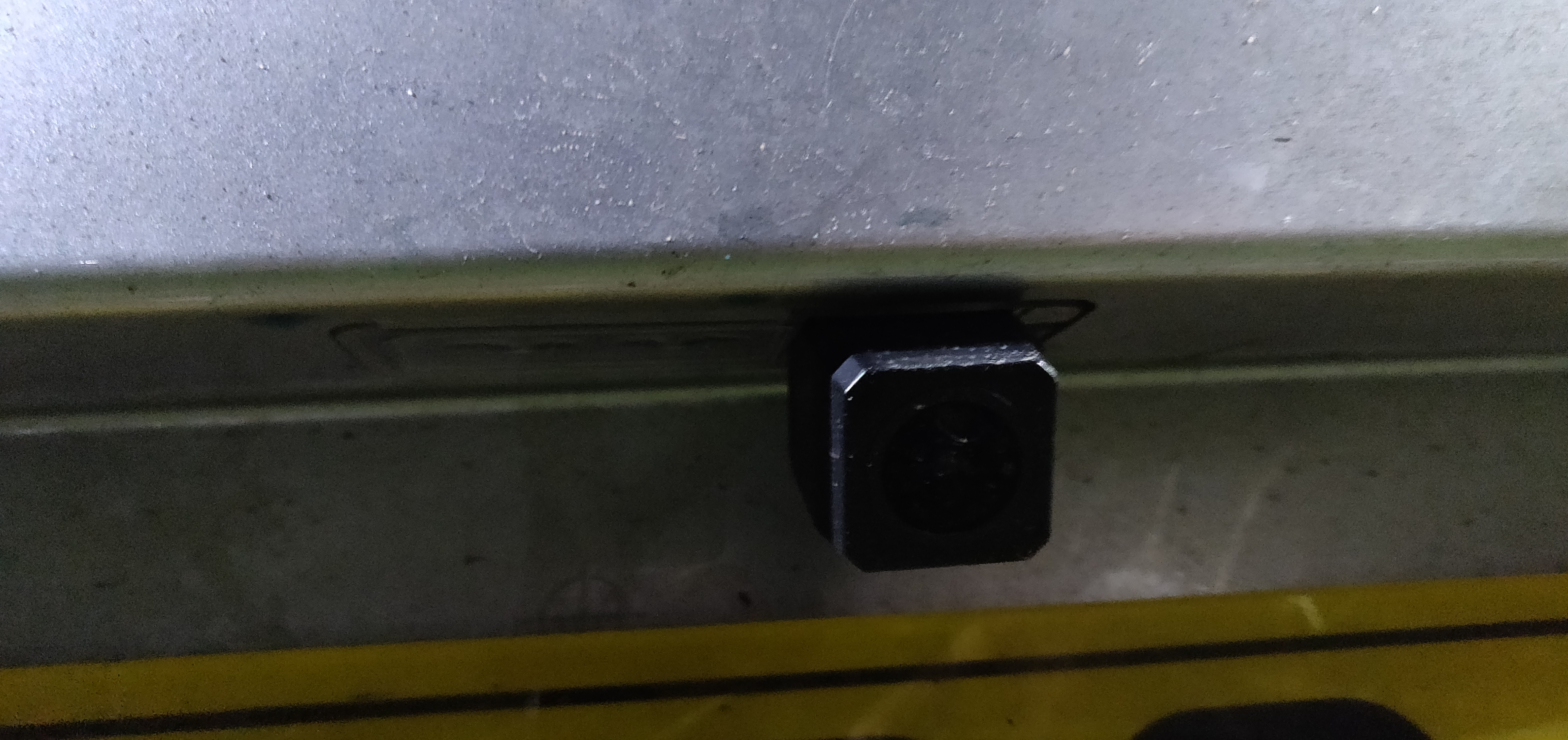

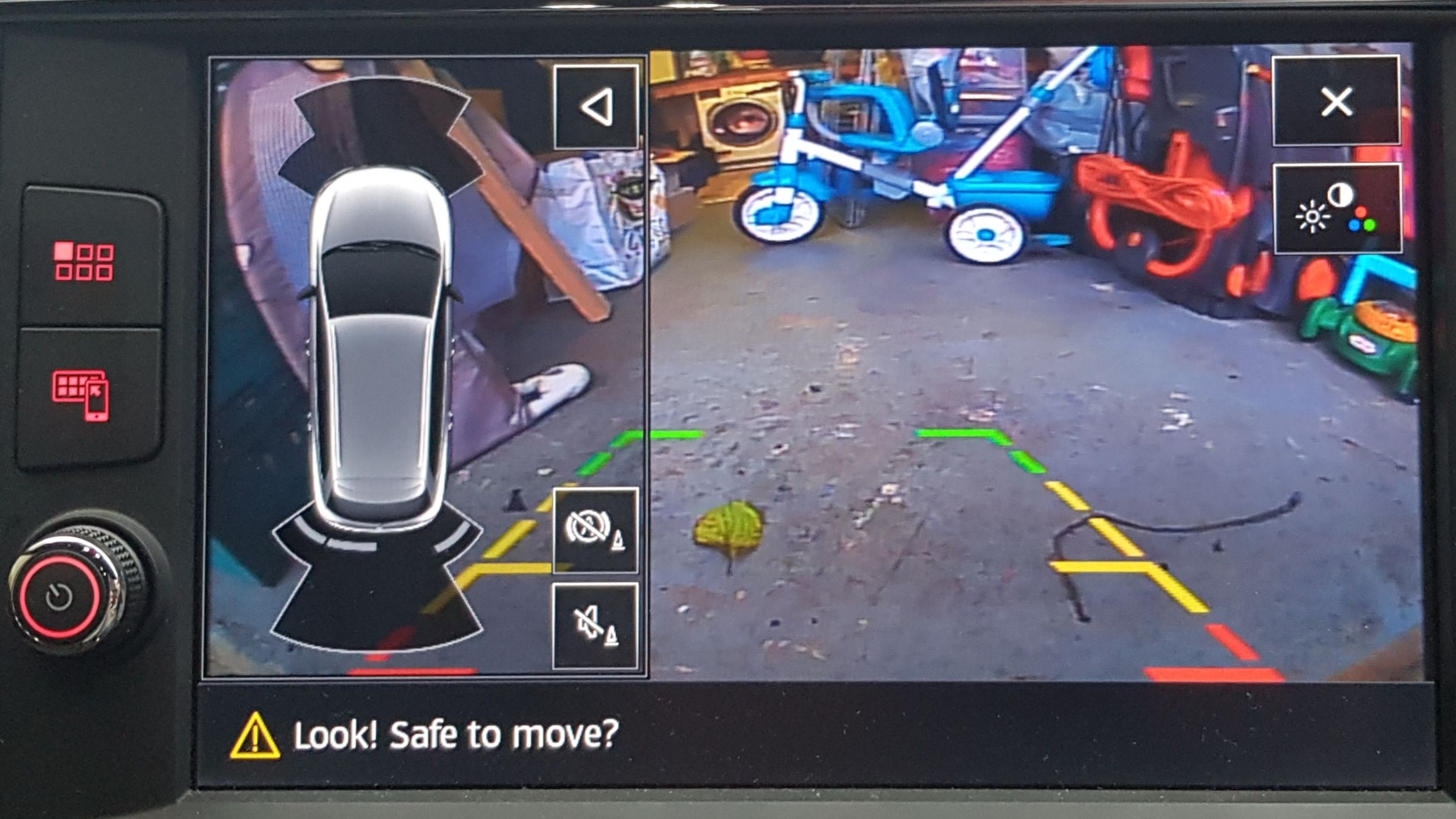

Hi everyone and thanks for the really useful information, I have managed to install the reverse camera ( number plate one) successfully. Let me know if you need any information. Sadly I forgot to take any picture during the process. The car is Seat Leon MK3 tech pack 2016 1.6 TDI. I will upload pictures later.

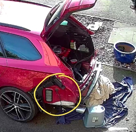

Just remove the rear bumper, you will see some flaps on the sides and you can guide the wire through it (a just lift the youcarpet to the side and you will see the flaps there) then you will be able to connect the camera. Add some zip ties to put the cable in place. Hope this helps and hope this is the way to do it ( this is how I have done mine). If cable is long enough I think it will be even better to run it through the original grommet where the original cables run through to the outside of the car. Best to wait from some expert advice from more experienced members.

finished the job today. I connected on the blue/black wire from the boot, close to where the 12v socket is. it was mentioned here before that left hand drive cars have the wire on the right. False. It's still on the left side. I haven't tested if the reverse light is providing good power for the camera, I went directly with a relay and got the "good" power from the 12v socket.
I used the same wire path with the parking sensors to exist the car.
What I discovered is that, if you have a the boot open, the reverse light will not light up when reverse is engaged.
