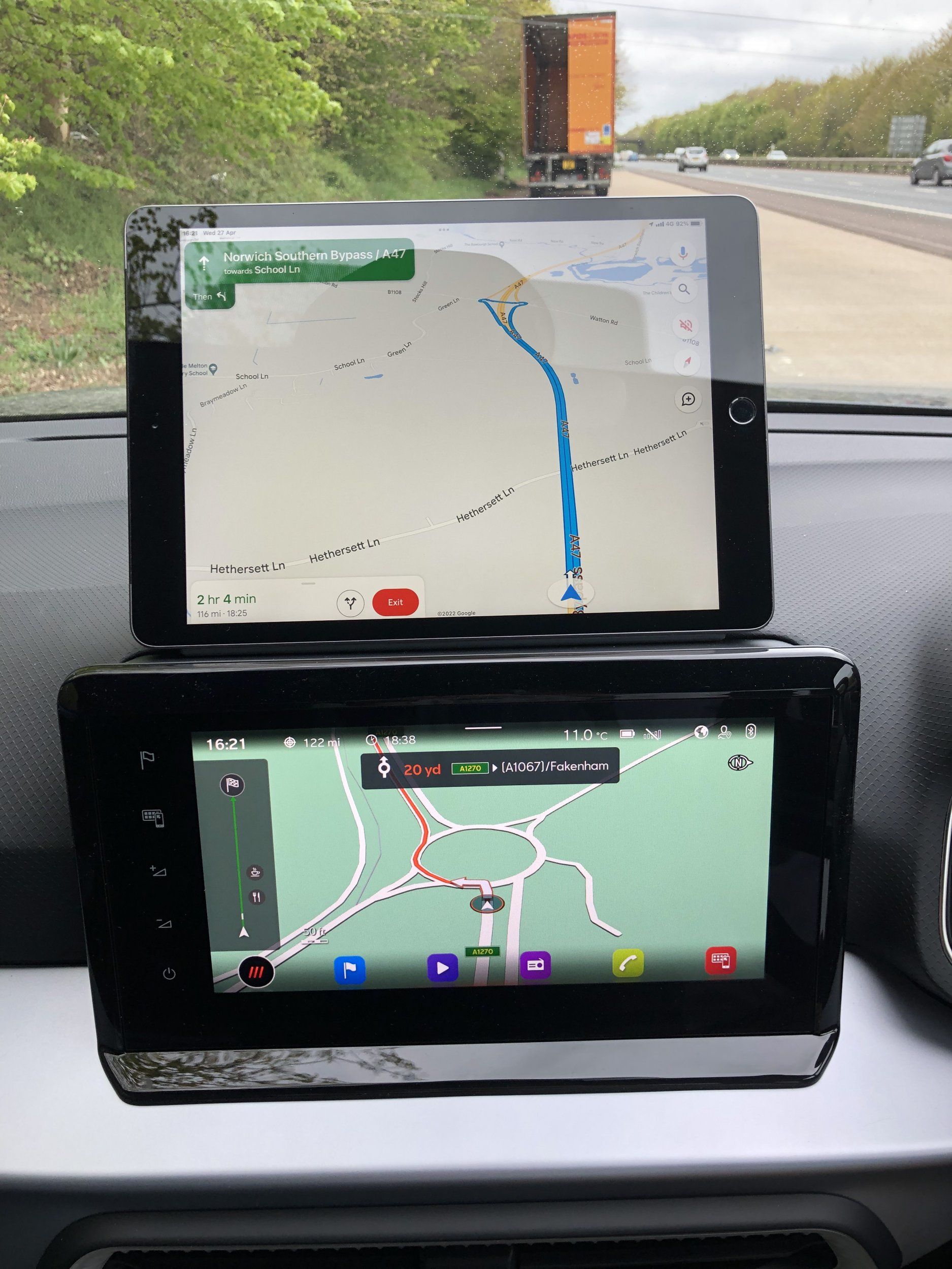

Has anyone had any issues with the built in navigation system losing the cars position and which direction it is traveling? I was 125 miles from home yesterday in Norfolk so needed to use navigation to get home. My default navigation is Google maps so before I got in my 2022 Arona FR Sport I set the route but as soon as it connected to the car it then showed my location in a different area and then showed the car moving in the wrong direction when I started driving. I disconnected my phone to use the built in satellite navigation system but found it was the built in system that was the problem my phone then showed the correct position again so I connected it back to the car and it showed the same position that the built in system showed. I disconnected my phone again turned the car off and on did a hard reboot of the infotainment system but it still hadn’t a clue where I was so had to use Google maps on my phone without connecting it to the car. This has happened a few times since collecting the car less than 3 weeks ago so pulled into a lay-by and took a picture of my iPad that had Google maps running above the infotainment system as it showed the correct position. It seems to be very random when it happens so wanted proof to show the dealer so they don’t keep the car for a day to say nothing is wrong.

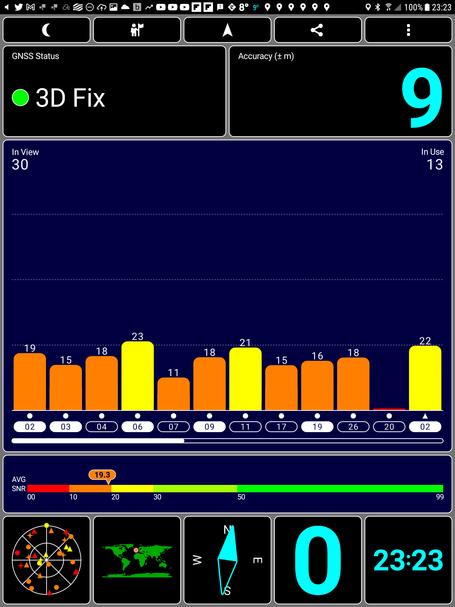

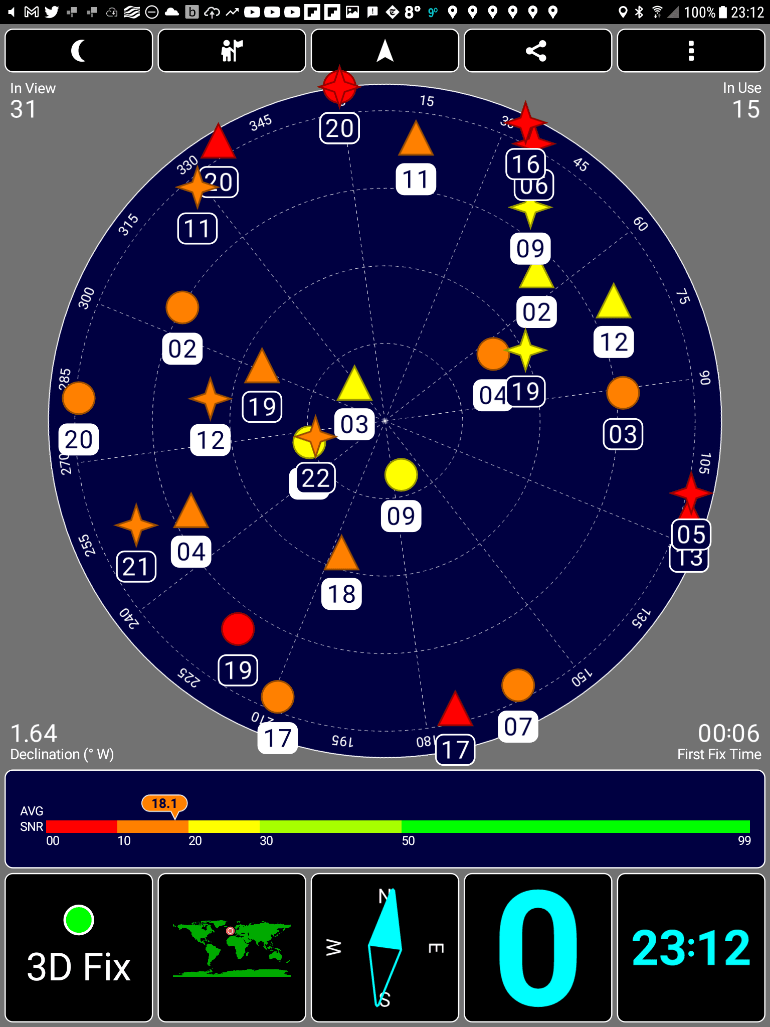

Armed with this information you can do some tests yourself. There are apps about. Since you have the issue on the phone in the car you can do your own tests using your smartphone. The Android app GPS Test shows some assorted information:
Top right show's its locked onto 15, can see 31 (indoors). Now I bet if you plugged this into your car the locked on satellites would fall when you have the problem.
These apps also provide the assessed accuracy on the locked satellites, +/- 9 metres on this example and the constellation it's using.:
Apple store apps for similar:
I'd experiment, standing outside the vehicle with the unit switched off (may be the 20 minute power down of the car). In the car, not plugged in. Then again switched on, not plugged in, plugged in etc. To see how the lock and accuracy changes. You can also get these GPS Test apps to put you on the map so with any luck it will show you not where you are 😨.
Well it’s still not fixed after spending 6 hours at the dealers yesterday, they gave the car back saying they had updated the software and couldn’t get it to go wrong but told me to bring it back if it loses position again. Within a few hundred meters it went wrong again so I went straight back and then took the master tech for a drive to show him. He asked me to email the picture that I posted on here so he could send a report to Seat UK as he hadn’t come across this issue before and said that he has asked if he can replace the GPS antenna that is under the drivers seat. He said he will get back to me when he has an answer.
