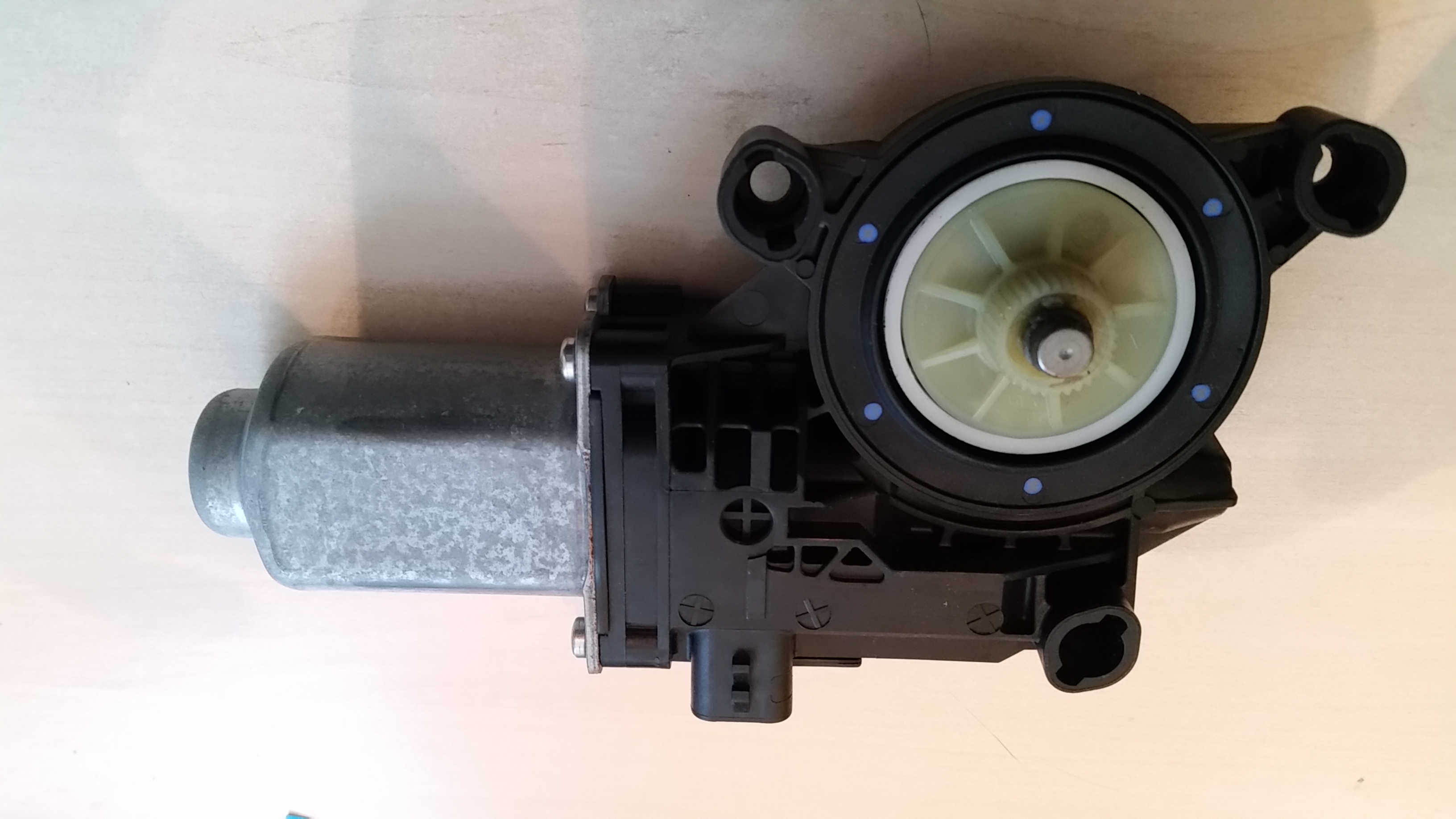

It's the combined window winder motor/controller. I know I've replaced 4 including one twice.
Thank you for the pics provided!
Do you have any reference price you paid for the front+right left sides replacement parts? As you mentioned to have replaced 4 of them...
Here is one I have replaced. The part number on this one is 6R0.959.801.B. I would advise you remove the old one and check the P/N before buying a replacement as left and right sides are not the same and some go up for down and down for up.
I bought second hand replacements off eBay for about £35. Removing and replacing door cards is a pain but there is a "how to" on the forum. Good luck !
The images and the text were meant to be part of the same reply but I'm sure you get the idea.
