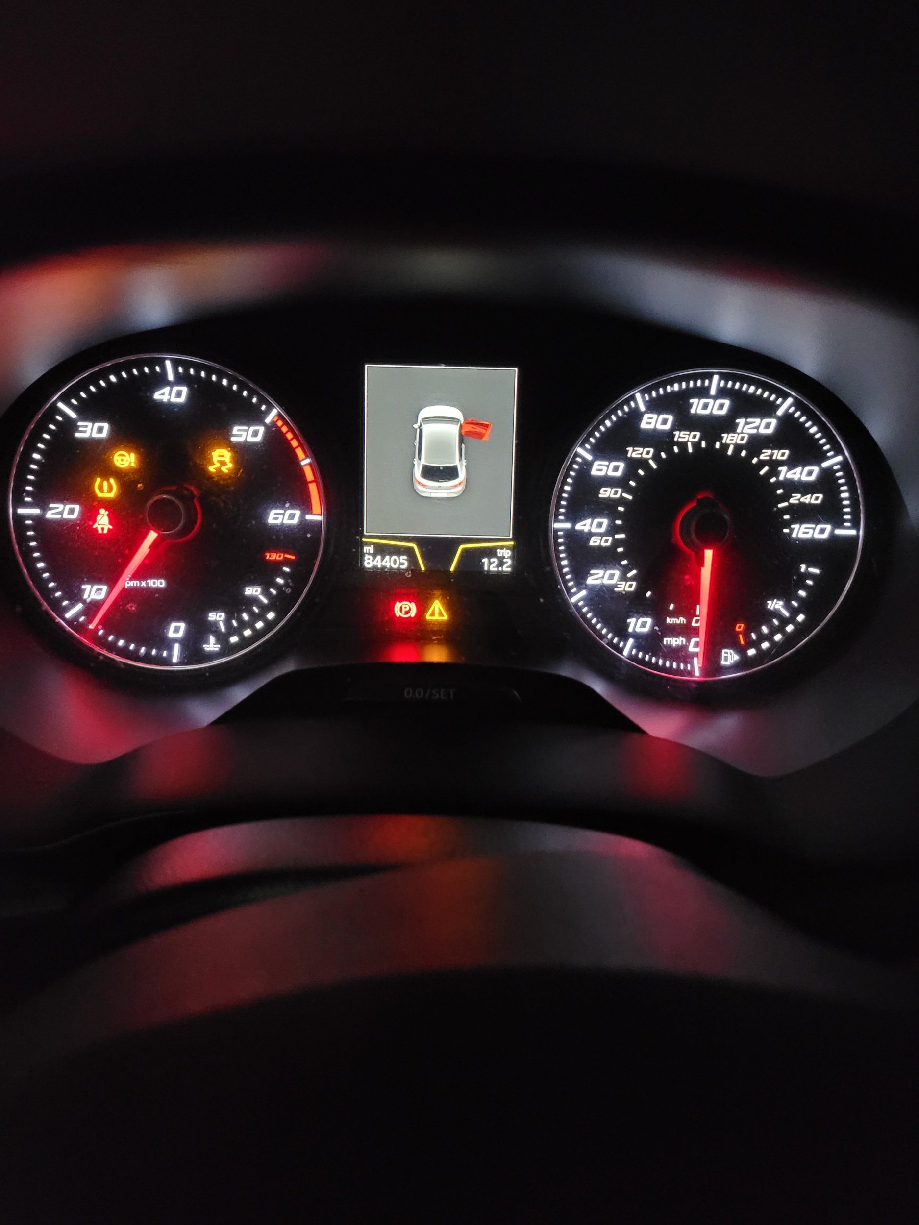

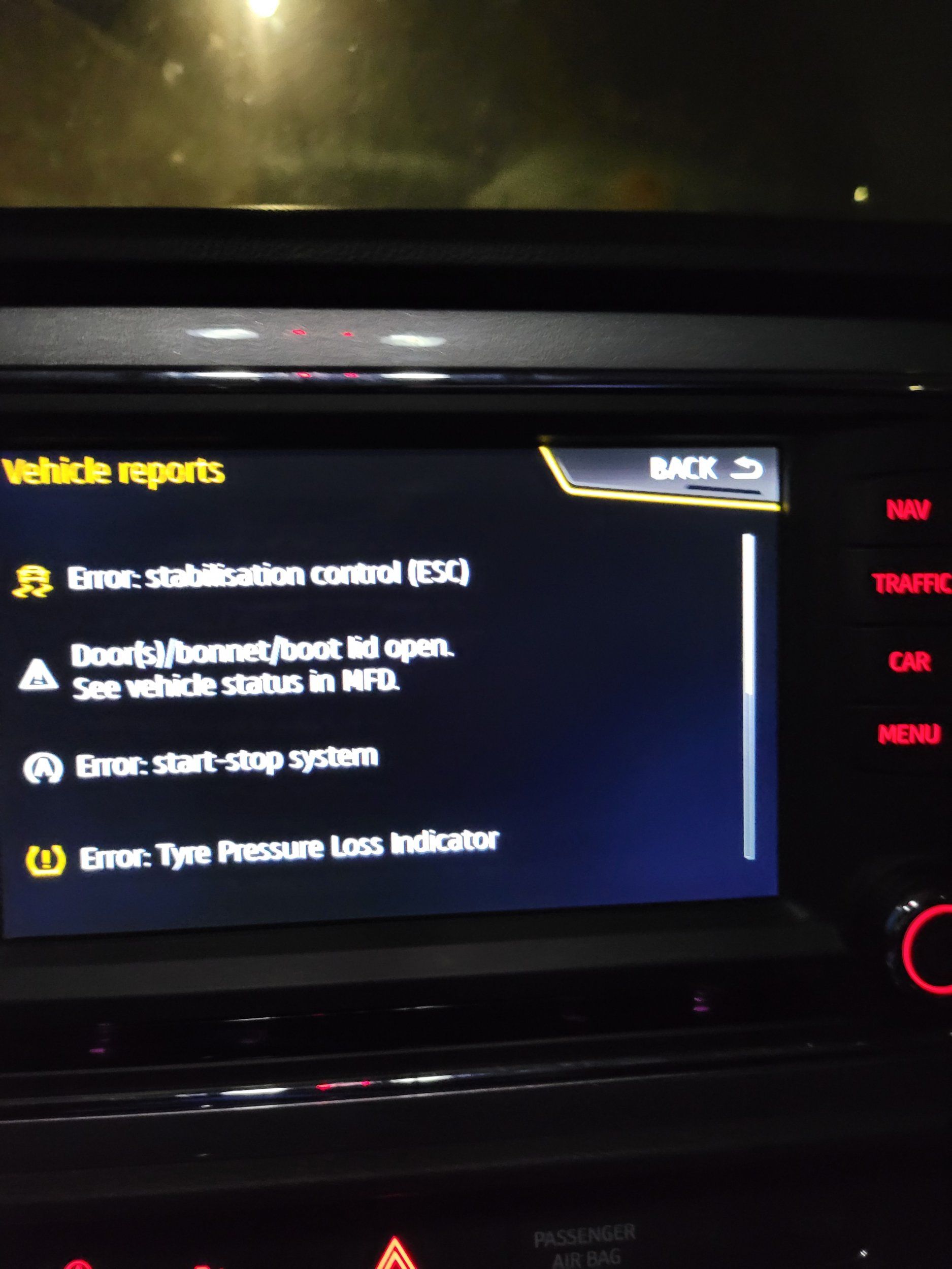

hi guys abit of an update so i have had the replacement installed in the leon and the mechanic that did it tried coding it but didnt seem to work (using snap on computer and a vw program he has) so the steering rack is working fine but i now have lights and errors i am guessing due to lack of coding. i have attached the pictures. does anyone know of a good mobile vw specialist that has capability to code the rack with vw mainframes (if thats what it needs) for a good price and can get to wembley.
