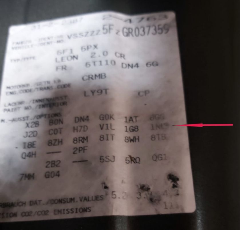

guys thank you l so much for all the responses i am going to look for the sticker in the boot do you know where i will find the sticker??? and i am in northwest london do any of you guys have a mechanics that i can take the car to that could also do the programming and fit the part for a good price ?

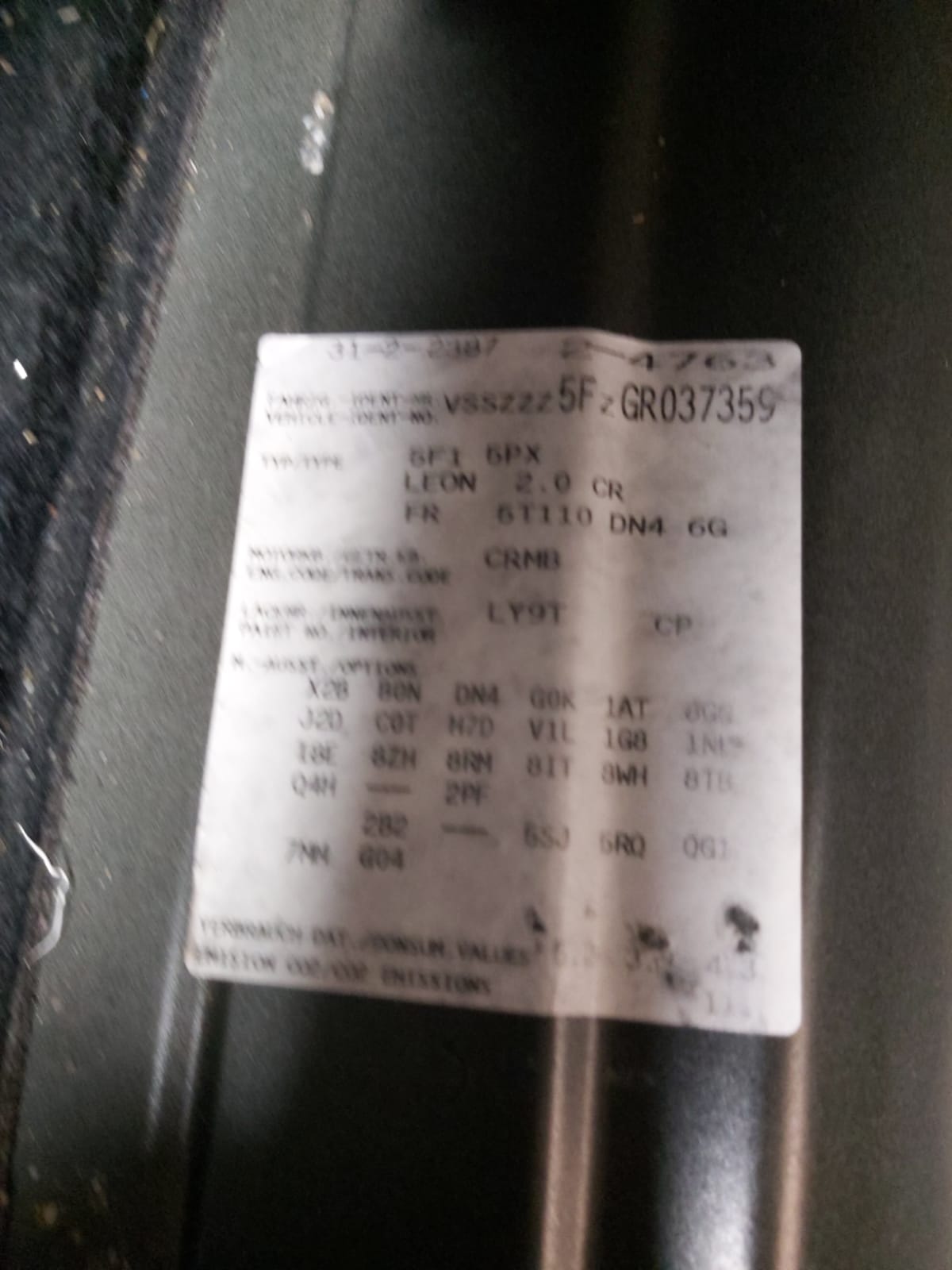

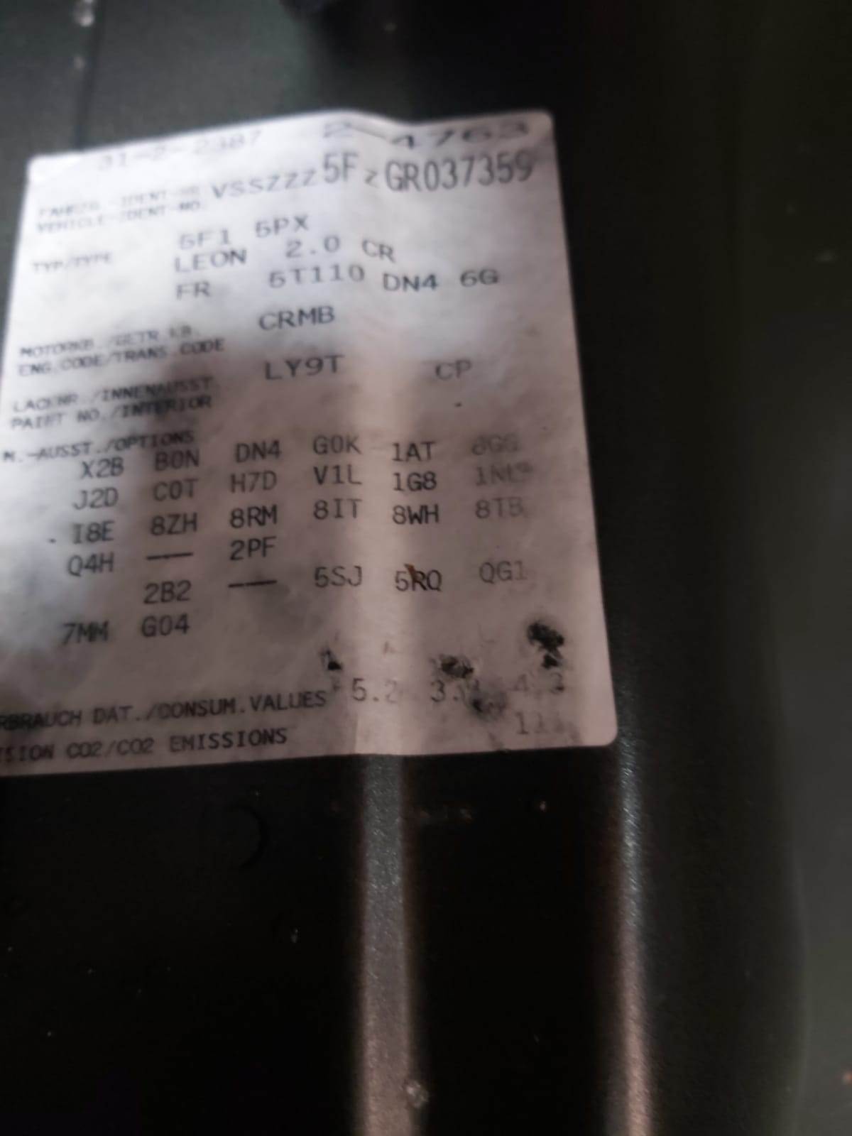

hi guys i cant find the number so attached a picture of the white sticker. any help would be much appreciated

hey guys dont mean to be bother you all but i posted the picture of the sticker in my boot can someone who actually knows how to use the part number checker provide me with the part number i need. thank you in advance

It might help if you posted a photo that is in focus!
The number you're looking for should be on the RHS, a little over half way down. It looks like it's there in your photo but it's impossible to read.

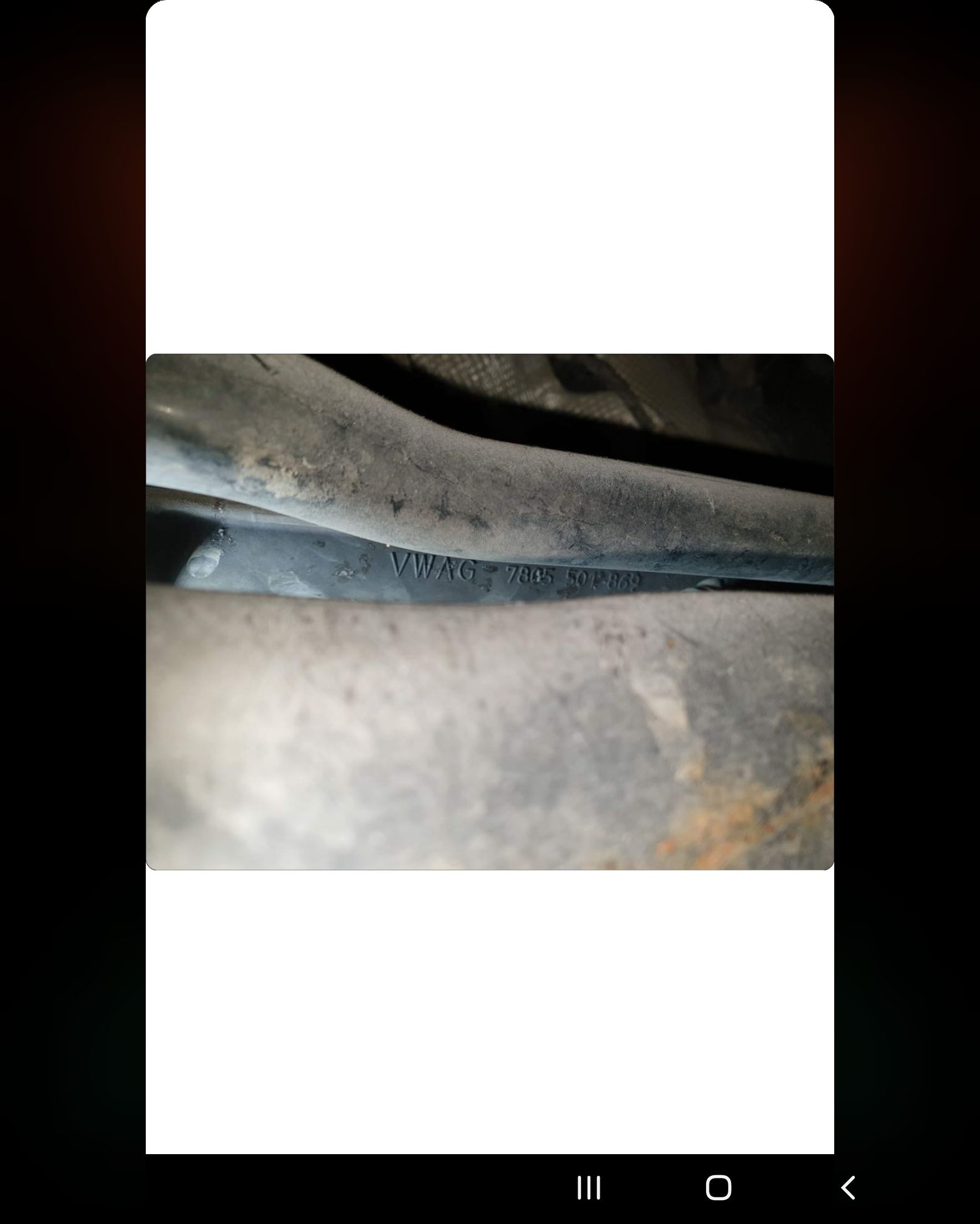

hi guys i had a loom under the car myself and took a picture of what i think is the steering rack part number can anyone confirm if i have got the right part number

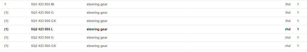

From your VIN number it also lists PR code: 1N3
and then the part number for the steering rack as 5Q2 423 055 L
I would still do your due diligence - and call a Seat dealer parts dept, and ask for a price and part number for the rack linked with your reg to 100% make sure you are getting the correct part number.

The photo you shared wasn't the rack part number. The part number will probably have a QR code next to it on the label.
I believe that part number I shared is correct but it's relying on the part catalog I have access to (it's a none genuine one - but can do VIN look-ups) - but I can't confirm 100% - for your car - so If I were you i'd try and double check that part number from another source.
If you search google with that OE number you can see there have been loads of iterations/supersessions of that number (different letters on the end) and L is the latest.
