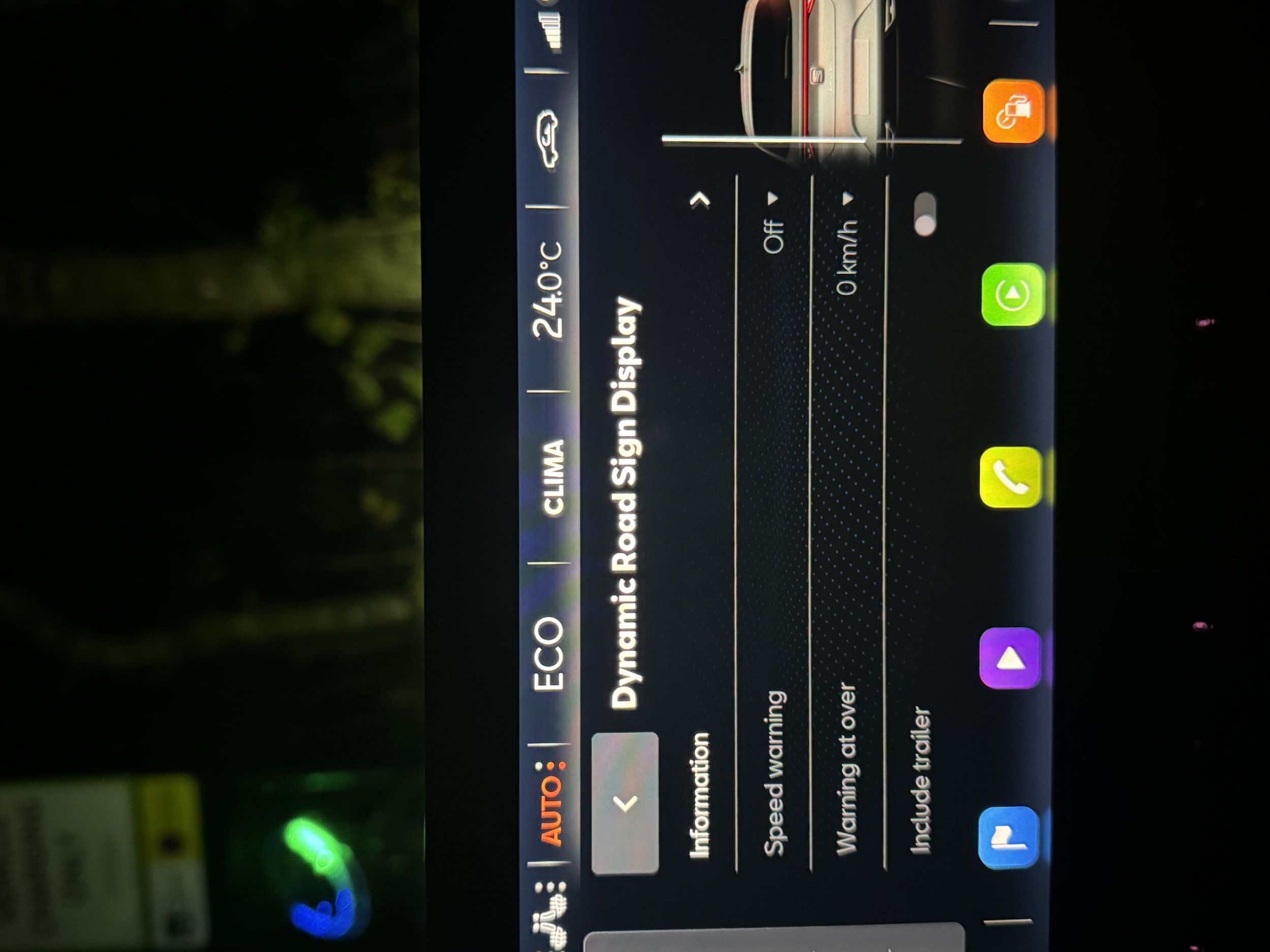

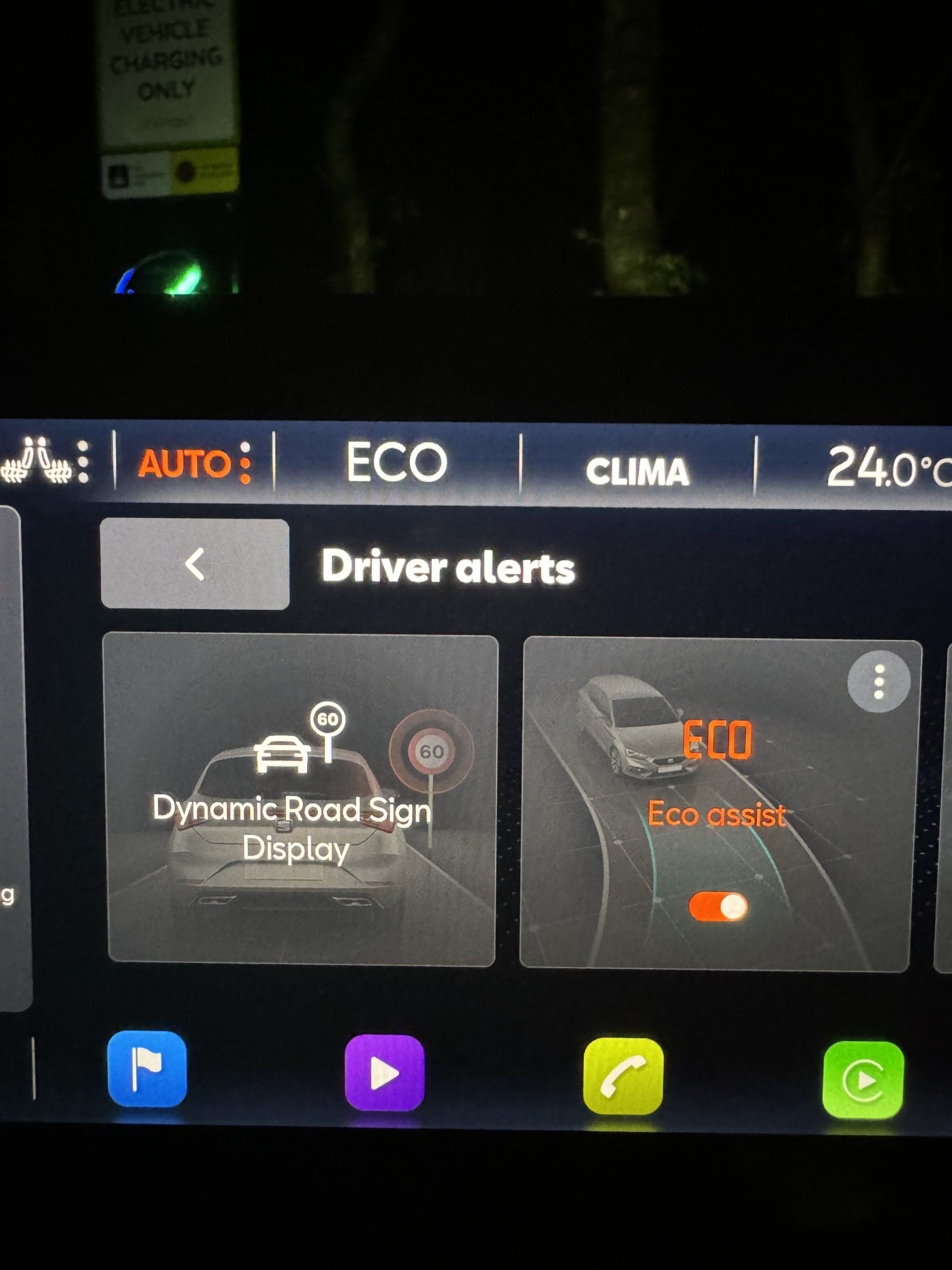

I am trying to enable TSR on my 1.4 eHybrid Leon FR Sport.
It's a UK model, and has the Lane Assist camera.
I've managed to follow some steps from an older post, which did actually work and I now have the setting in my infotainment system, however all the options in it are greyed out as shown in the photos attached. The only step I haven't managed to change is the fusion mode. I get an error when trying to access this section.
Any ideas on what I can do to get it working?

From what I have seen you cant code it anymore, its SWAP/FEC so only done by retrofitters or SEAT

It's protected, it cannot be activated simply via coding. The necessary license to activate isn't officially available and the unofficial routes cost in excess of £1k
