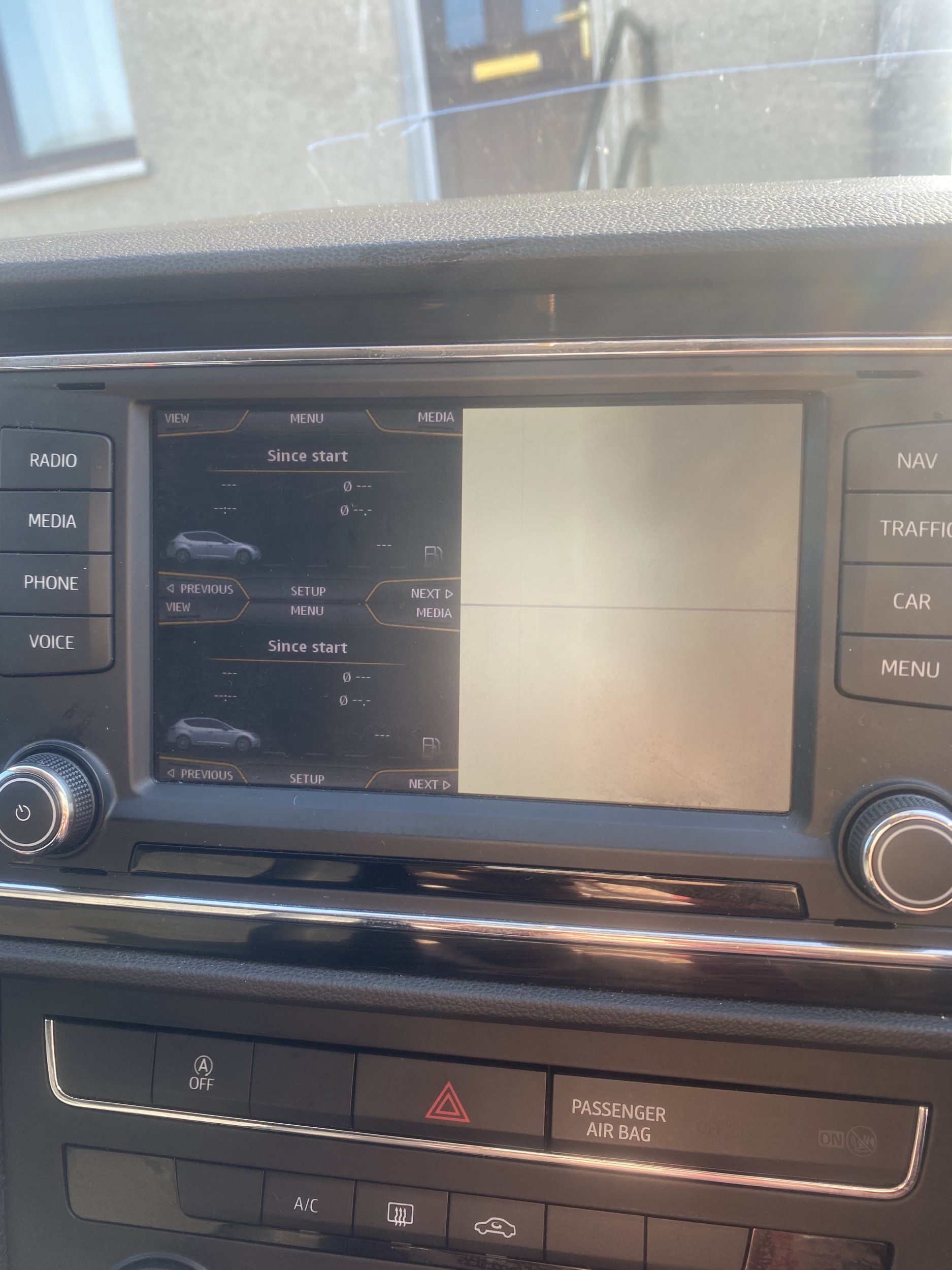

Hello, I’ve just bought a second hand seat Leon 2015 tdi with the tech pac. The touch screen isn’t working on one side so it’s double on the other side I can still use it but obviously it looks stupid. I’ve been getting mixed answers on what I need to buy, is it the media outlet under the glovebox? Or a new radio?

No it’s not enabled there seems to be a line going through the main screen but the left hand side is fine. Been told to replace the media under the glovebox but I would of thought replacing the screen would solve it
Normally this happens when the wrong screen is paired with the MIB unit in the glovebox. Example, 6.5/8 inch screen fitted to a MIB1 unit
Check your system information for device number
Device part number is - 5F0035858A strange because I’ve had this car before and the screen was the same size on the larger side as I know some are smaller. I don’t know if it’s the media unit under the glovebox that needs replaced or the screen?

That's the number for the MIB1 unit, for it to work you'll either need a 5.8" screen with CP removed, or a MIB2 unit for the glove box, however this will need CP removing and then coding to your vehicle.

What device number should the new screen have? Seems easier to just get a new screen then upgrade to the MIB2. I’ve gave that page a message aswell thanks ??
