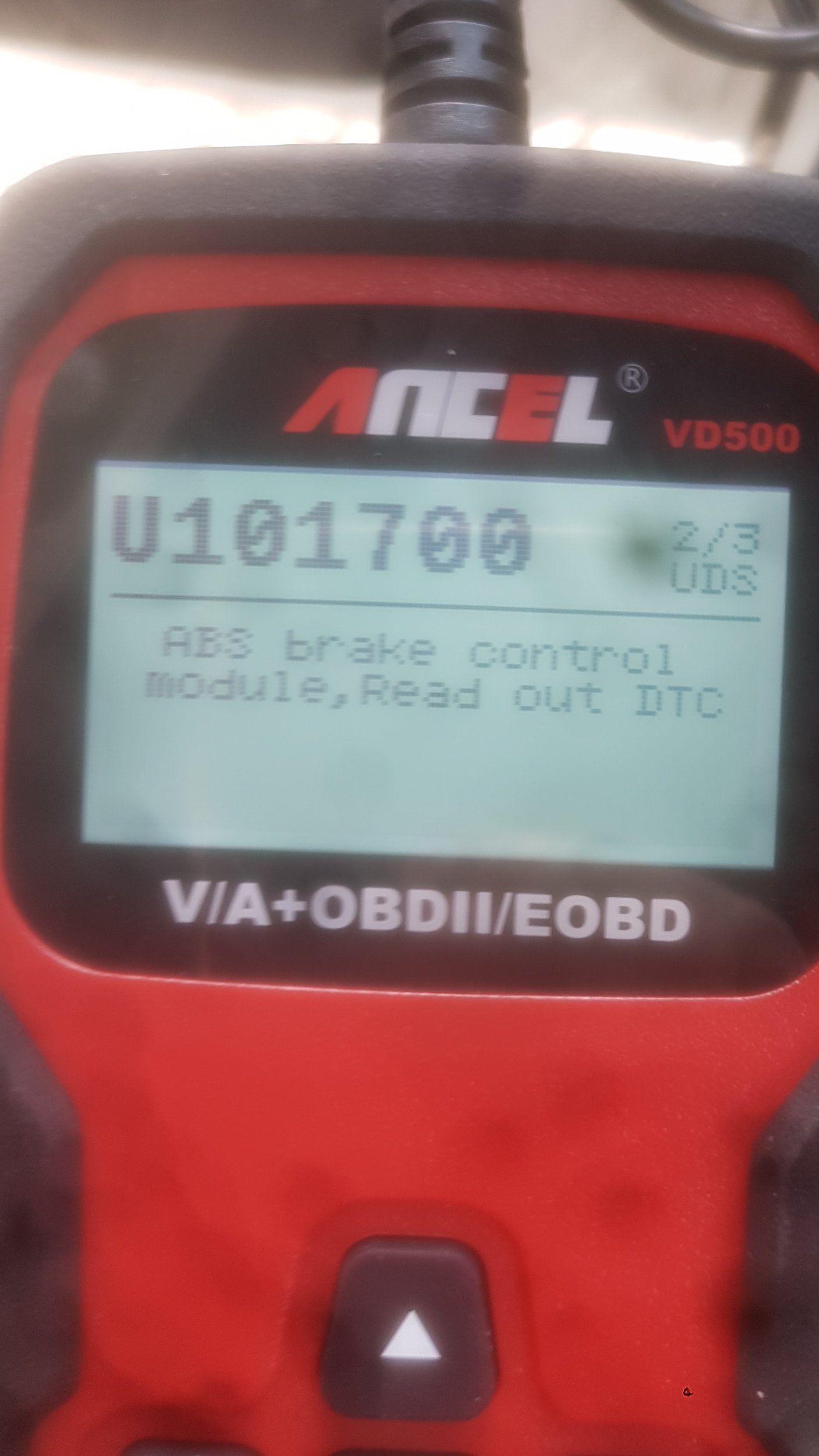

Since then I can't connect to most of the modules on my Car. I try plugging in my diagnostics tool and it doesn't connect to some modules often. I tried with my small 50$ machine and the pro 2000$ VDCS cables. Both can't connect sometimes. Can gateway returns 9 errors which are the same as the second picture I uploaded. It lacks communications so all warning lights come on. (Engine, ABS,Transmission, steering angle,anti theft( which makes my car lock and unlock continiuously while driving, which is omega annoying). (Engine also gives an error "Can't connect to gateway A")
