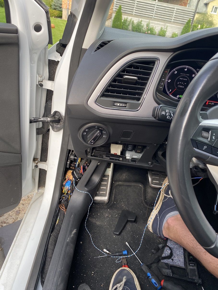

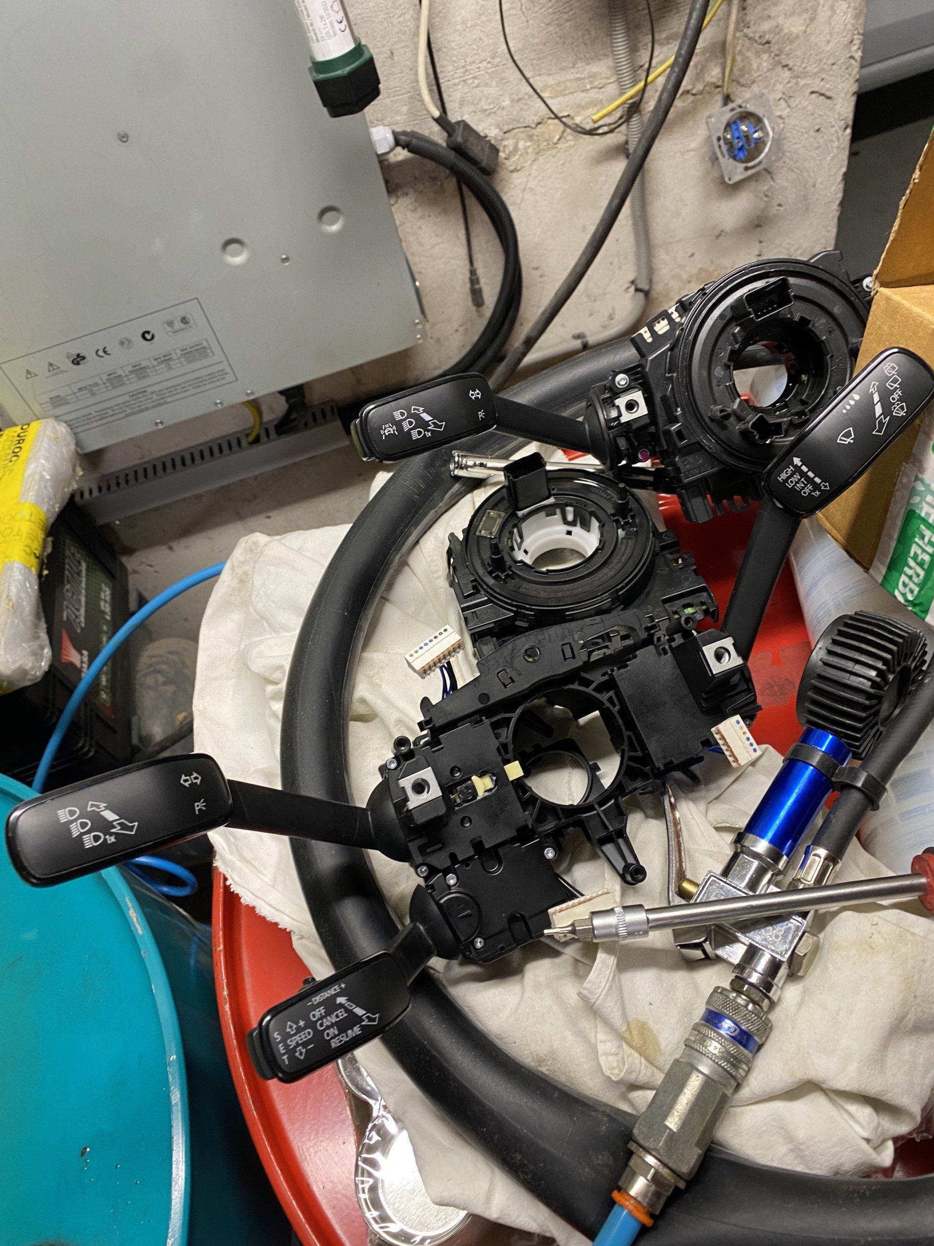

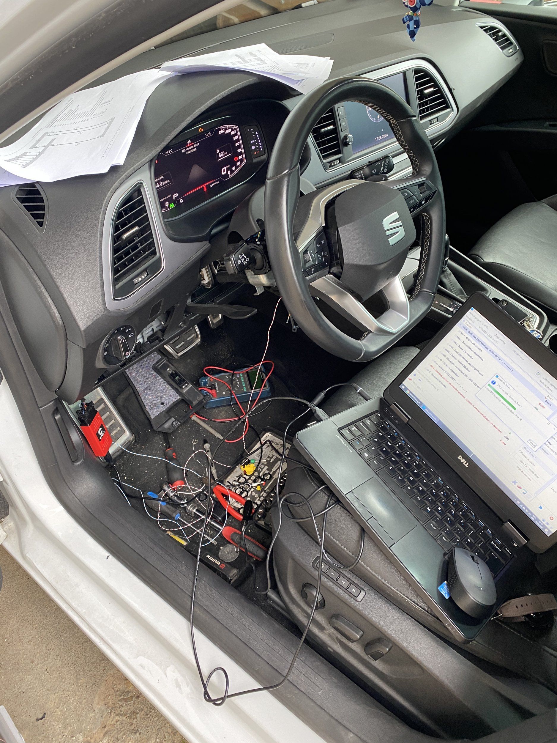

Today had succesfully retrofitted 5Q1 steereing column electronics module from Golf 8
As I mentioned before at the end I had 5Q0 module from Škoda, but there was problem with stalks and so on, and I wanted original stalks back and also had 5Q1 steering module leaning around which was bought by mistake.
I got 5Q1 module from Golf 8 - 5Q1 953 549 F, with heated steering wheel option.
I repined it using Golf 8 diagrams as I got it from Golf 8, and You never know. Also as I had Skoda Kodiaq 5Q0 module installed before, I will not write from which pin to which I pinned wires as wiring already was not like from factory...
Repined connector now looking like this:
Pin 1 - Red/blue(Positive from fuse box for heated steering wheel)
Pin 4 - Brown (GND)
Pin 5 - Violet (LIN from BCM - T73C/54) [This I was missing, as did not have this wire at all]
Pin 6 - Red/White (Positive from fuse box)
Pin 8 - Brown (GND for heated steering wheel)
Pin 9 - Yellow (SIG- from AirBag module)
Pin 10 - RED (SIG+ from AirBag module)
Pin 11 - Black/white (SIG from engine control unit)
Pin 12 - Violet/Blue (LIN from Gateway)
blue/violet wire (this one was going from J587 - Selector lever to old 5Q0 steering control module) this need to wire to BCM T73c/24.
Leftover Can High, Can Low just take out or isolate
And from beginning I did not have black/green, black and violet/red (this I was needed), so not sure to which diagrams to relay on.
Coding is done trough Adaptations in 09 module under "SMLS" adaptations.
Also in Adaptations > Lenkstockschalter > Verbauort Lenkstockschalter, change from CAN to LIN
And finally it works.

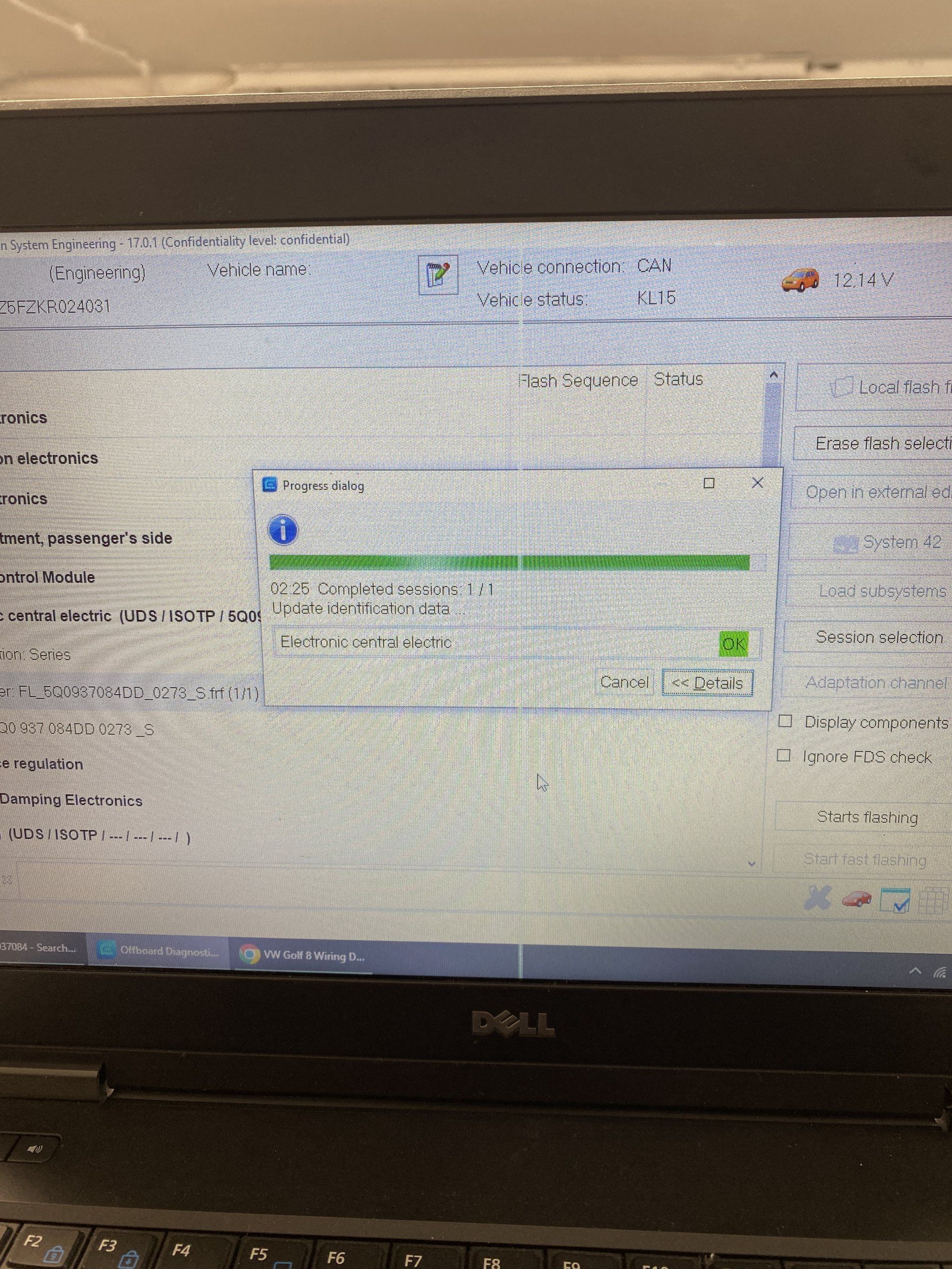

Also as I struggled to get steering module connection with BCM, because I did not have LIN wire from BCM to Steering control module, I updated BCM software to SW 312, 5Q0937084DH, also dataset was updated for this version. Seems that Adatpations left untouched, and was not needed to do them.
At the end found out that I do not have this wire, I bringed new LIN wire from BCM - T73C/54 to Steering module Pin 5.
