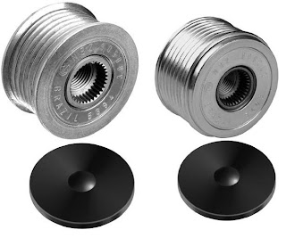

have you got a pic of it btw? which pulley is it?
Yes, please post a pic of the offending part!

They look like this
yeh, i thought it was that. which one did you replace? the top one? mine's all clean too, but you can see it vibrating loads when under stress.. probably got loose while driving on the knackered damper

Thats what i was looking at too! Thanks for the pic!
