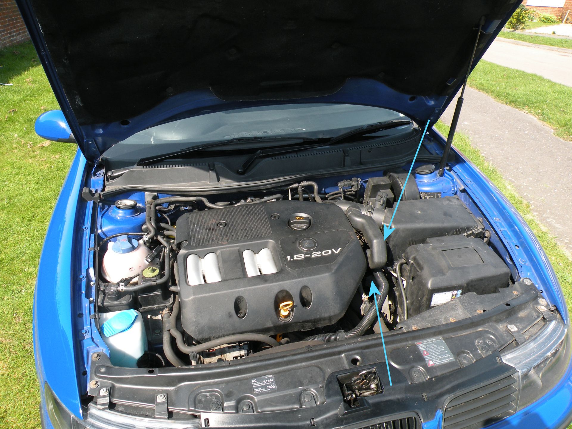

OK so if you are looking down on the engine block, on the right side between battery and block you can see the gear change levers on what I assume is the gearbox? to the rear of this nearer the block I can see a collection of pinkish fluid (coolant coloured)
It's not easy to see in this area, I have run her to temp and checked with a torch but I can't see any leaks from the very many pipes in the area.
Clearly it needs fixing but it would greatly assist my bank balance if I can point out the likely area and source to the mechanics at JKM.
Can anyone suggest a likely point of leak?
I have attached a photo showing the area.

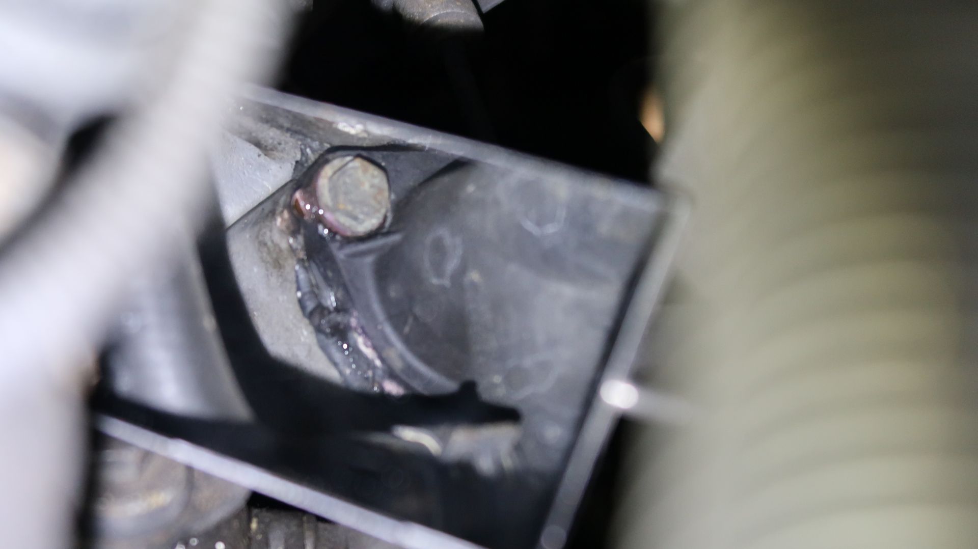

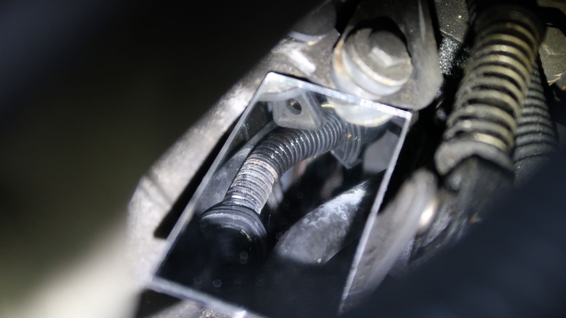

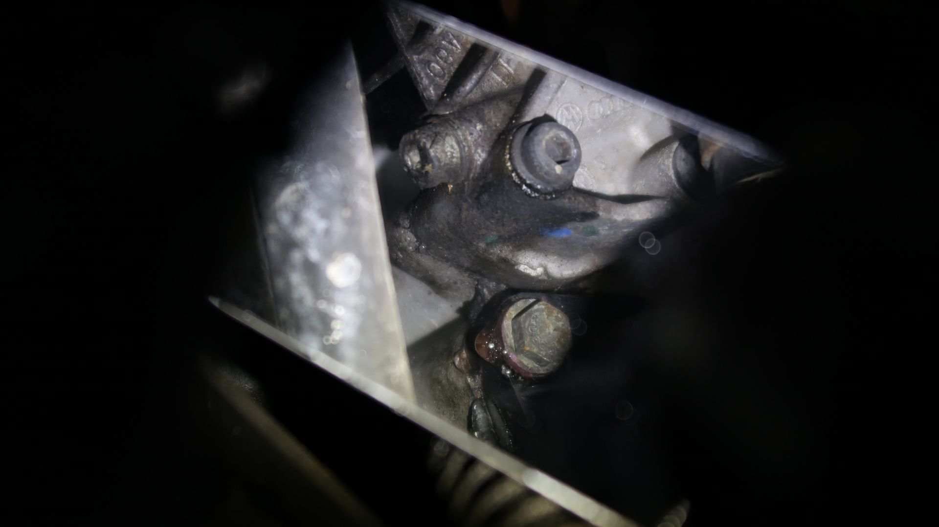

Hi guys, I got myself one of those telescopic mirrors and have found the leak!
On the right side, off the block.
Can anyone say for sure the exact location?

If its what I think it is its the thermostat housing and thats a common failure point.
Does it look something like this ?
Reactions: mikesndbs
It does a bit, really hard to see, but at least i can direct them to the leak which saves time and money?
