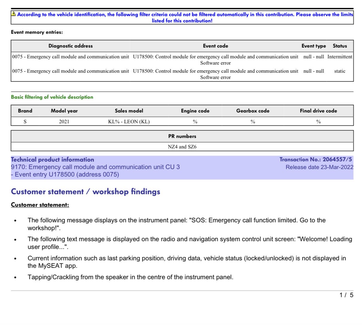

Get your car booked in to the dealer as there is a tpi fix for the sos fault.
Is that TPI 2066692/3 ?
This one. Go on to Erwin pay the £7 for an hour and put your vin in and will give you all the information on your car.
That TPI describes all the faults I have still remaining since the 1896 update. What a great find! I'm a bit annoyed that this was released on 23rd march yet when my dealer carried out the 1896 update at the end of April, this wasn't included !

Finally had yearly service done, so asked for 90T4, TPIs 2066692/3 and 2064557/5 to apply. Not sure exactly which ones they have done, but they said it was 5 hours+ of updates. Main version stayed the same - A896 (same as after OTA update).
No more SoS errors when driving locally, but haven't ventured far yet...
