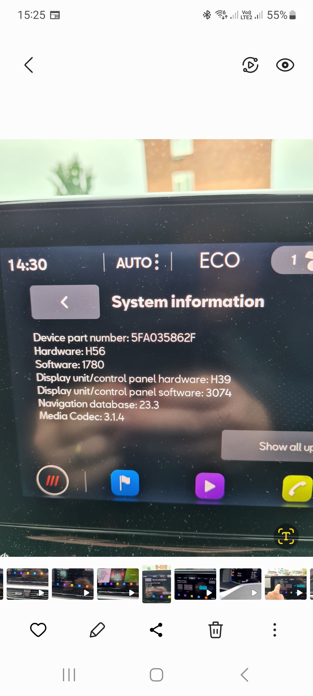

This is the data for my Cupra Ateca. Will have to wait a week or so to see if it stops SOS error. The service desk reckoned that the fix was working on the Formentors.
The issue I had with having to pair the mobile each trip as the car had lost the contact info has been fixed.

That is on mine one
Software number: 5WA035284C
Software version: 0142

I think that is what I had as they said two updates and the car was in all day with the oil change only being done last thing before they closed so seems to be a lengthy download. Certainly fixed the mobile issue. Hopefully SOS too.

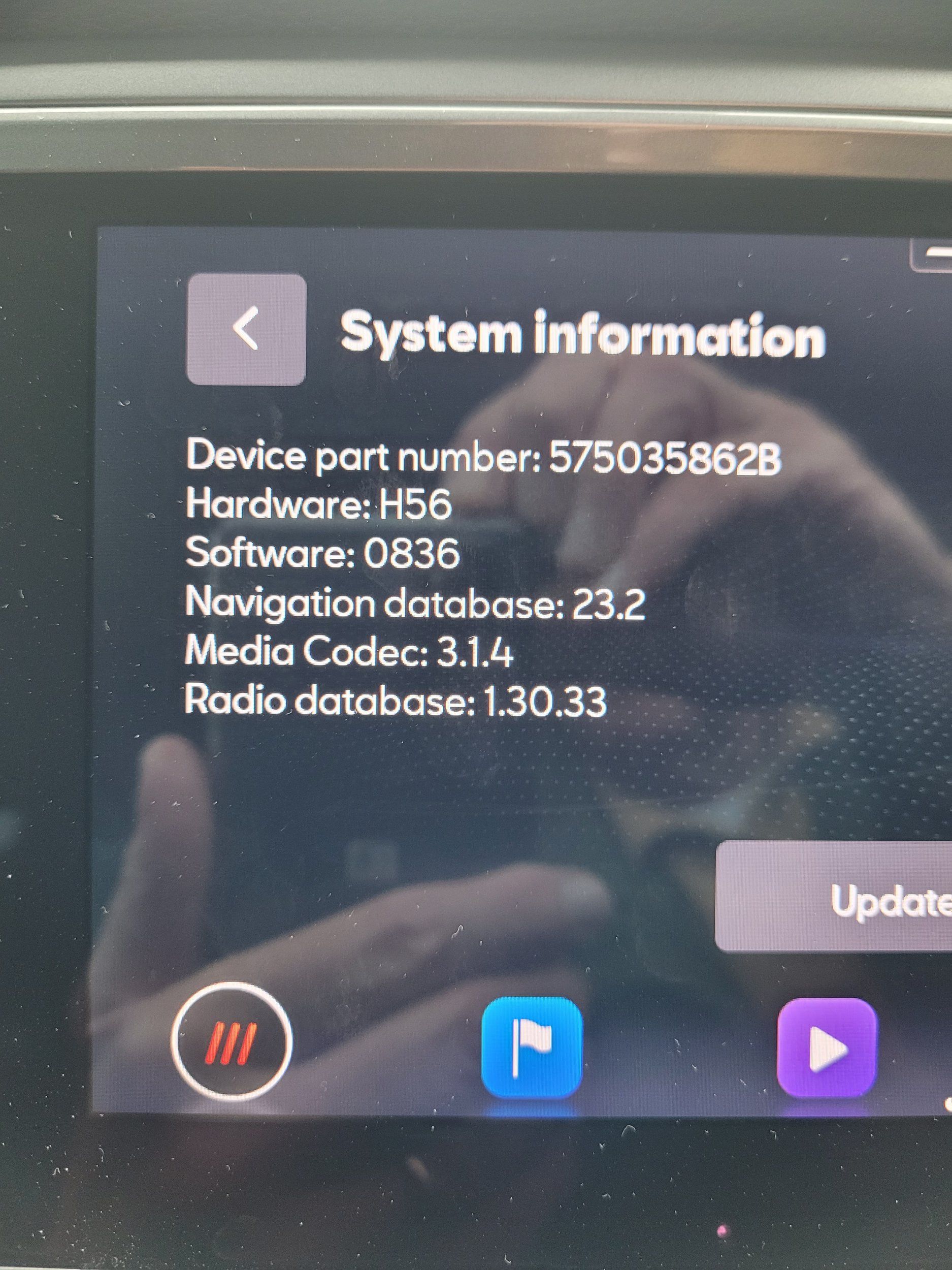

Hi Everyone.. Just a random quick question! leon ehybrid 2020 and every once in a while i hear a random noise which could be described by "popping" as you all seem to be calling it, Seat have the car at the moment doing the mat recall.
Could someone give me a bit more info on it please, also the infotainment system sometimes loses the usb and when you get in car the settings randomly revert back to what i would assume is standard settings every once in a while? I.e dash changes / driving mode reverts back to normal instead of sport etc.
Does this sound like it is running old software and needs updating?
Thanks for any replys (y)

Yes, they need to run several updates especially on car from 2020

That's a pic of my software version that I took before the car went back to seat, anyone no what the latest version is??
