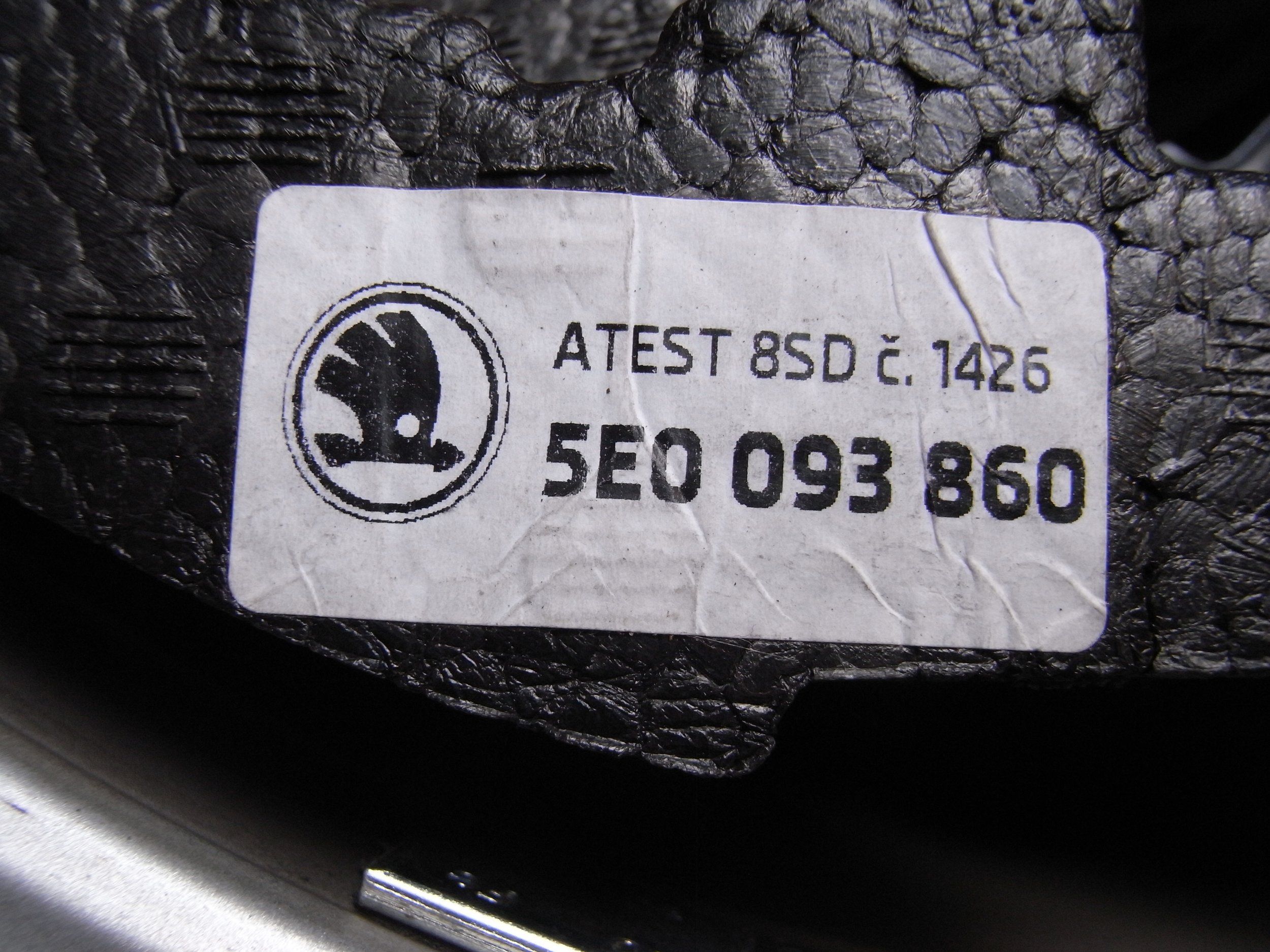

Why not buy a used 18'' alloy the same as the ones on the car? That's what I did. The ST boot will take it. Seat do not sell jack kits for the car but Skoda do. It's the same chassis so works perfectly. This is the best kit I could find as it has a better jack than most. This kit will fit on an alloy from 16'' up.

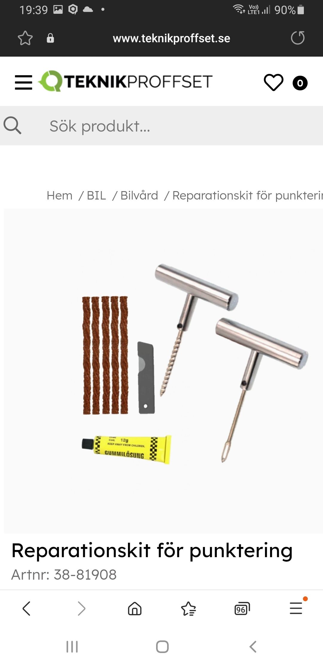

Buy a repair kit. I did to my mk3 Cupra R. I also bought a oem jack, never used, on a scrap yard.
Then it is possible to remove the wheel and repair the puncture. Since I have the 4 pot bremo calipers/370mm brake discs it is not possible to use space save spare wheel in front.

Yes but not for my Cupra.
Just not sure I would trust it. When the plug them in a garage they take the tyre off the rim and put the plug in from the inside. If this method was reliable wouldn't they just use it instead as it would be easier?
The method is to put it in from the outside since the vulcanize rubber string turns 360 and is bigger inside. The air pressure will come from inside and push it, out. Self vulcanizing. Could be used together with rubber cement on the string.
Never used one myself but Aussie truckers have used them for years as 'get you home' repairs.
It trust the repair fluid kit that comes with the car. Now i have 2 alternatives.
No, neither would but it's supposed to be temporary. You're supposed to drive slowly and take the tyre to a garage as soon as possible but who's going to do that? My bet is that most people just forget about it.
