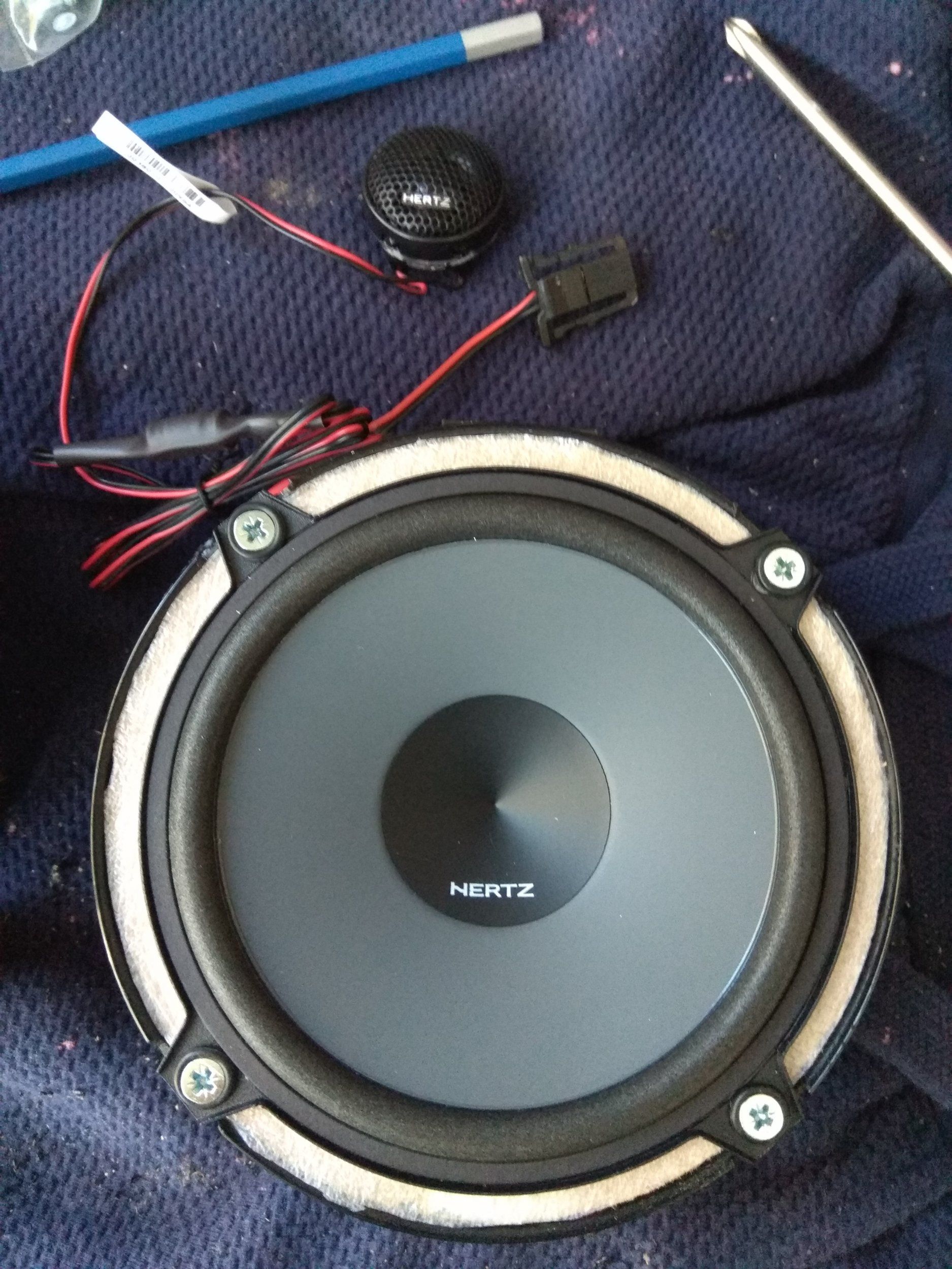

I hope you can help. I bought a set of Hertz Uno K165 speakers to replace the old set up. I did one door with an adapter to make two wires from four for the mid bass driver and connected the new tweeter using existing connector from old tweeter. I did a quick sound test and it kinda sounds tinny. I can see the tweeter has an online filter for high freqs and assume I can connect the mid bass directly with no crossover. Is there something I have missed here? Should I wire it different? Perhaps I need an amp? Any help or advice on what people have done.
Hi there. I did the same upgrade exactly with the same Hertz Uno K (but mine is 130). I must say the old OEM speakers (philips) are pretty good and with a good bass (keep them while they last) ;). Regarding connections, the Hertz tweeters have a crossover inside the cable on the "+" wire. Be aware not to cut the wire too short on connections or you will cut the crossover out. But yes, you can connect the radio audio wires directly to bass and tweeter terminals. In fact, the OEM setup is done on the Bass speaker where there is a plug with four wires (all in parallel): two wires for bass "+" and "-" and splits (inside the plug/speaker) on more two wires that go up the door for the tweeter "+" and "-".
I did used the SEAT OEM wires and solder everything so it would connect with the same OEM plugs.
I must say I also got disappointed with the power of the sound on low volume level with Hertz. The OEM speakers delivered much more loudness on low volume. And the tweeters have a kind of directional wavelenght, if you move your head 1 inche it makes a diference on listenning. But once you raise the volume up the Hertz became alive and deliver enough power and the clarity is much better with no distortion where OEM would struggle to keep decent.
I also got curious and tried with a borrowed amp (and DSP) and its night and day. But that's a much more expensive setup and for that I would upgrade to Focal speakers to match the overall upgrade.
Meanwhile the backdoors speakers also died and I just managed to install a Pioneer TS-G130c setup just for now and it's a joke! You can't almost hear the tweeters - I even thought they could have fell inside the door o_O.
It was my mistake going to 13cm where I could go to 16cm but maybe next time.
Hope you can achieve it.
Regards
