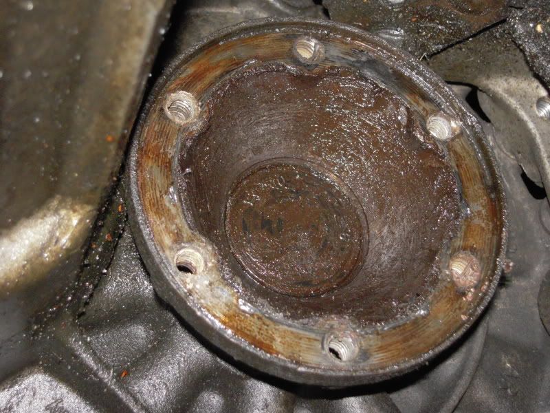

Last time this was here it didn't start, this time it doesn't drive a broken inner CV bring the issue, the clutch was also in a bad way slipping most of the time, so two birds and one stong.
Seems like the CV boot had split ages ago as there wasn't any CV grease :ph34r:

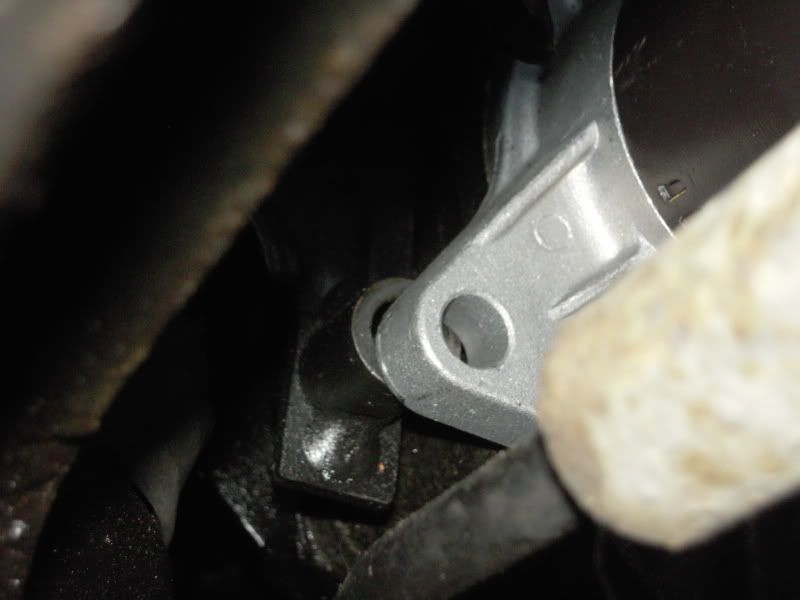

As I start'd to remove the gearbox I noiced the starter motor only had two bolts in place and that the 3nd one had not be fitted at so point which leads to this happening, if left like that the bracket will break off.
Will try to bend it back, if not you'll need the get one Chris.(same as mk2)

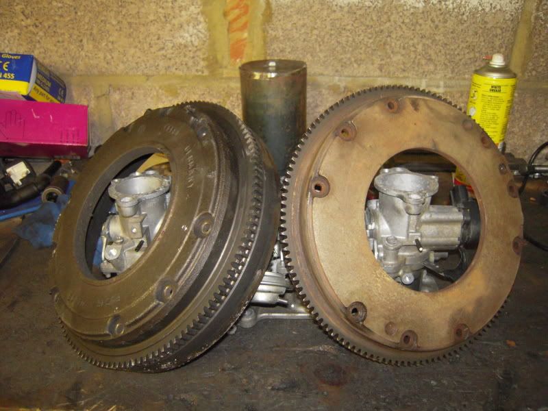

Here's the old flywheel next to the new one.
