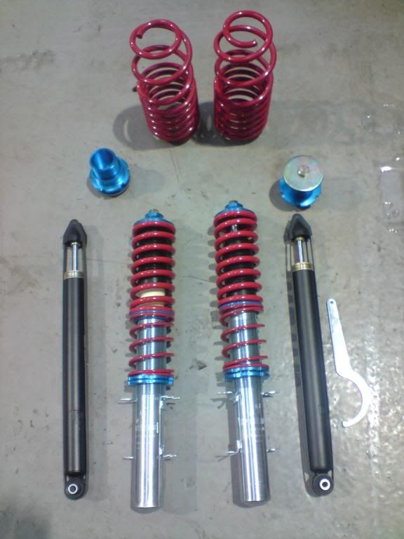

i got some 150 cheapy coilys off the bay
i know they arn't the bast quality but they have saved me some dolla and given me the right look for the next couple of years whilst i concentrate on other jobs (engine etc)

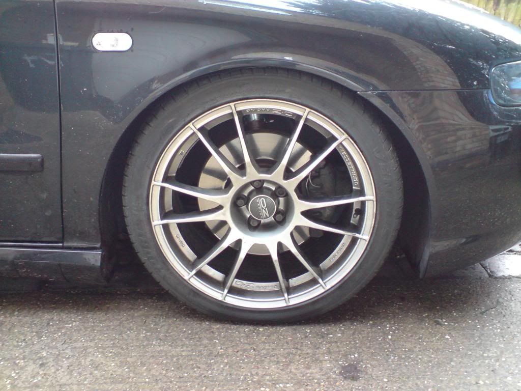

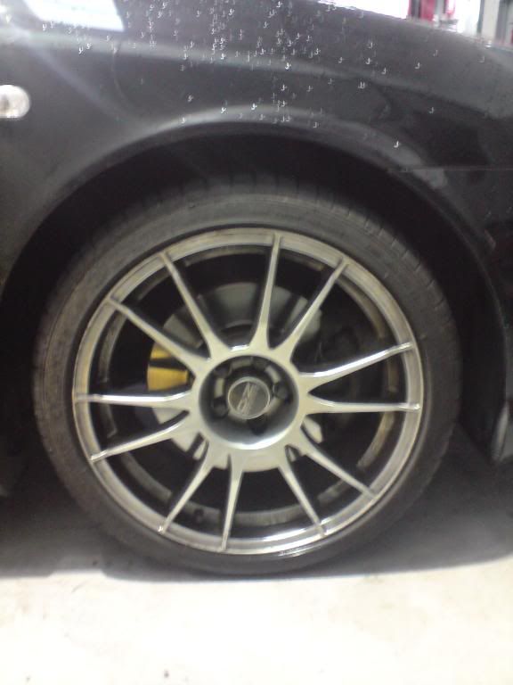

(before above and now below)
and i know it needs a wash btw lol.
depends on what your going for really, i dont think you can beat coily's though because you can taylor the ride height to your taste/comfort!
Good luck with your project!
how do you find them for ride comfort mate?
not to bad at all... expected them to be terrible!
only bought them as the car looked like a tractor on 18" rims and i've been spending my dolla on the engine at the moment. figured 150 was peanuts for height adjustables. if the comfort ever becomes a prob i can always pick up some new front springs for £50 off the net with what ever spring rate i fancy :)
i dont expect them to be much good at track days but my car is a little way off that yet. these will do untill i get some KW's maybe next year?
untill then i recomend these for bang for bucks!
i can lower it a silly amount more too which is always nice to know... as impracticle as that would be lol.
