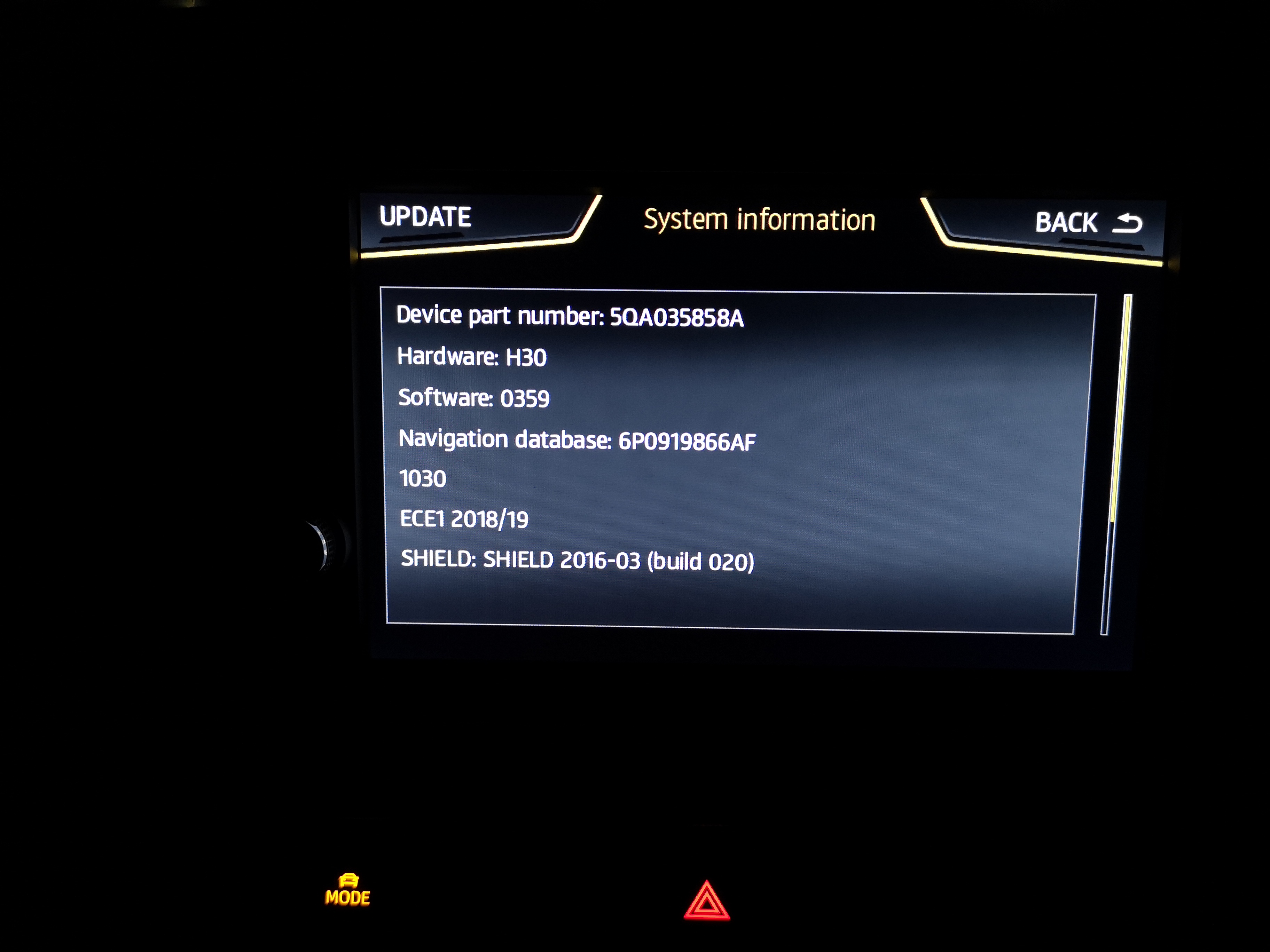

I'm not sure if this has already been answered but I have the software version as per the attachment, is there an update available yet for it?

Device part number 5QA035858
Hardware: H24
Software: 0241
Hardware: H24
Software: 0241
Been told 0346 is the latest firmware?
Struggling to find anything solid.
Just had full link activated.
Sent from my SM-G965F using Tapatalk
You're on a slightly older software version than me, but the same hardware version. You've got to do the upgrade to 0346 in two stages. The first from 0241 to 0330 and then 0330 to 0346. This will give you the tiles you want. I'm all ready to go with the update, but need to get an OBDeleven in case of issues with MirrorLink disappearing, etc.
