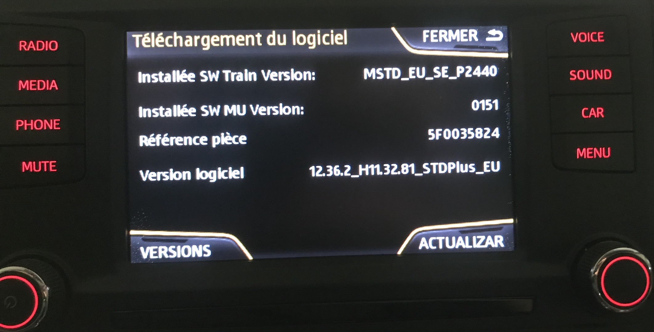

Has it gone to a blue screen that's says something like emergency download update?
What software was you on and updating To?
No blue screen, and no emergency download update. It just tries to download the software from the sd card I think.
The original version is 151, the downloaded file says version 480.

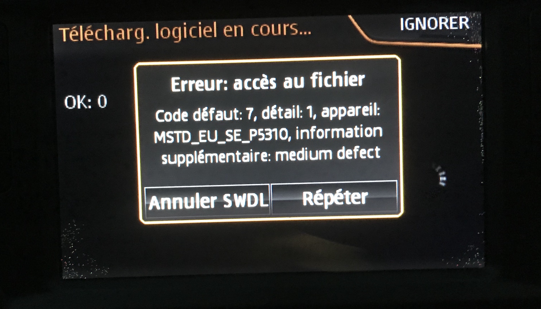

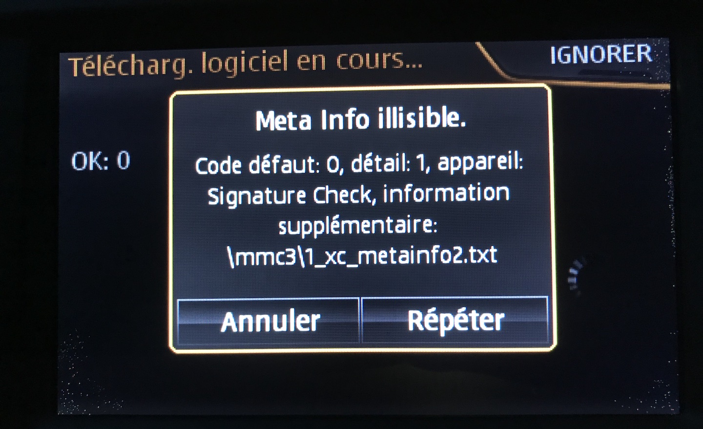

Here are pictures of the information, and the errors I have.

Did you use a class 10 SD card and did you format it to fat32. You'll probably need a free software to format it as windows can't format it to fat32

Could try downloading software again or finding another source in case it corrupted when downloading. Failing that find the 151 software and try reinstalling that

TwiterZX
Oct 10, 2018
I'm sure I saw somewhere that using MAC os sometimes causes problems with these kind of updates, I think mac adds some files to the SD card..
Try using a PC to do it.
Well, I tried with SD card 16GB FAT32 formatted from windows, and also with a USB 8GB FAT32 formatted from Windows.
Still looping, downloading software, failing, then rebooting alone.
The cancel button on top right does not work.
Does any one knows at least how to stop the update? I just want it to get back to its original version.

Only thing I can suggest is to find another link for your download or down load a previous firmware and try that.

I think if you enable the Developer Menu and use the SWDL option you can reload the software but I don't know any more than that, I'm sorry.
