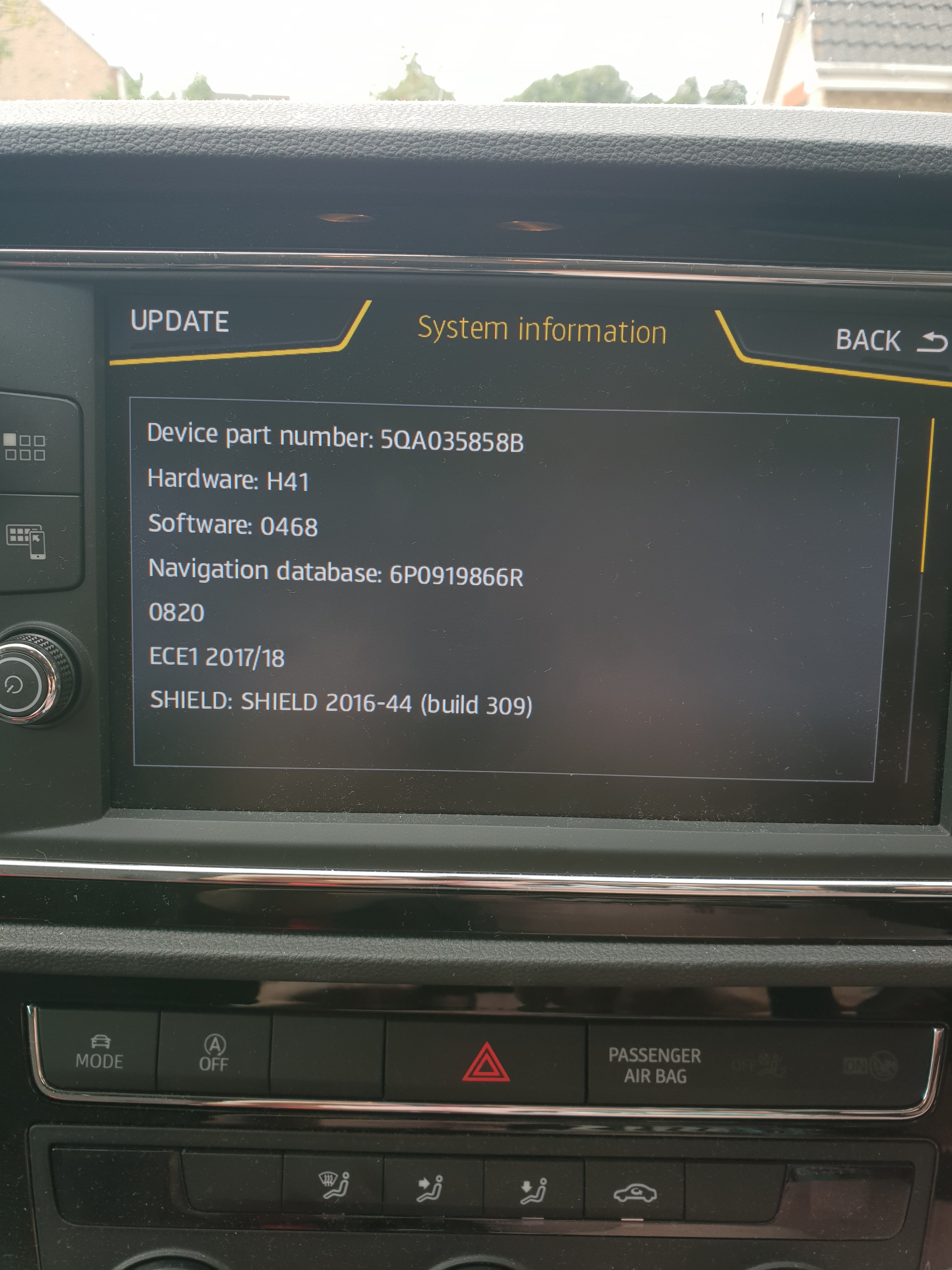

This is what I have following a long press on the menu button-
Hardware 5QA035858
Software MU 0241
Software version H25.14.33_STD2NAV_EU
Couldn't see a hardware version (e.g H24), where do I find that?

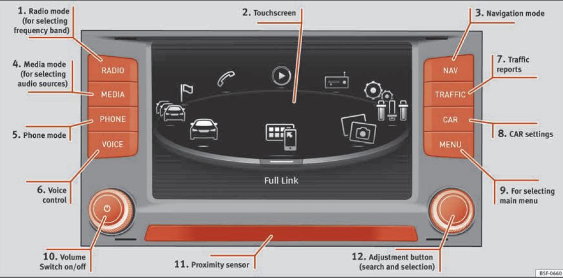

What year and model is your car?
2015 (65 plate) Seat Leon ST, it's a Media plus system
Sent from my STF-L09 using Tapatalk
If your screen is like this
but not showing this view press the MENU button once to show a view similar to this then turn the 'Adjustment' button (12) until the 'Settings' function is shown and select it, this should give various options of which one should be 'system information'.

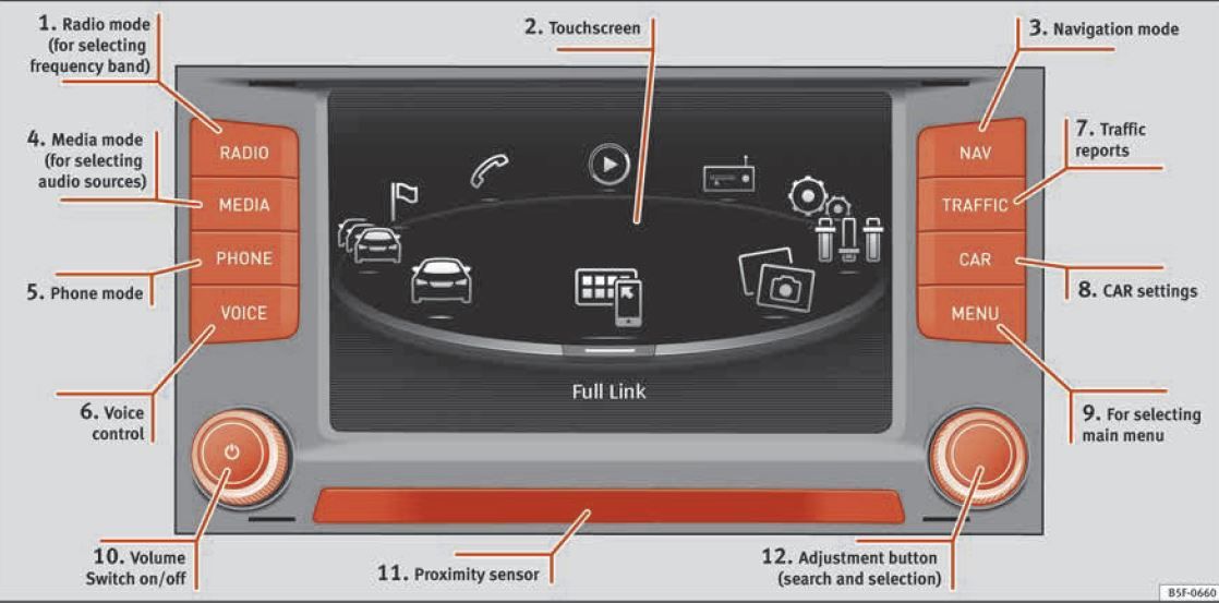

Thanks found it now, couldn't see it for looking!
So my details are:-
Device part no. 5QA035858
Hardware: H24
Software: 0241
Am I right in thinking I've a mib2 and can update using the Spanish site as per posts earlier on in this thread?
