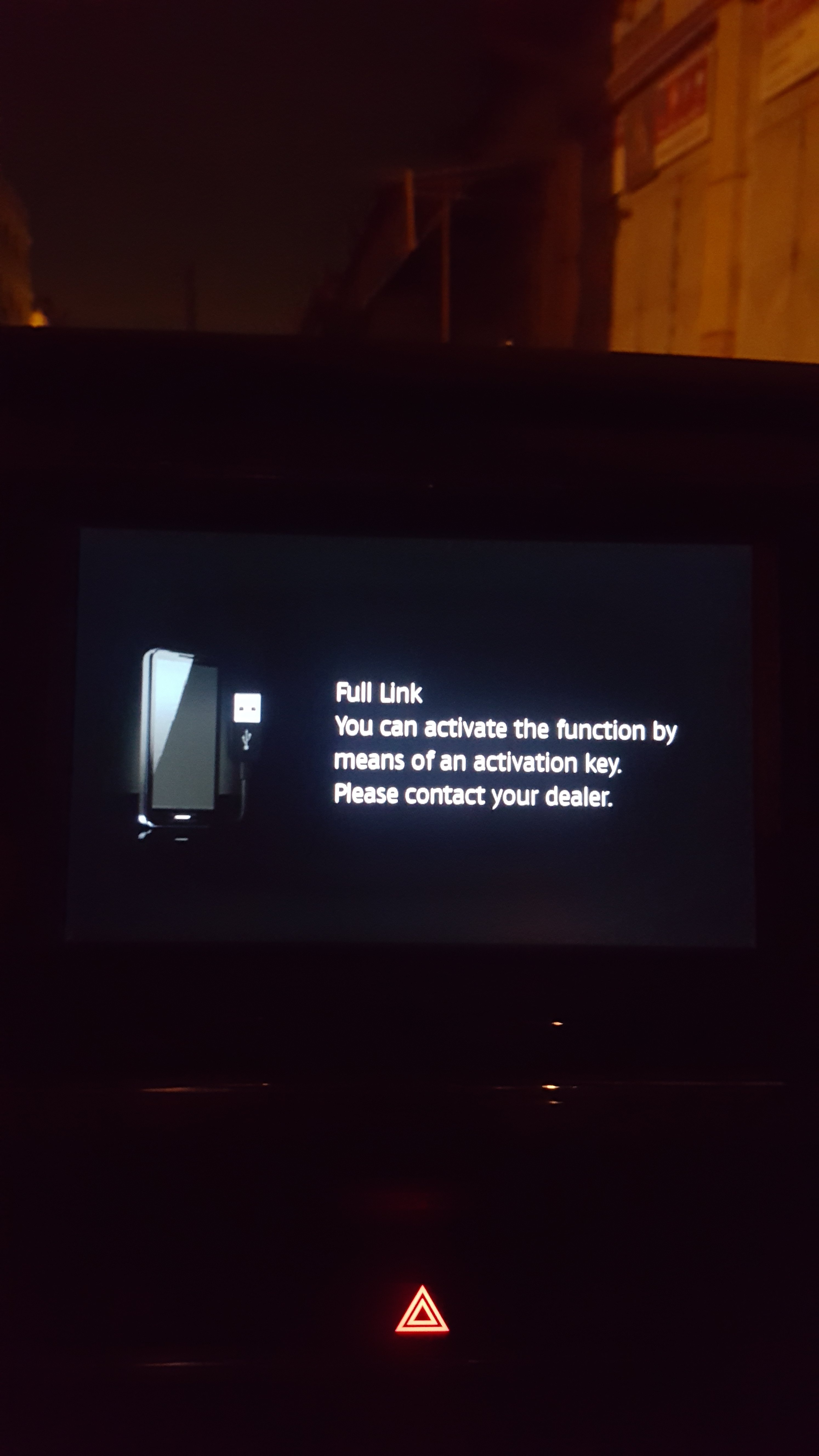

Hey guys i get this message when i get into the full link. WHAT DO I DO !!!?
PLEASE ANY HELP !!!

I gave up trying to fully update the mib2 high maps as Walone knows after 17 months of trying. The developers menu via SWDL without Mapcare allows you to update voice, eggnog etc but not the Navdb directory which is the map file directory and released POIs........... I tried.
Mib2 High uses the same map upload as Mib1 High so it's been well researched since Mib1 High was released. Going retrofit with your unit is the only way... threw the towel in and followed Walones route of getting you unit turned into a retrofit so you can enjoy all the benefits of a retrofit :).
