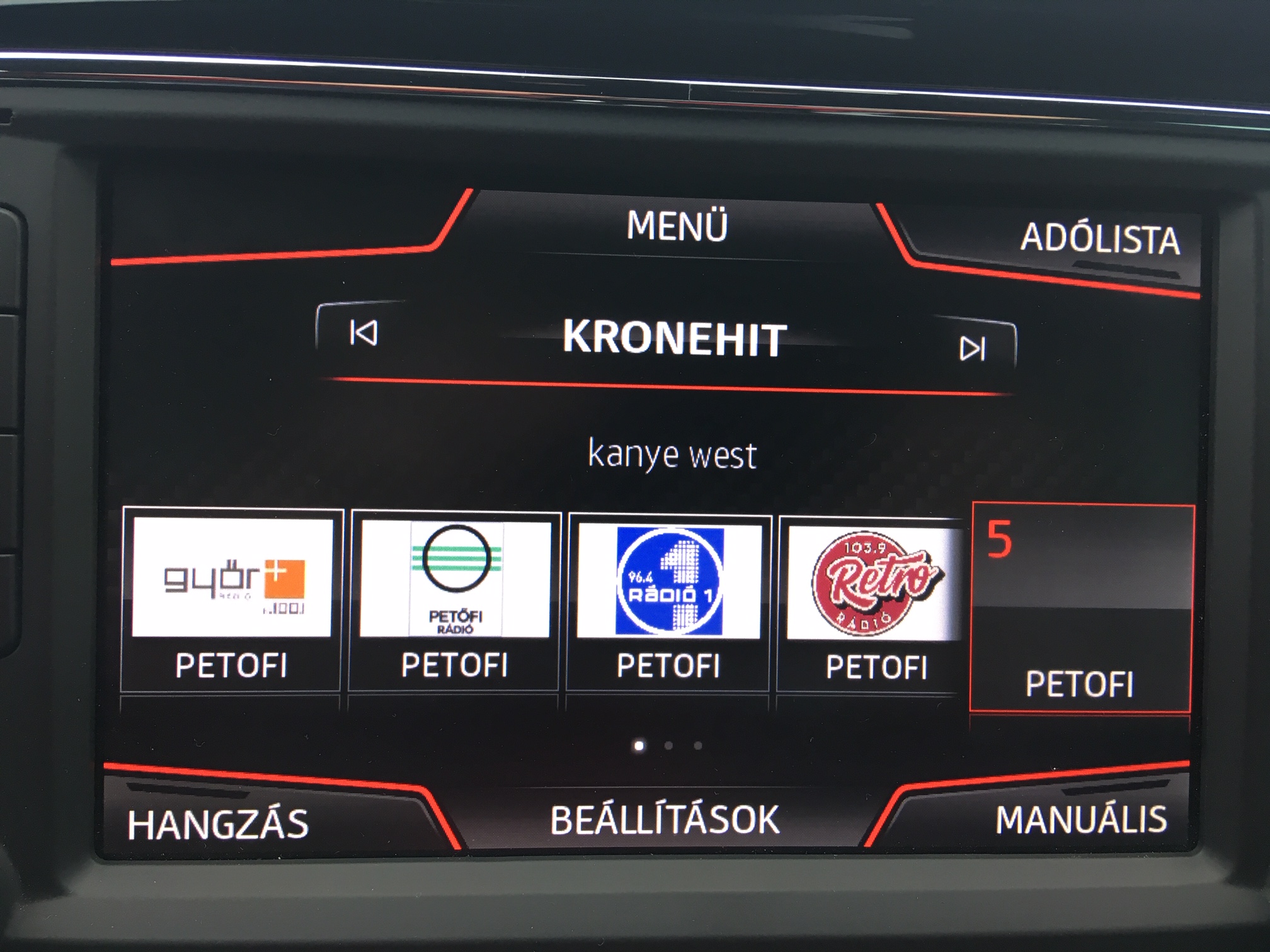

I have updated, to 330, and than to 346. Was no error during the update (from SD card), but now my radio and Sport display bugs a bit... :(
-The sport display reset itself on every startup... (the gauges are always the factory settings)
-The radio station names renames itselfes, all the stations has the same name! The logos are all right, but the names... :( See the picture
I heard these thing from others to, but our dealers has no idea...
Can it re-update with the same SW version?

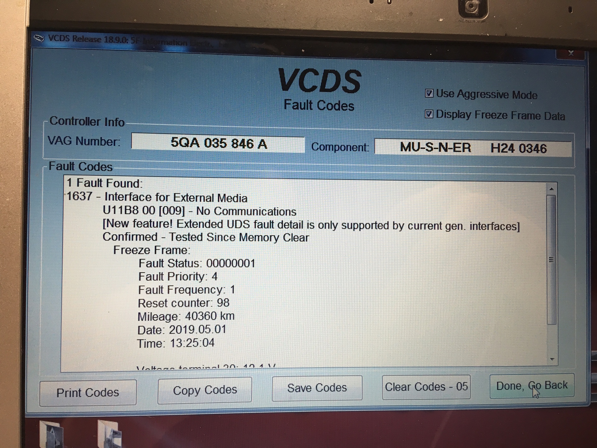

So, maybe I found something... in 5F Control blok comes this error up: (see Pic) If I erase it, it will be clear, but it comes back at the next start up... I don't know where it comes from...
