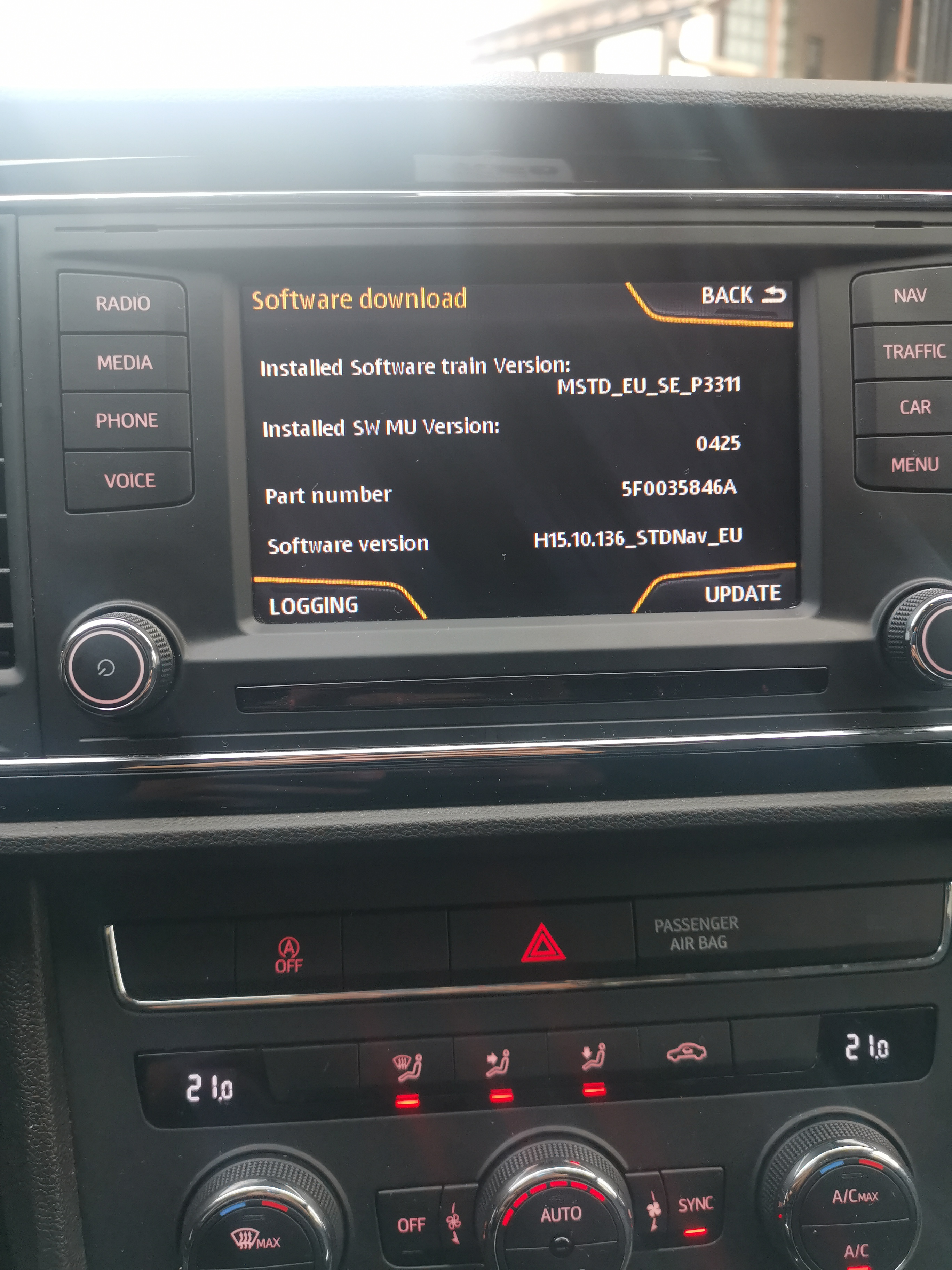

Hello,
can anyone please help me, I just bought a Seat Leon 1.6 2015 i a just want to know if there are some new updates for my radio currently i have this one:
