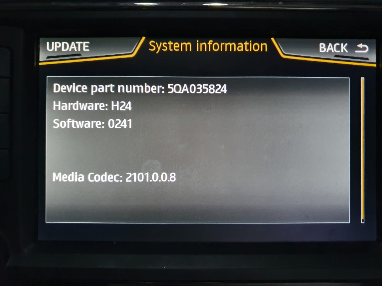

Hi all I have
5QA035858A
Hardware H30
Software 0351
Media codec is 3101 0 0 8
This morning when I started the car the USB port by the gear selector no longer does anything, telephone button produces an error saying "telephone currently unavailable" and Nav button produces an error saying "function not supported" even though I've never touched the SD card with the map data on it. Is there a software update or reset I can do to fix this? I've tried the long press on the power button and factory settings in the menu but had no success.

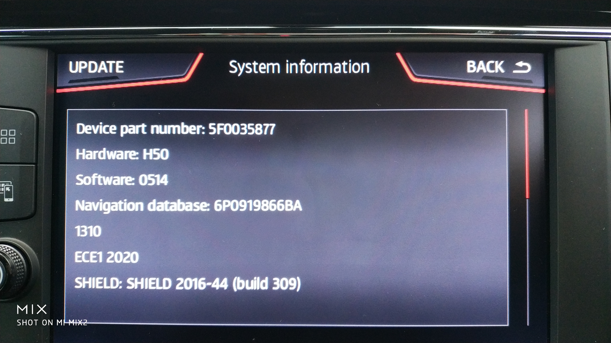

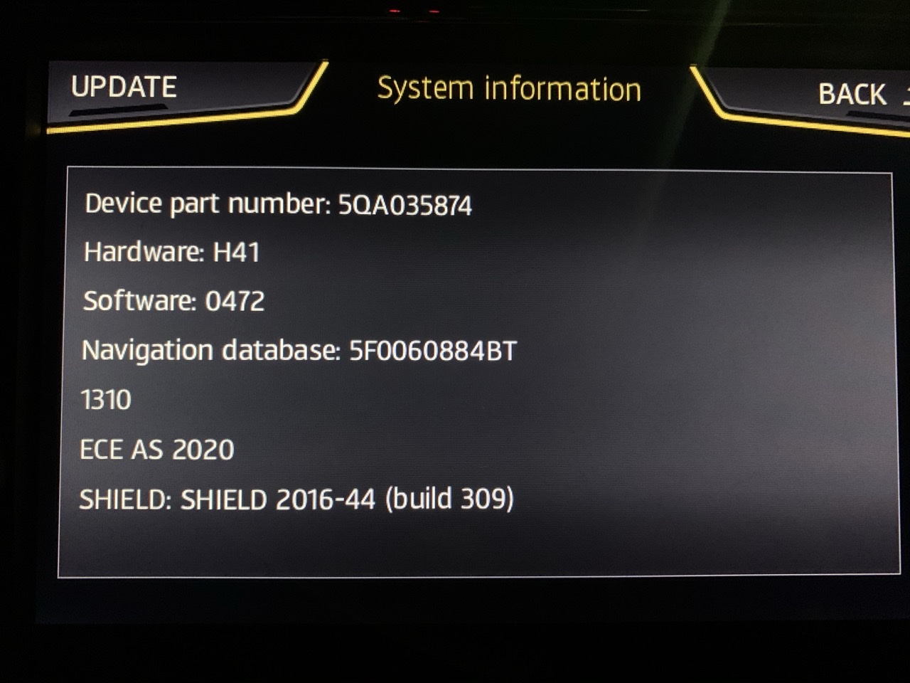

Okay finally got around to getting firmware info etc....
What are the MY2019 cars running?

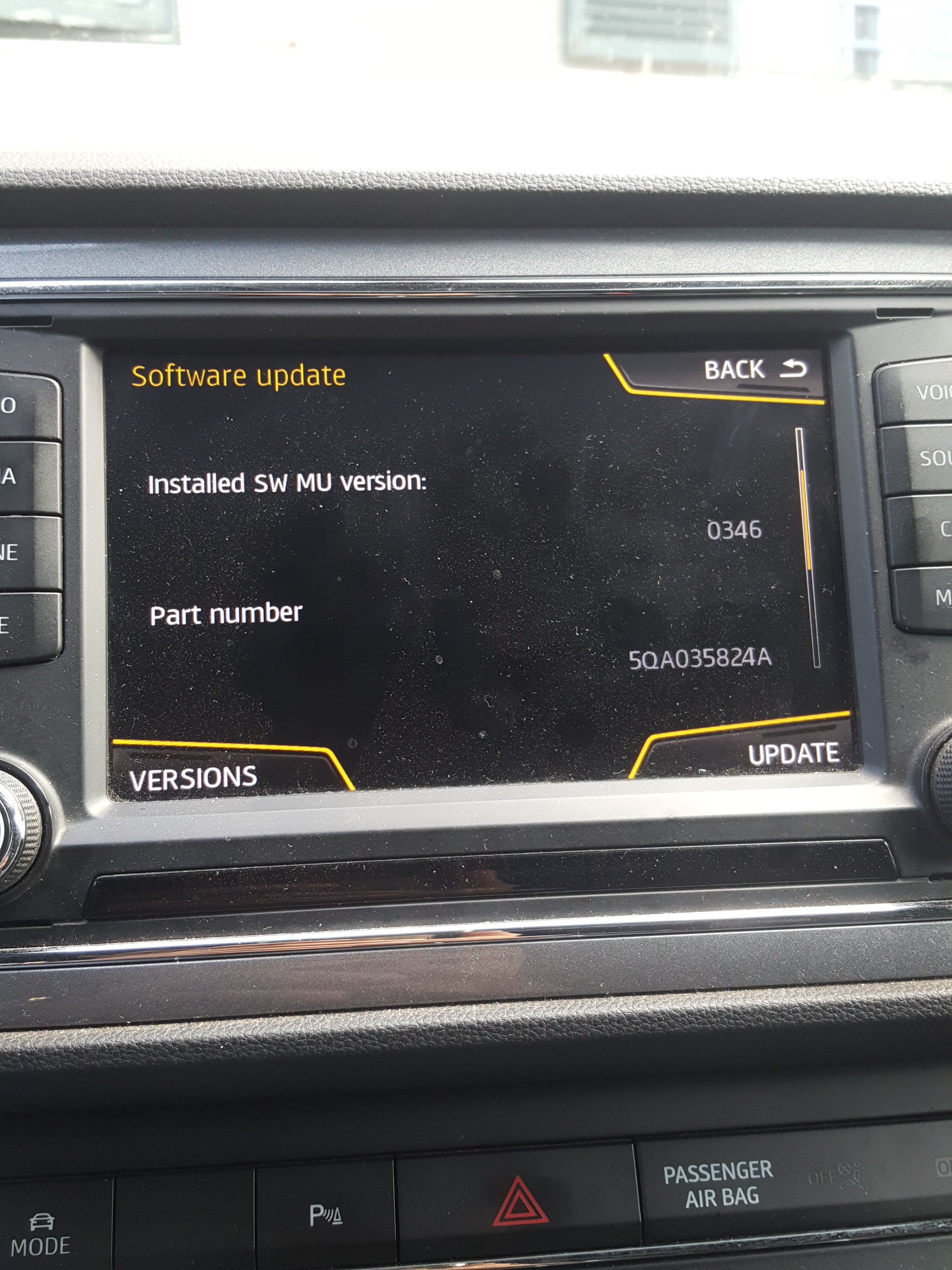

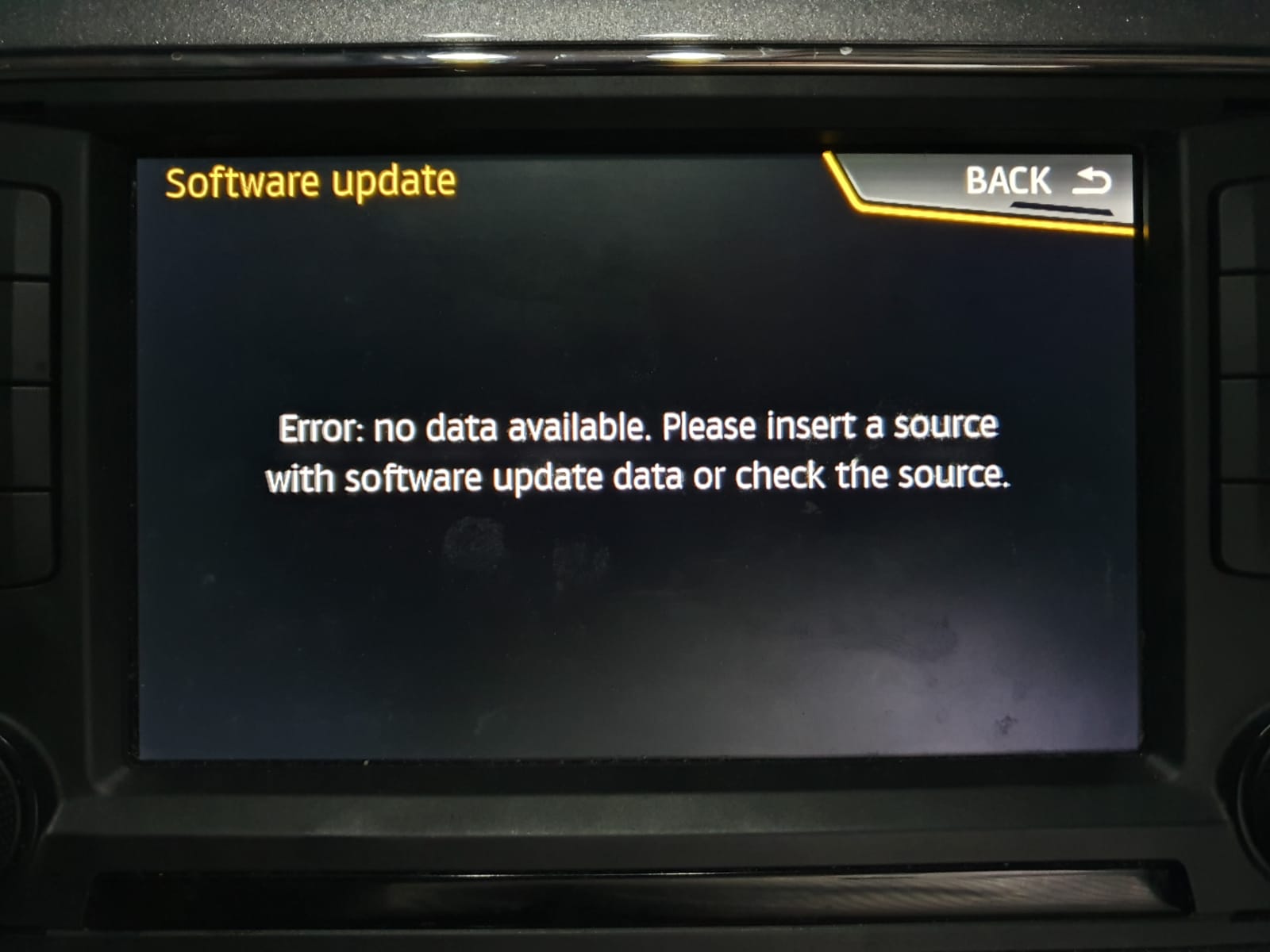

Hi there, I have Seat Leon late 2015 with Media high 6.5 (no nav) device number 5QA035824.
I have tried updating my system with 330 and 346 but neither work with SD or USB. I get error "Error: no data available" pic attached. Are these updates compatable with my unit or do I need to update to 0245 first. I havn't been able to locate update 0245. Anyone post a link for me to try?
Thanks
