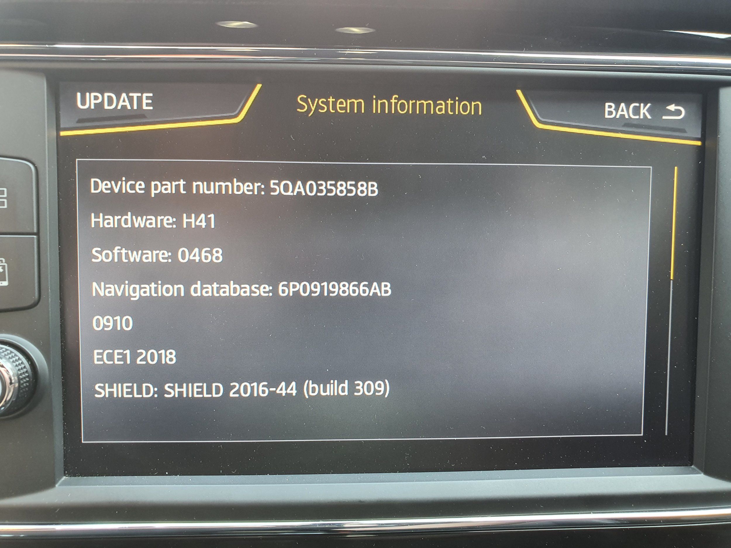

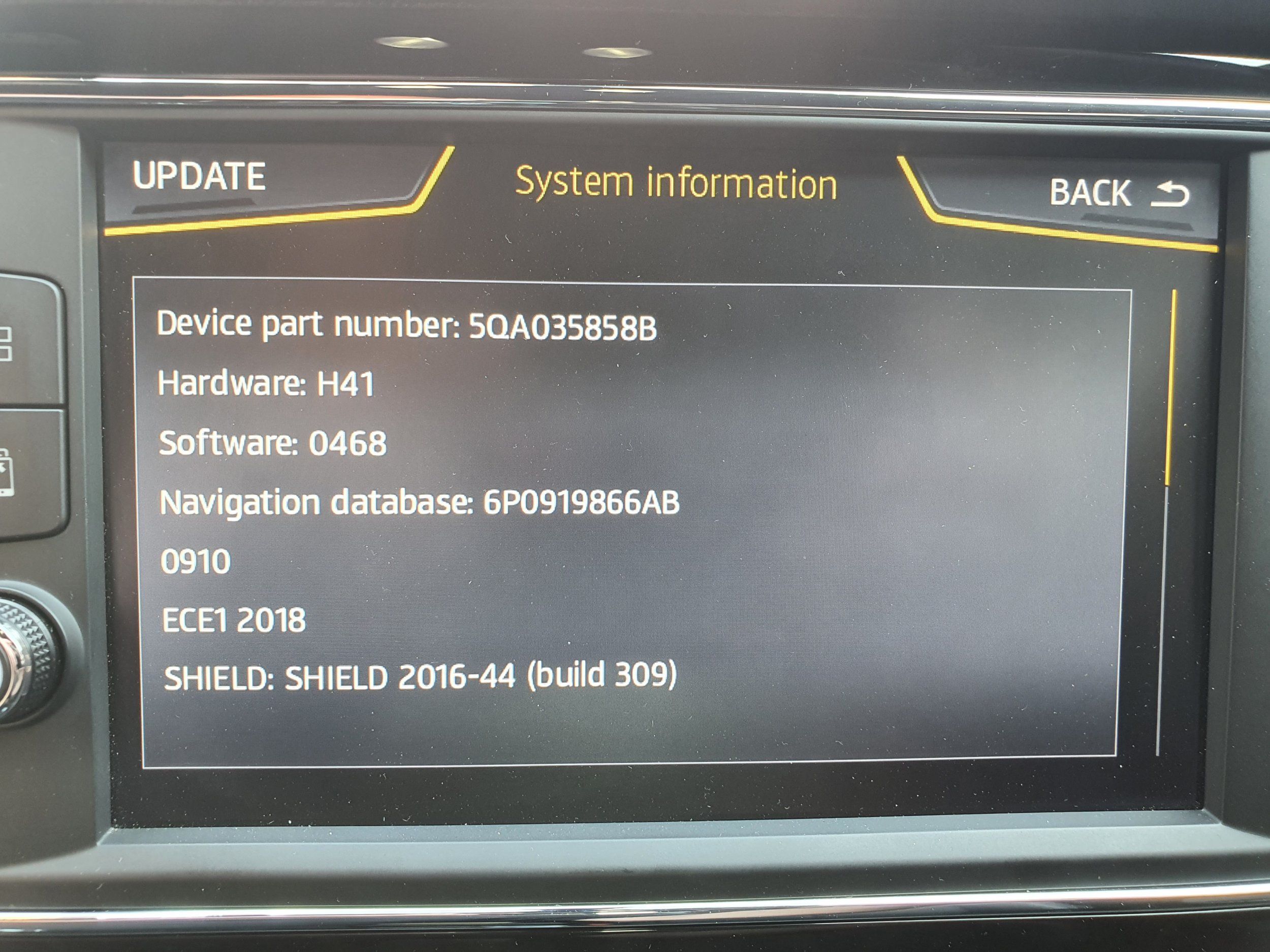

I've only had my cupra 300 for a week now so still reading up on the media system. Apparently I have the media system plus / Navigation system plus with full link and I've read this was capable of playing DVDs and other video files? Anyway, could someone let me know which system I have and whether I can / should update it ?
That's standard MIB2 unit, you can update the maps on the SD card but you need to follow a specific method as outlined in one of the posts on this forum, if you don't you will lose your maps.
Thanks, i don't use the built in nav so i guess i'll leave it
